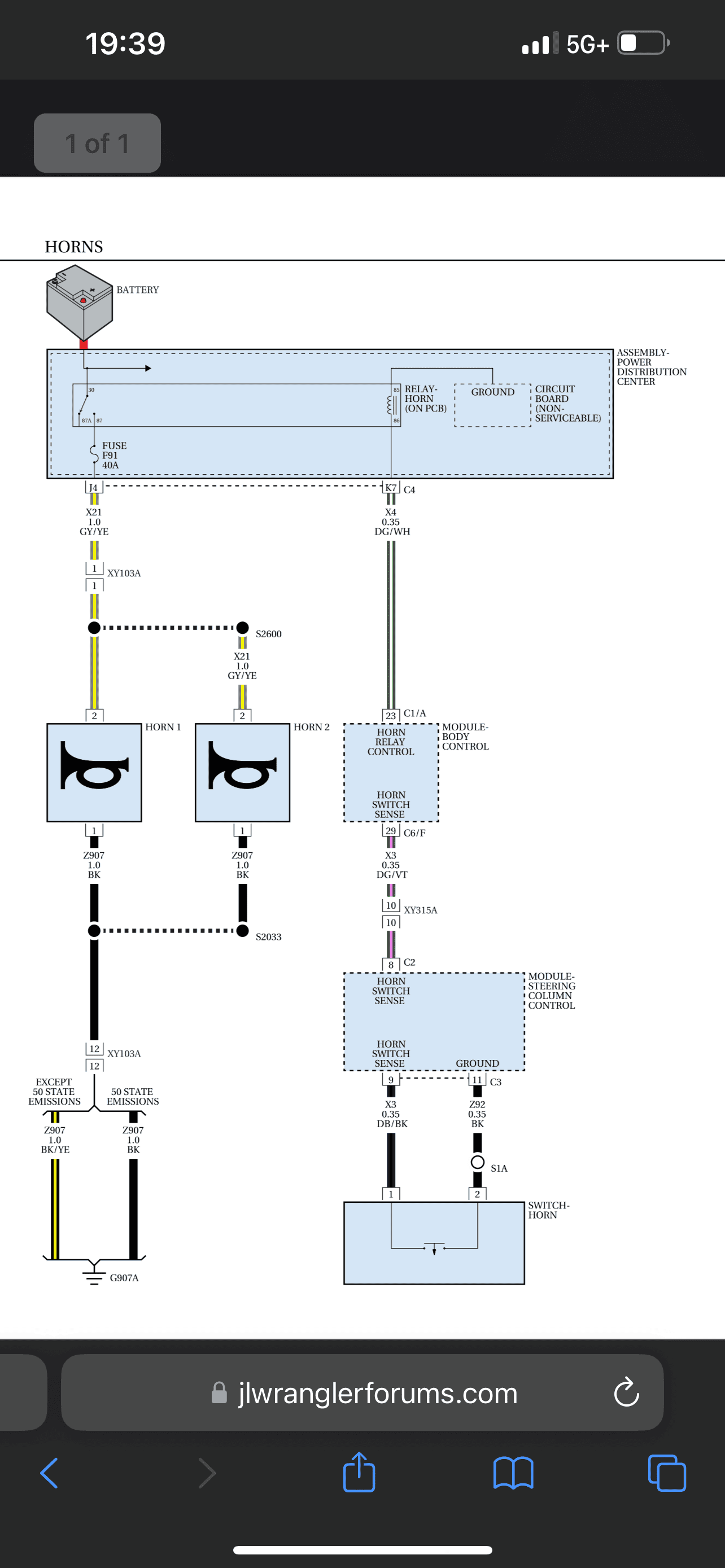

Buuuut… this being said. There’s actually two different horns now that I’m looking in my engine compartment.

Definitely per that diagram they work together. Check with @mwilk012 he can probably give you more insight as to the schematics/wiring diagram.
They share common power and ground both, always going at the same time unless one goes bad or a wire gets chewed up.
