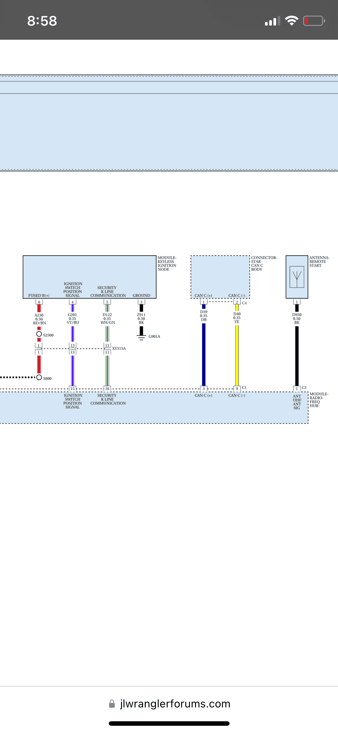

There are a lot of relays that click when attempting to start, including the auxiliary PCR which is a pretty big one. What’s weird is that the wiring flow path is exactly the same for a remote start and a normal start, both are signals sent to the radio frequency hub.
You’re going to need a scan tool or to just take a bunch of guesses at this point.
