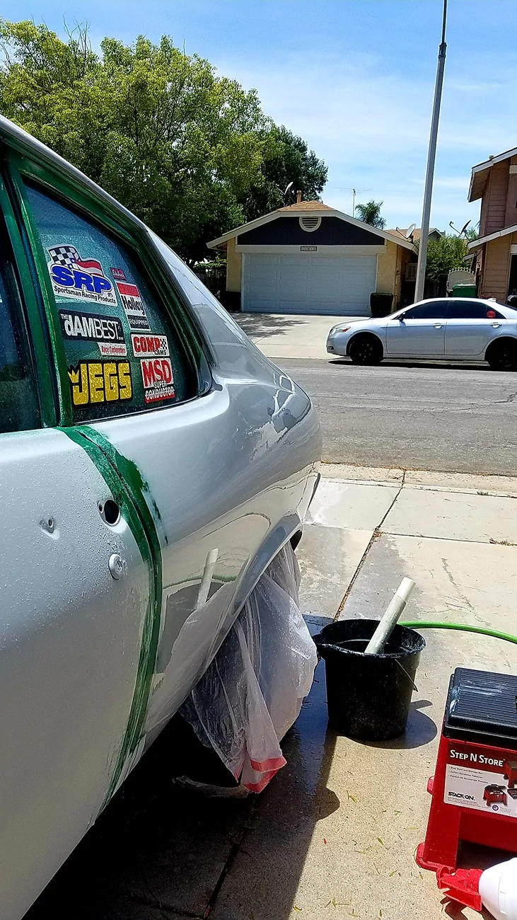

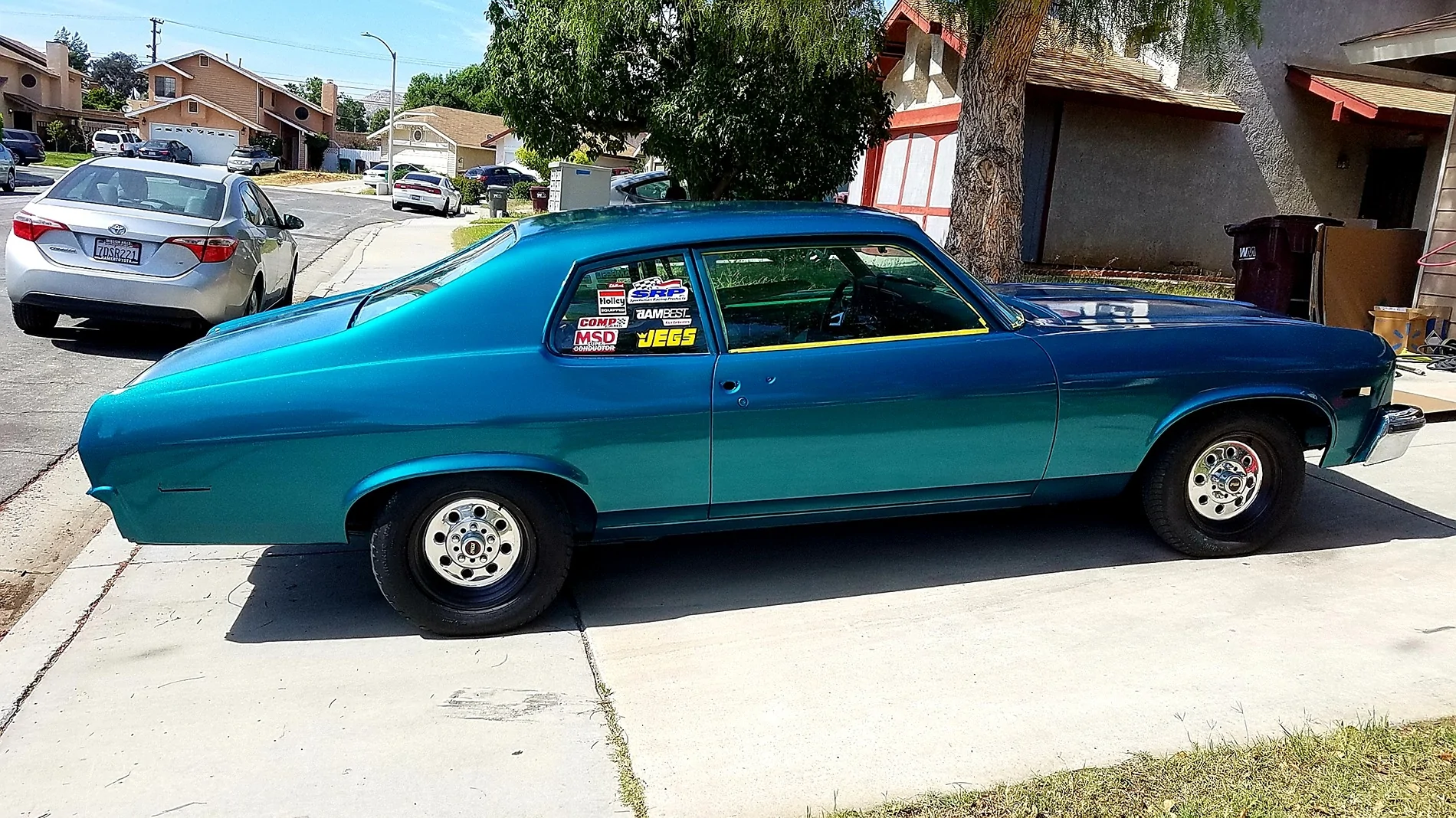

I am not a professional painter but have painted my Chevy Nova 3 times in the last 24 years. I have also painted parts on my Harley.
When I got the Nova, it had the same rust you described. I repaired the cancer by sanding down to metal and using fiberglass reinforced body filler. It has never bubbled up.
You have options all dependant on skill, time available and money. Here are two.
1) Easiest but most expensive: Take it to a reputable shop and have them do the repair or replace/paint the frame.
2) Cheapest, most time and skill involved: Do it yourself. Have glass removed or remove glass, sand down to metal, treat metal with rust inhibitor, use body filler, primer, sealer, paint and clear coat. Will take skill and time. Dry times, sanding, paint curing depending on hardener used, etc.
The quarter panel on pic 1 had rust, picture 2 is after paint, before wet sanding and polishing.
I hope this helps
