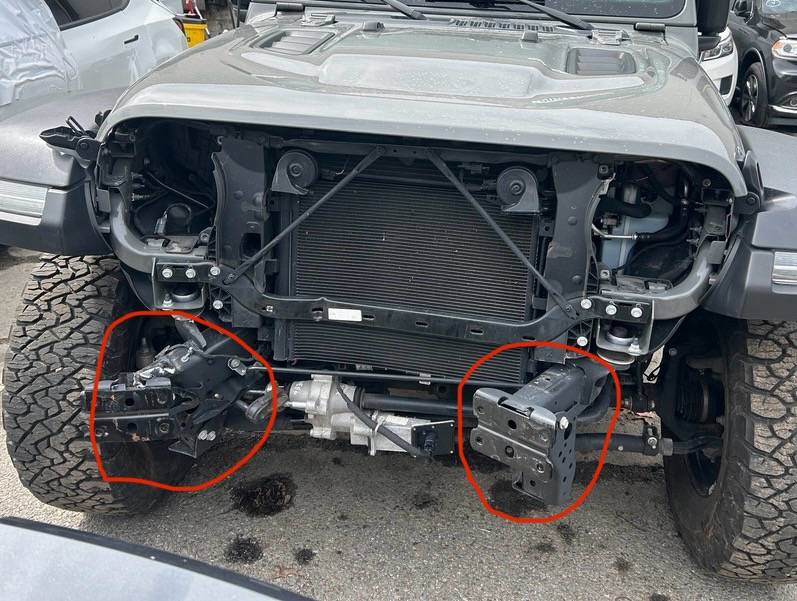

Hello everyone, I have problem with these front extensions too, can please advice if I have the right part numbers?
68638760AB
68638761AB
Jeep Wrangler JL JL Frame Replacement Process & Pics IMG_2297
Also, these are just extensions, as I see there are some steel parts down of these extension, do they come with extension or they are another parts?

Those are the correct part numbers. you cut the old rail off, grind out the remaining weld and install the new rail end and weld
