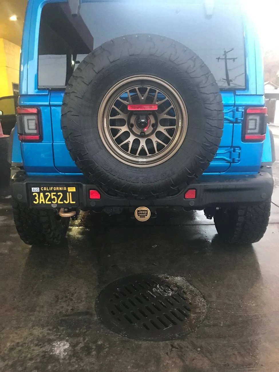

Titan 7 T-AK2, true forged- 21 lbs. But I can’t recommend them yet, ordered January of 24, back order, received July, still waiting for the center caps. Mfg changes moving production back here blamed, US made great, if I ever get the caps. Combo weight with the 59 lb Toyo AT3 80 lbs. stock wheels and 285/70 KO2’s 82 lbs. Weight weenie that hates unsprung weight approved, also no gate reinforcement needed.
