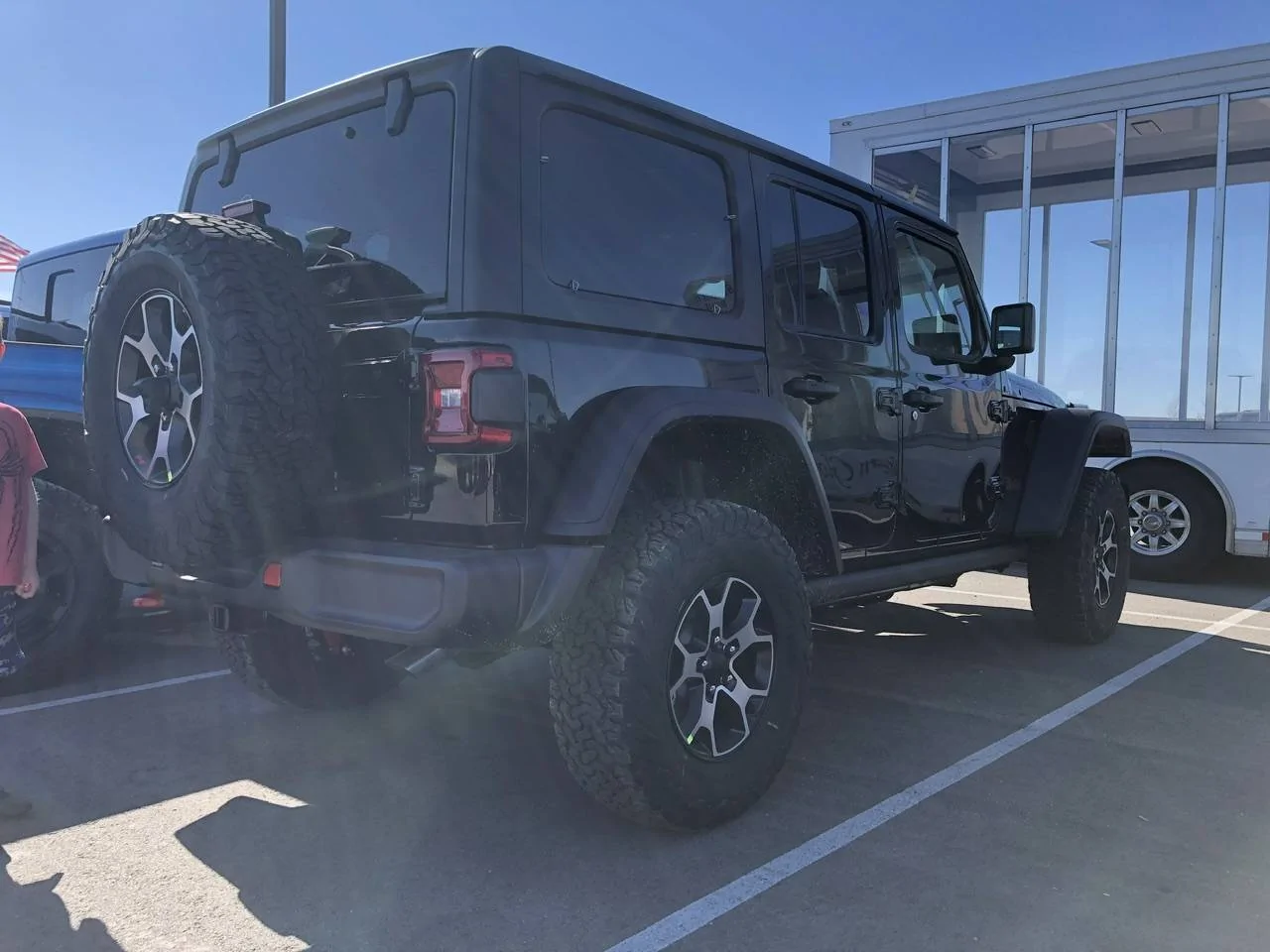

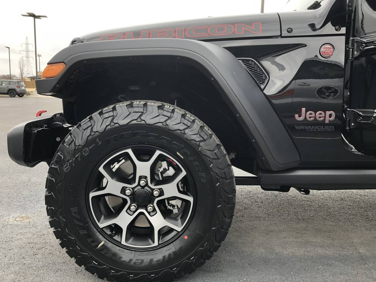

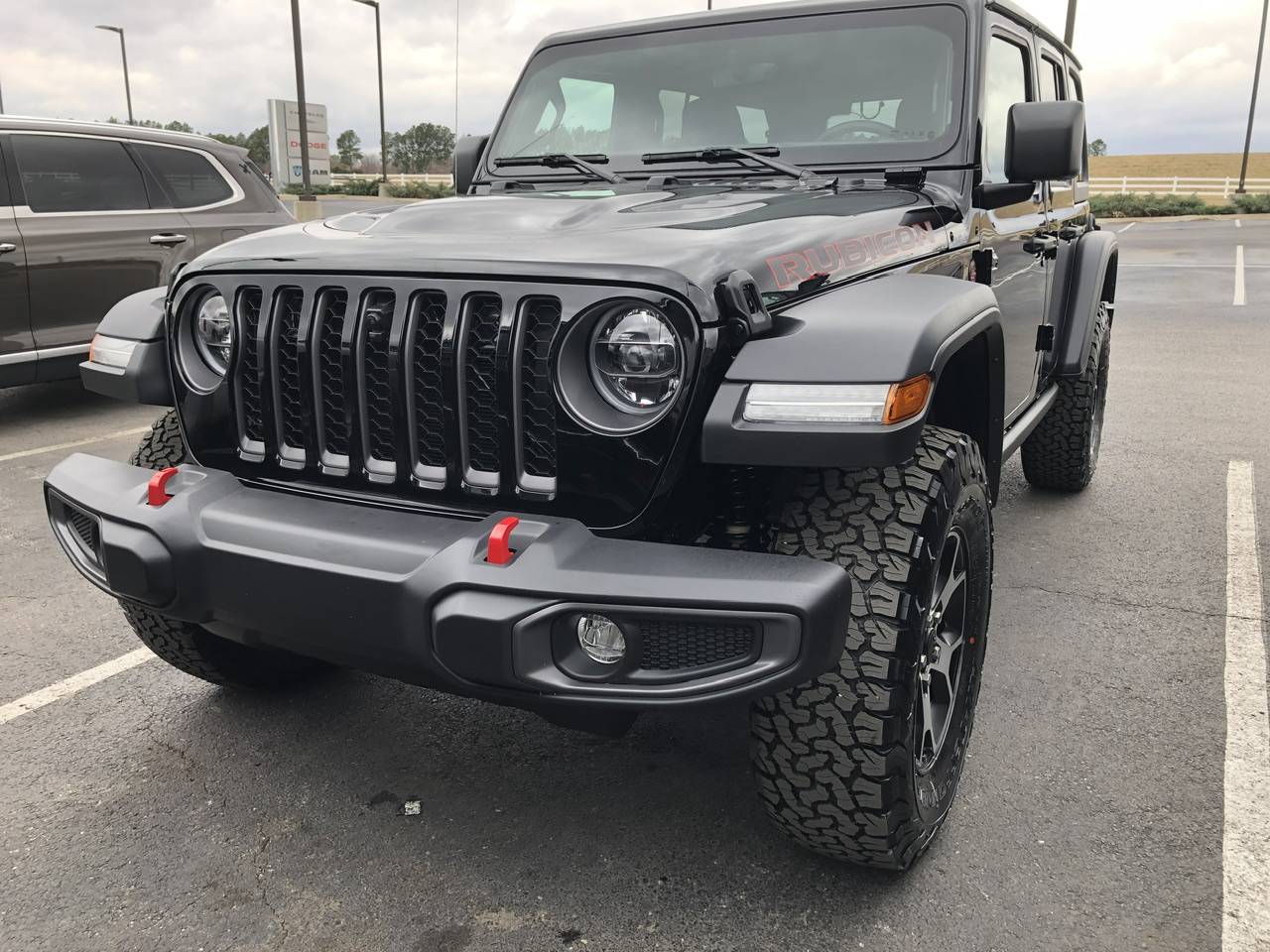

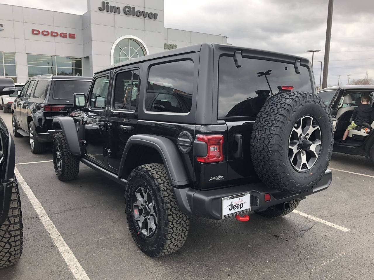

Back in late ‘21, when used car prices were INSANE, my wife gave the okay to sell my ‘15 Ram Big Horn to Carmax for $30k. I couldn’t believe the offer; I only gave $35k for it new a few years prior. I ordered my JLUR at 6% under discount, but after being stuck in JB purgatory for weeks, and then having sit in the back lot for several more weeks waiting to be shipped, I snapped and found one in transit to a local dealer and immediately threw down a deposit. Here it is fresh off the truck.
Jeep Wrangler JL Dark Helmet- ‘22 JLUR build thread IMG_4926
The day I picked it up.

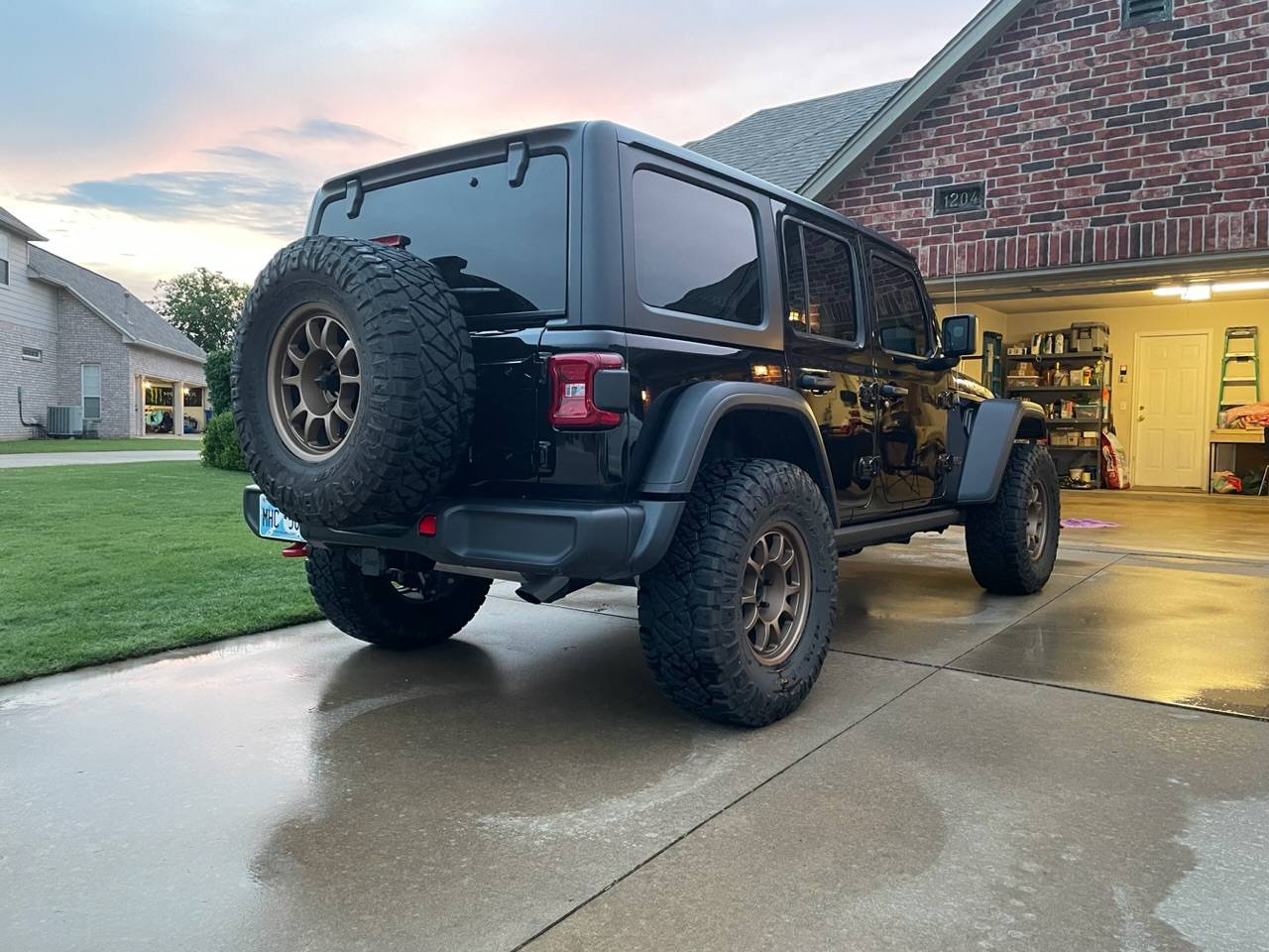

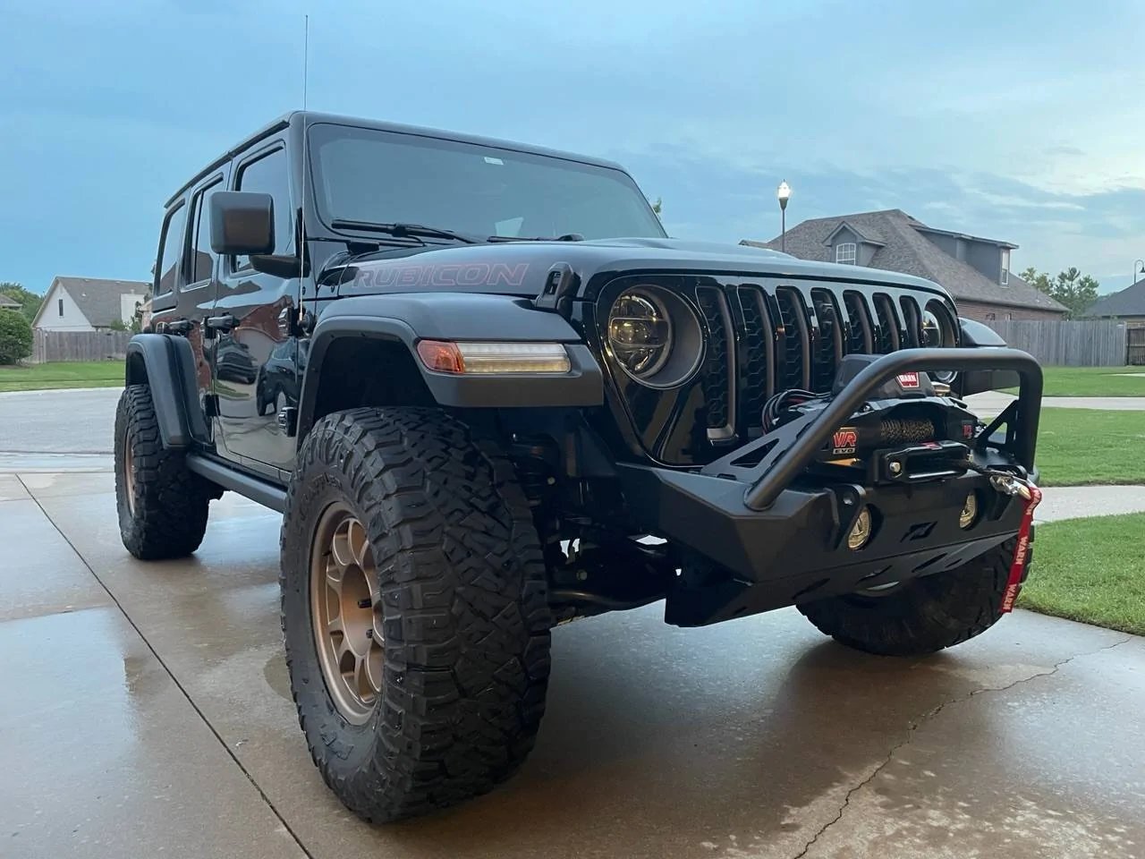

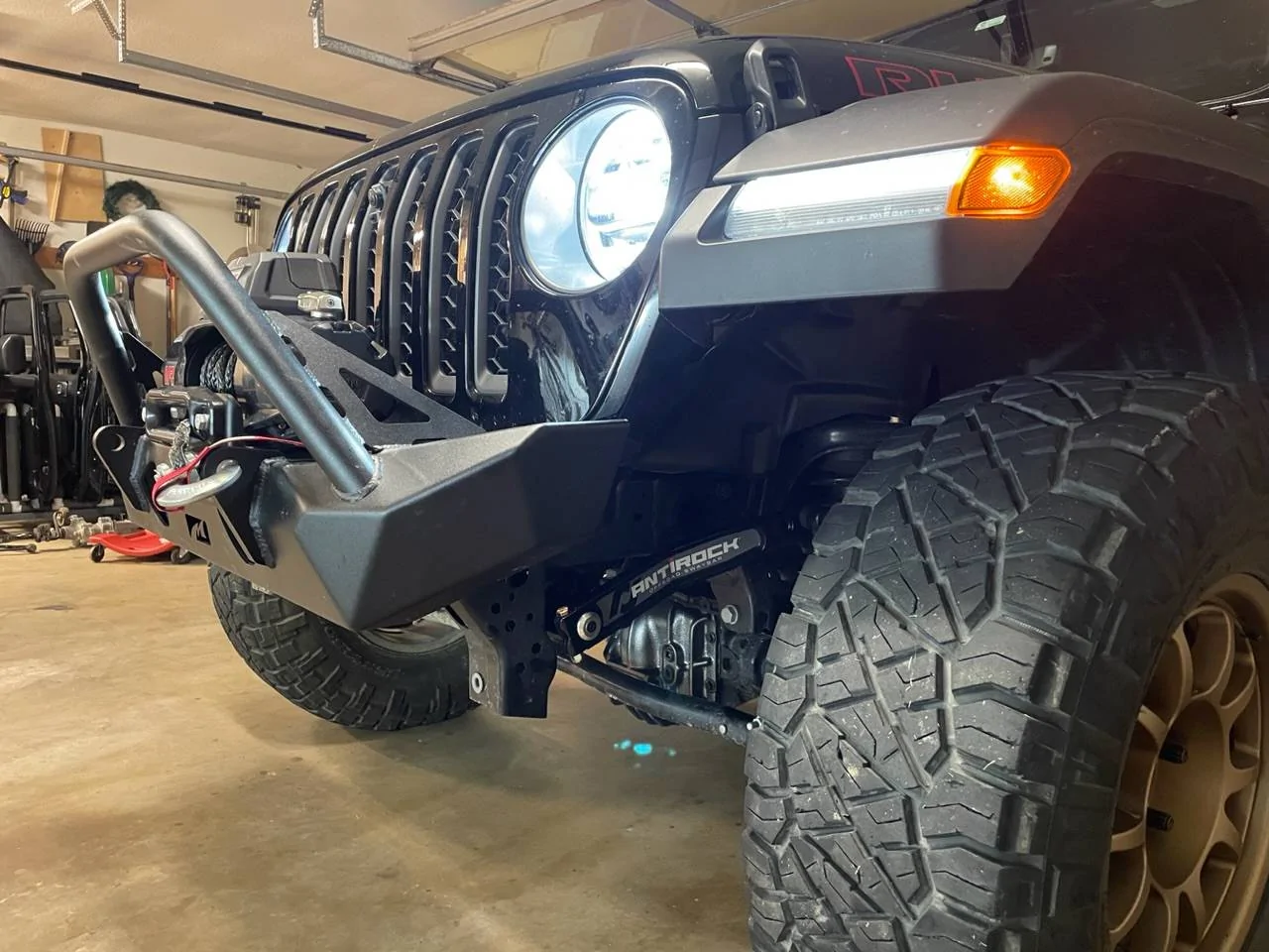

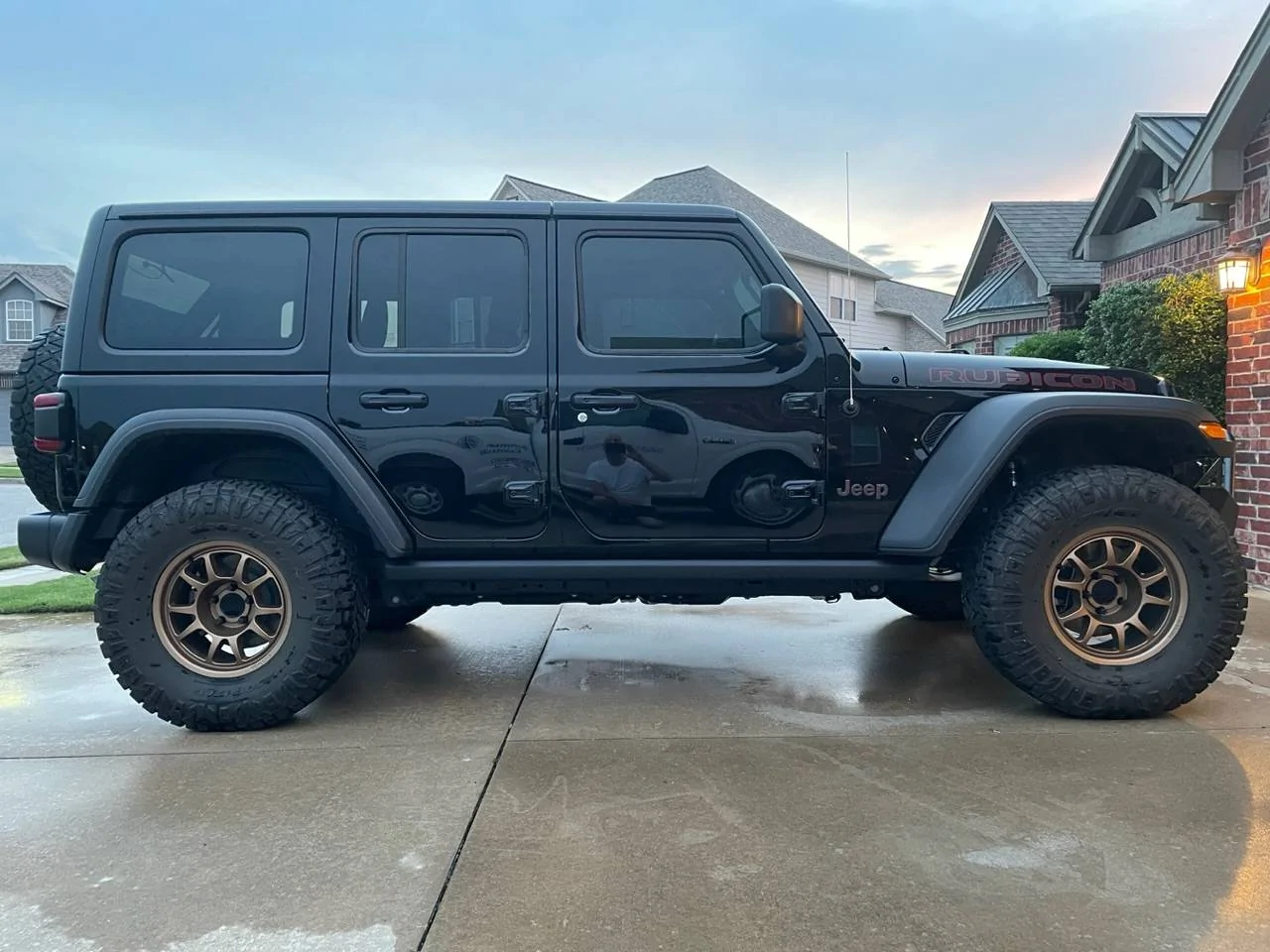

Wasn’t long before I found a great deal on a set of Method 702s with 35” Ridge Grapplers. I threw on a set of Teraflex 1” front coil spacers, Teraflex 2” bump stops front and rear, and Fox 2.0 IFP shocks. Oh and by that point I had also added a Motobilt front bumper and Warn EVO 10k winch.
Jeep Wrangler JL Dark Helmet- ‘22 JLUR build thread IMG_6194
Jeep Wrangler JL Dark Helmet- ‘22 JLUR build thread IMG_6193
Jeep Wrangler JL Dark Helmet- ‘22 JLUR build thread IMG_6192

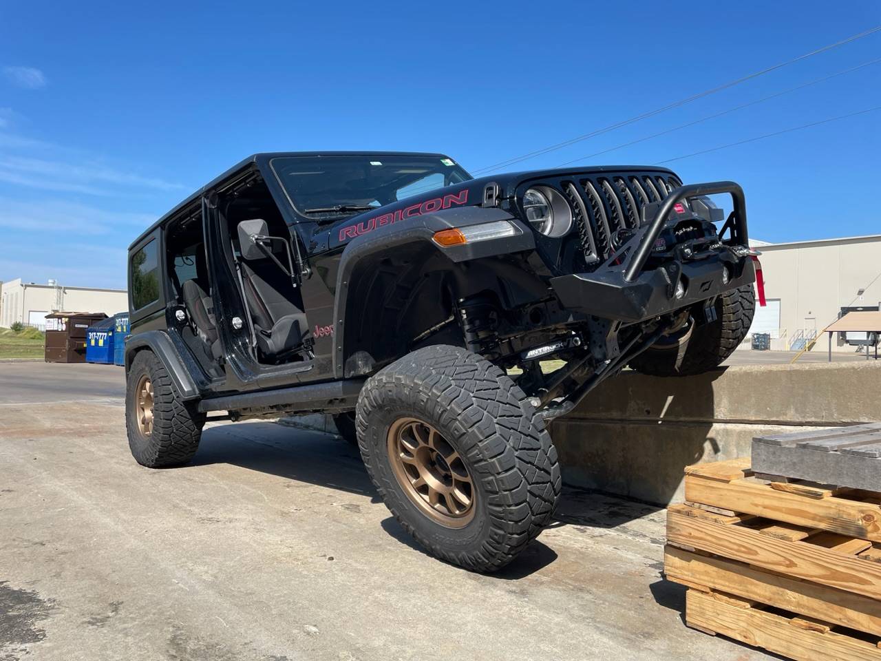

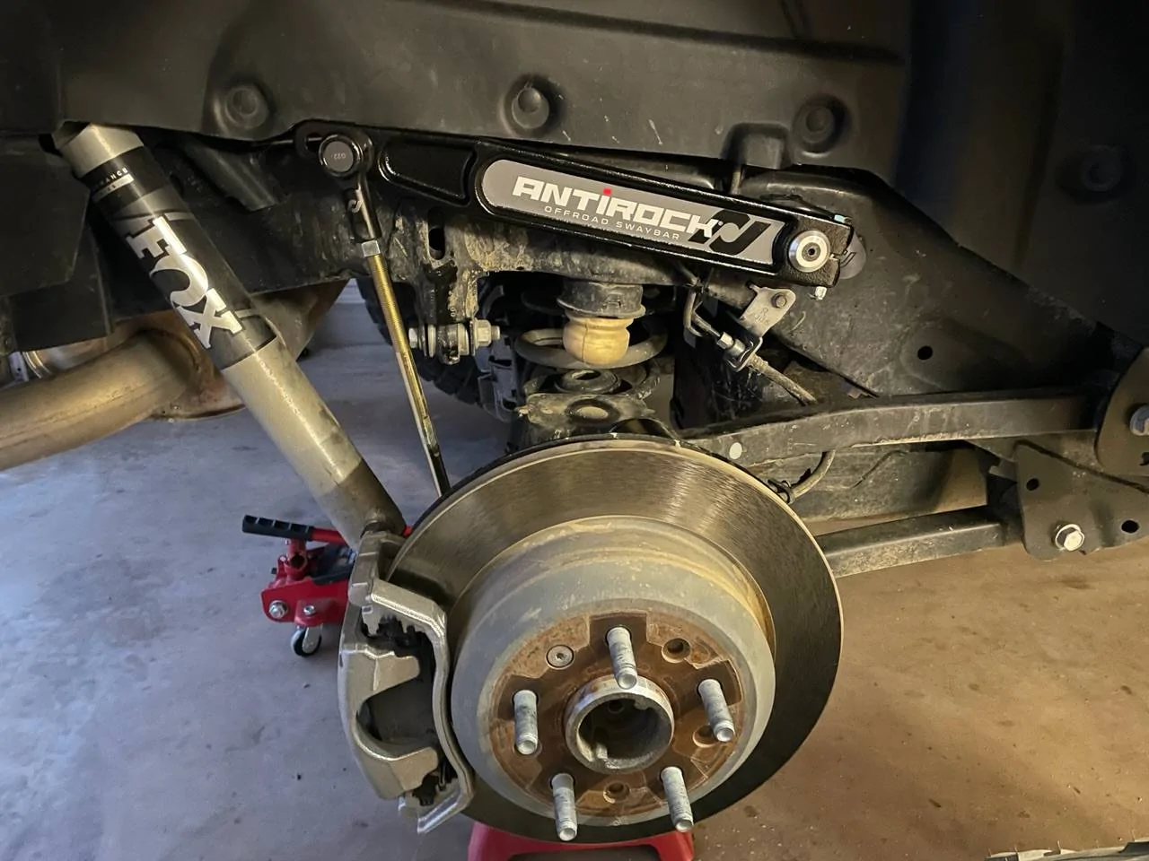

After dragging myself across several ledges, I decided I should probably beef up my diff covers, so I added Dana Advantek front/rear. I also added front / rear RockJock AntiRocks.
Jeep Wrangler JL Dark Helmet- ‘22 JLUR build thread IMG_6564
Jeep Wrangler JL Dark Helmet- ‘22 JLUR build thread IMG_6587
Stock flex, baby! ?

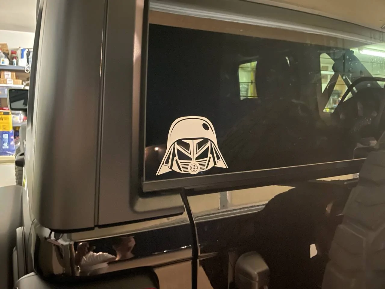

So now we are all caught up. Wait not quite…my latest mod, and reason behind the name…
Jeep Wrangler JL Dark Helmet- ‘22 JLUR build thread IMG_6800
I racked my brain forever trying to come up with a name for a black Jeep that wasn’t Black Betty or Bambalam, and once I came across this decal on eBay, it just hit me….Dark Helmet from one of my favorite movies of all time.
Now that we are caught up, we can talk about where the build is heading. I took advantage of the 15% Vets Day discount from MetalCloak, and ordered a 3.5”GC lift.

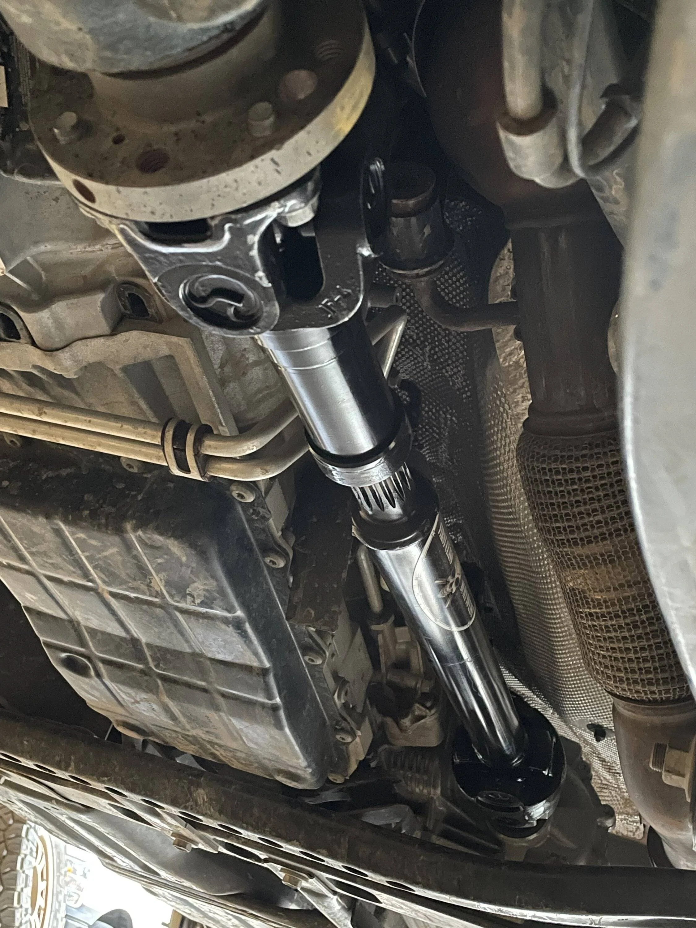

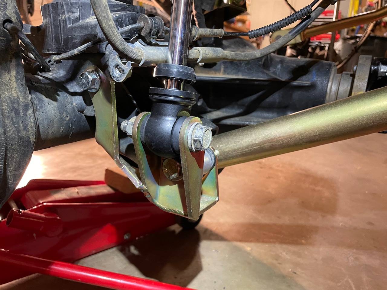

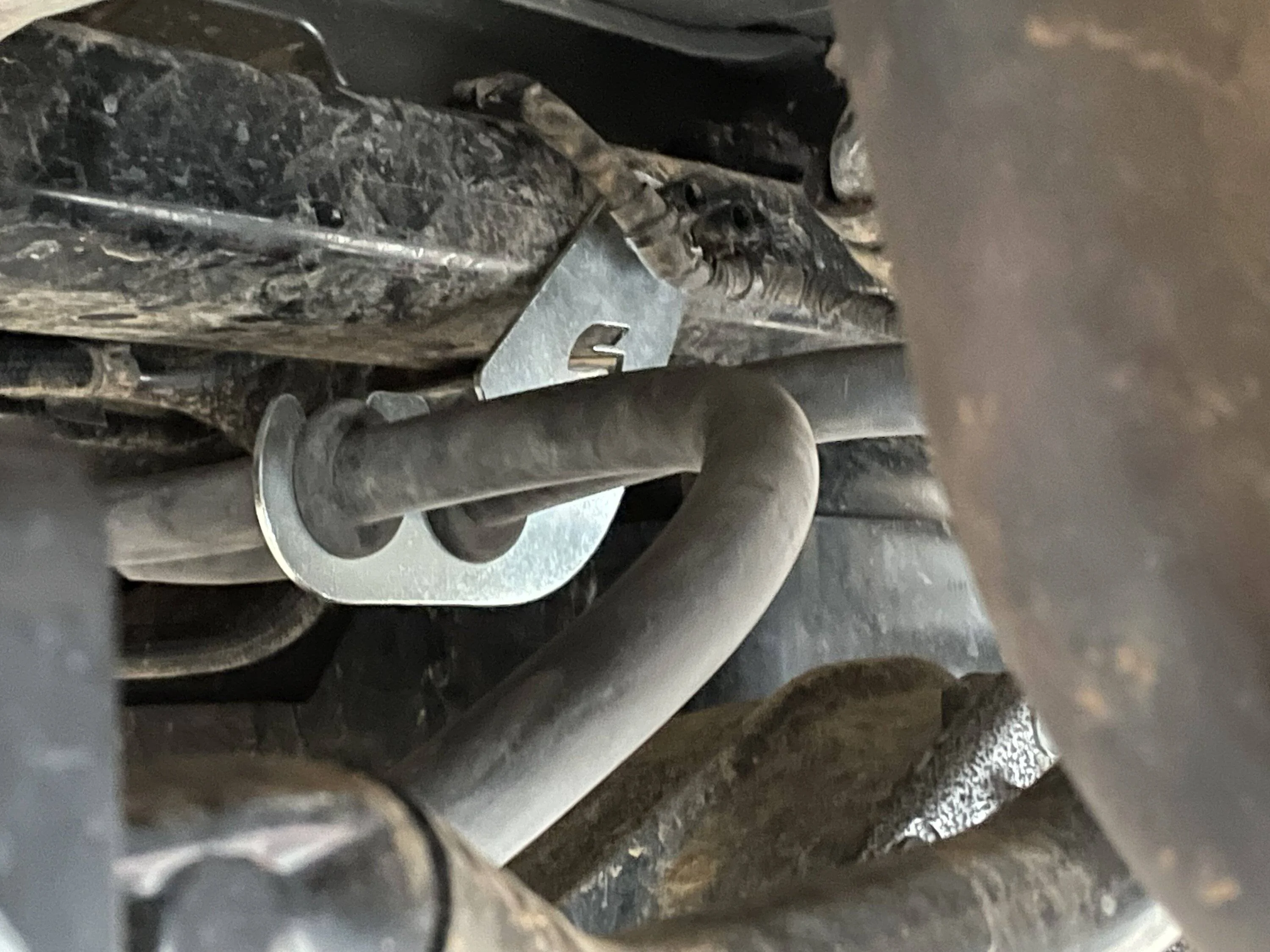

In preparation for the upcoming 3.5” GC lift, I installed a new Adams driveshaft and relocated the parking brake lines using a Synergy bracket.
FYI on the bracket- Synergy has you use two OEM nuts to mount the bracket to the crossmember. On my ‘22 2.0, the studs are there, but no nuts. Just two plastic push-on wire harness tabs. So I had to go run to the hardware store to pick up a couple of M6x1.0 nuts to mount the bracket with. Annoying, but at least the studs were still there.

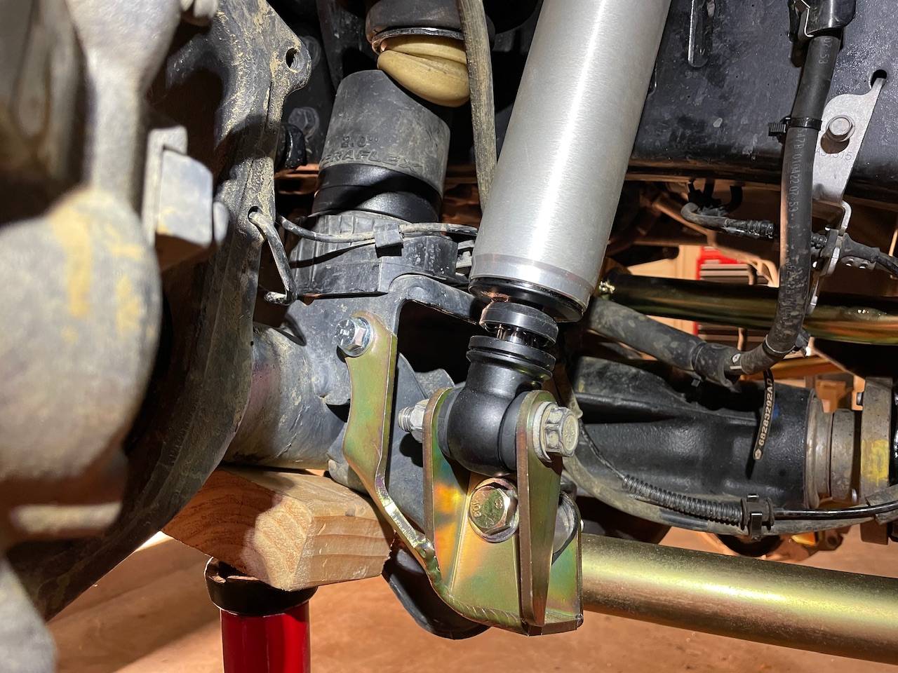

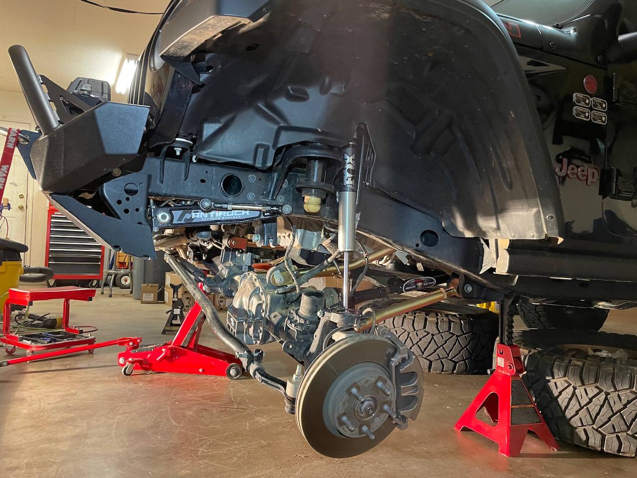

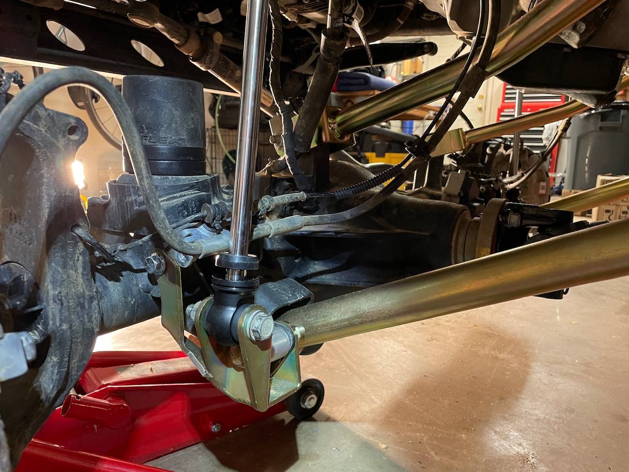

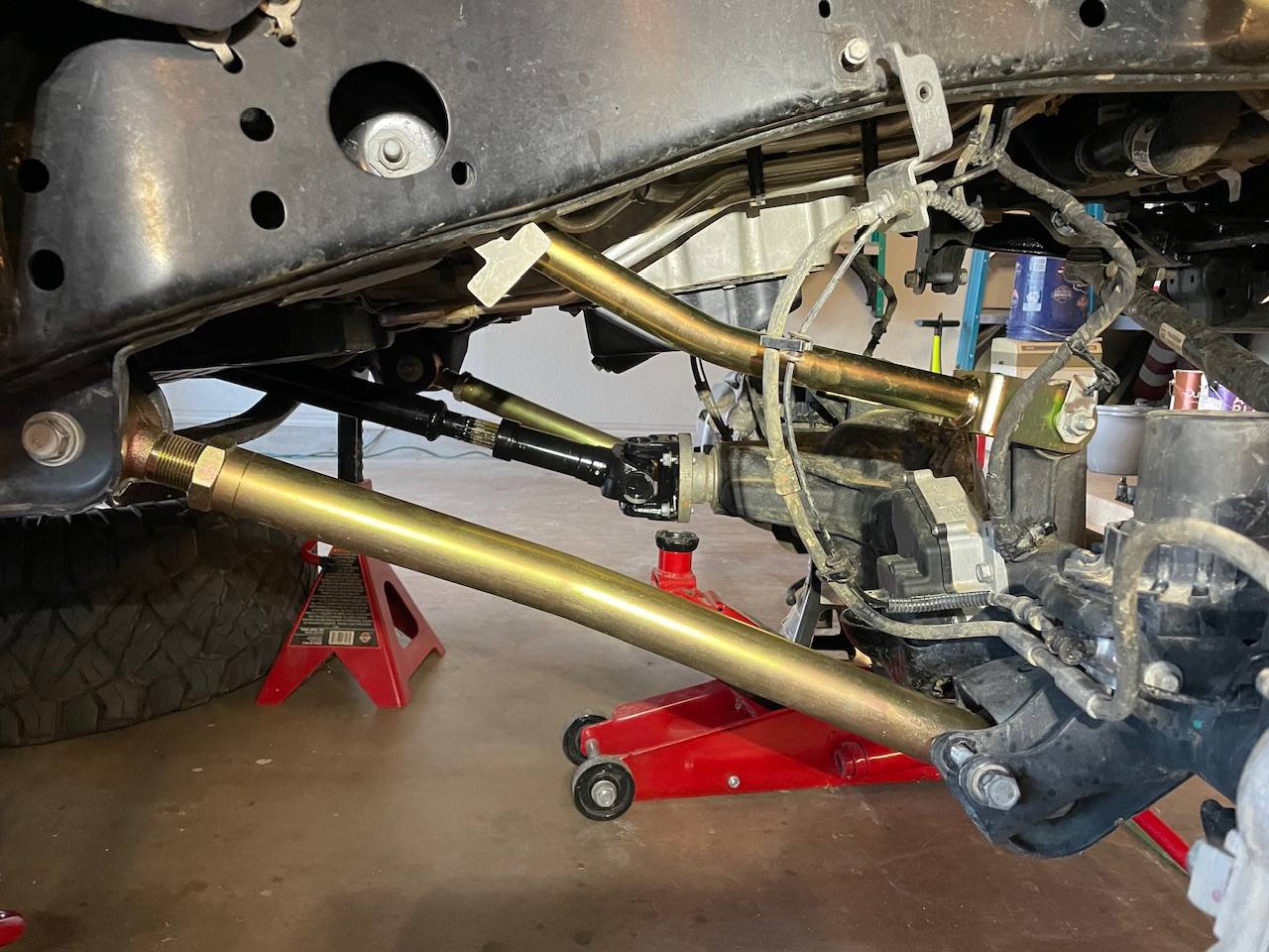

I started the lift install yesterday. I started up front because I knew that end would be the biggest PITA. Everything has gone smoothly so far. All that’s left up front is to find my cutting bit and open up the window on the axle side track bar mount. Then it’s on to the rear end
Jeep Wrangler JL Dark Helmet- ‘22 JLUR build thread IMG_6851
Jeep Wrangler JL Dark Helmet- ‘22 JLUR build thread IMG_6857
Jeep Wrangler JL Dark Helmet- ‘22 JLUR build thread IMG_6859
Jeep Wrangler JL Dark Helmet- ‘22 JLUR build thread IMG_6860
Stuffed
Jeep Wrangler JL Dark Helmet- ‘22 JLUR build thread IMG_6861

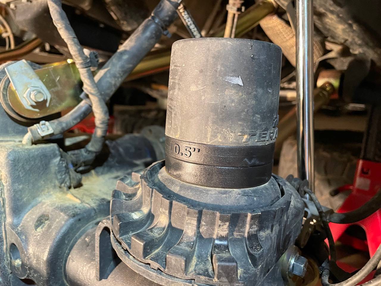

Love these Teraflex bump stops. I can add or delete in 1/2” increments. Better than the MC hockey pucks IMO.

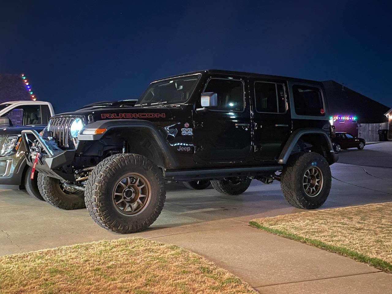

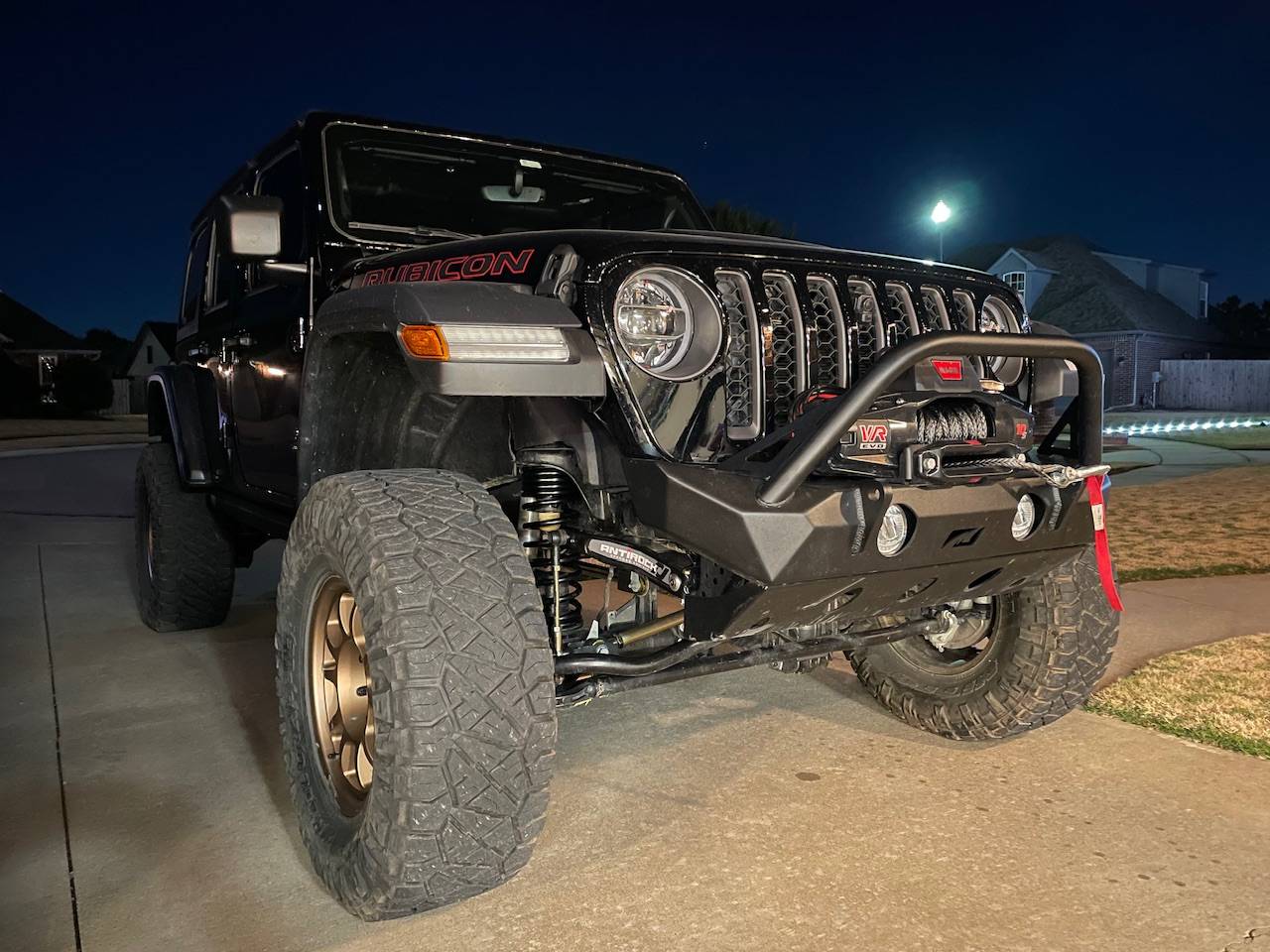

He’s on the ground! Still have to check caster, rear pinion angle, center axles, align steering wheel, and torque everything down, but it’s been a long day and I’m tired.
Everything went really smooth; no real hangups. Not sure how much I like it with the 35s, but the 38s will be on there sometime after the first of the year. I’m just glad to finally have some clearance offroad!
