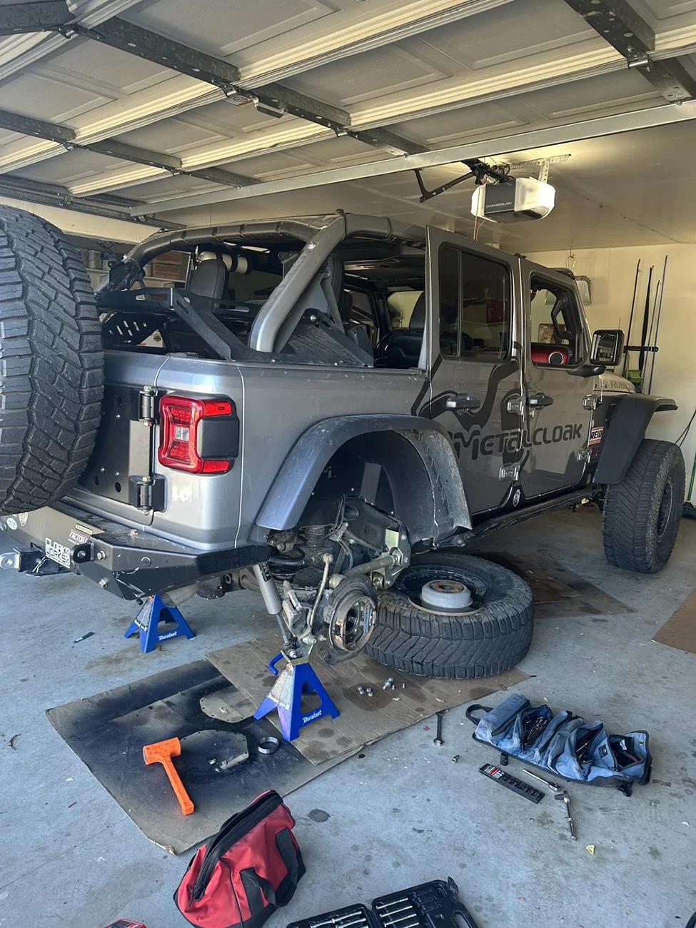

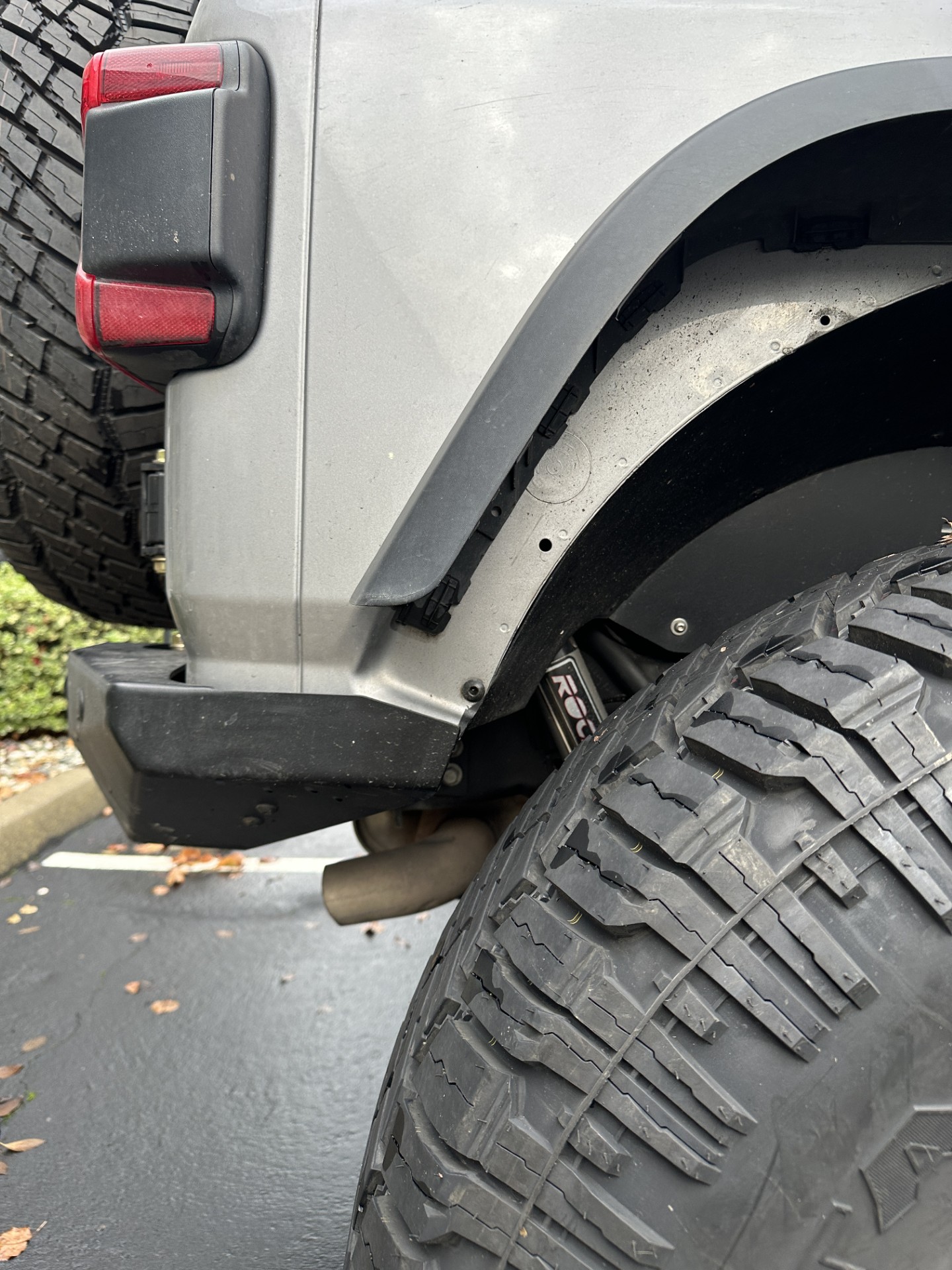

Trimmed up the rear wheel well and the bumper caps a bit over the weekend. I might need to trim a bit more but we will see. I also added 1 inch of bump stop. Next up will be going up to 4.5 inch rear coils, not because I want the height, but I need the taller coil for its free length so I can run a longer shock in the rear.
