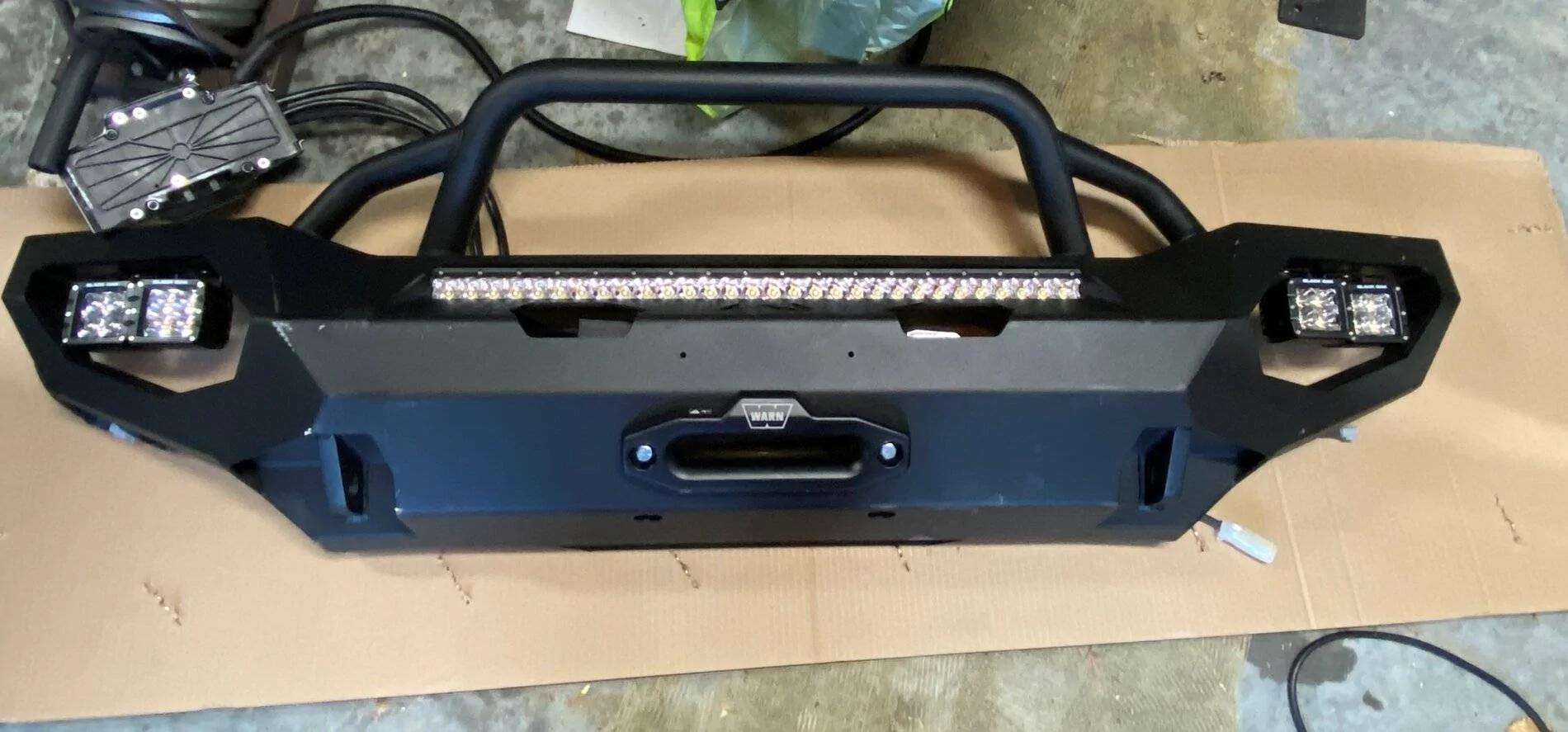

My Fab Fours Matrix bumper install took it out of me, so I was lazy getting the winch wired in and spooled up. I was also debating where to relocate the winch control pack to get it out of the way. Fab Fours suggested behind the bumper, inside the engine bay, or even in the cockpit. Those are the obvious choices, but that damned control pack is pretty big. Shoehorning it in somewhere takes a little planning. Putting it any distance from the winch itself would require longer leads than I have currently installed, and due to the winch being hidden in the bumper, installing longer leads would mean removing the bumper and uninstalling the winch which is not on my list of things to do. That leaves my options a little more limited.
I decided to lean on my old days as an electrician's apprentice one summer during college. I removed the control pack from its pretty casing, and using binding tape, rubber tape, and electrical tape, I simulated a high-voltage connection. That makes the control pack much smaller and easier to stuff out of the way behind the bumper.

Now I just have the problem of the plug for the winch control being inconvenient to say the least (especially if you're in mud up to the frame). I bought a remote control assembly from Warn to relocate the plug, and I fabricated a bracket from 1/4" aluminum that I then sprayed with undercoat.
Now, if I'm completely honest, I had every intention of putting the control plug on the driver's side, but when I put the bracket in my vice to start bending, I just got after it with no thought to which direction I wanted the bend to go. Therefore- it's now on the passenger side!
