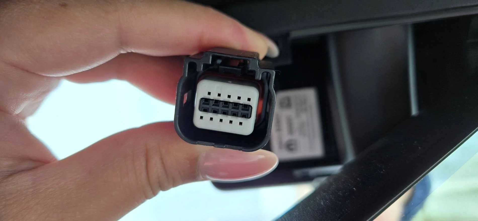

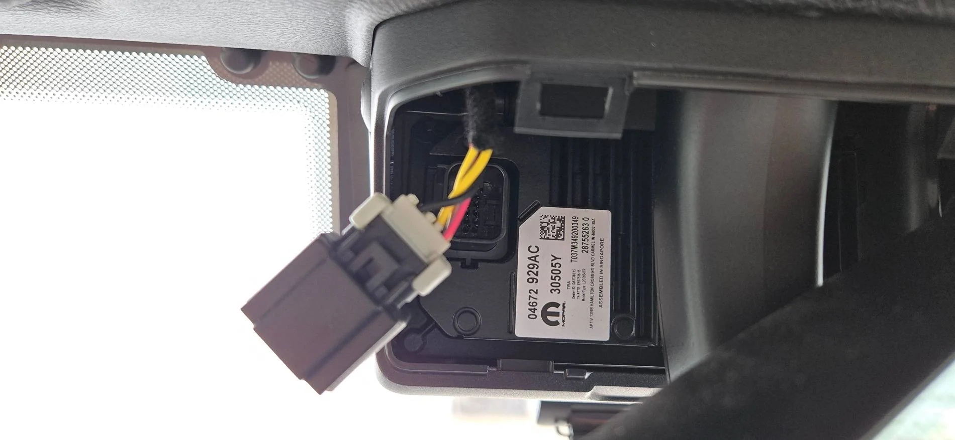

OK, so I took pics of my mirror connector today:
Can someone please confirm if they use a USB-C one that is compatible with 2023 Wranglers?
I received the following response from the seller of https://a.co/d/iz7Ck3o:
"汪文 answered: "Hello Not applicable to Jeep Wrangler. The Wrangler's plug has a unique structure. Mangoal's store offers customized dash cams for Wranglers."

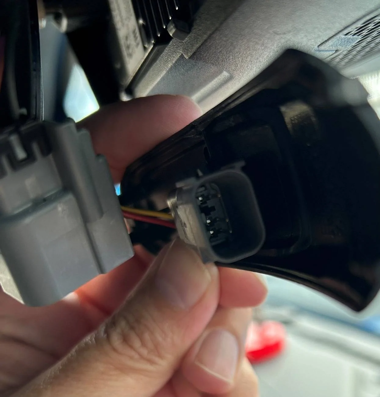

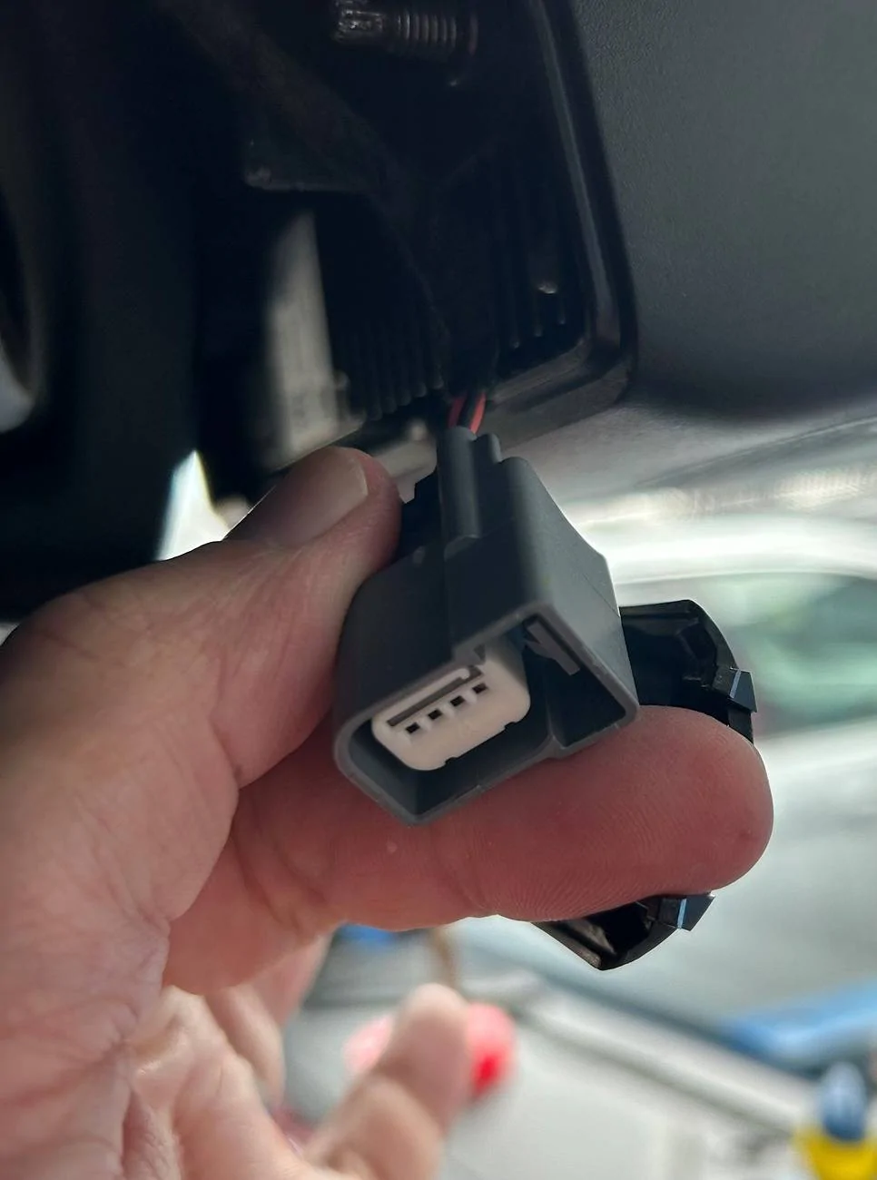

I have the same adaptive cruise control with that plug and there is another plug for the auto dimming mirror. It has 4 pins. Does anyone know the part numbers for these pigtails? I'd love to buy a ready made adapter but I can't find any and I am thinking I will have to buy the pigtails and make my own adapter.

I received the following from Dongar after sending them pics of my connector:
Thanks for your interest in our product!
Unfortunately, we do not have a compatible adapter for the connector in your photo.
That's actually a waterproof harness, and we do not have the means of purchasing these parts due to the supply chain crisis.
For now, we recommend trying out our USB hardwire kit:
https://dongar.tech/products/usb-hardwire-kit
You can follow us at facebook.com/dongartech where we usually announce new products.
Regards,
Riel
Dongar Support
I don't think they know what they're talking about. I can't believe that nobody has any info on this connector - i.e. part number, pins, etc.
Take a look at this video. I think the connector there is same as yours.

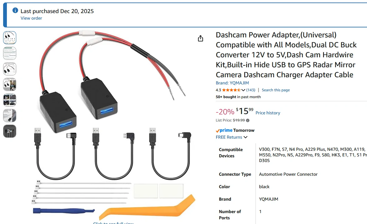

It's nuts how no one makes plug-and-play solution for the JLs yet.
I ended up getting one of these and connected the pins directly into the connector, and secured everything with vinyl electrical tape, and then fabric wiring loom tape. I have Pelsee P12 Pro Max plugged into it, and it's been working great. But I don't have adaptive cruise control. What you can probably do is to get this, and then just splice the wires in for your dash cam. It also comes with tiny volt meter you can plug into it, so you'll be able to figure out which of the holes are live without having to use a multimeter.
Yes, this is the exact adapter referenced in the link I posted 2 posts up. Works like a charm.
