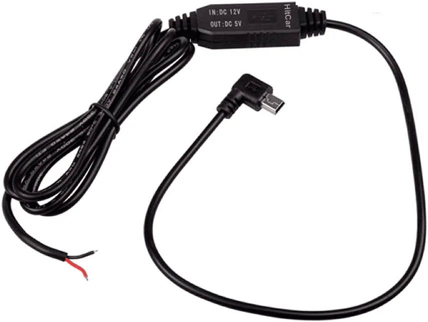

This is what I did for the Dash cam power:
Amazon.com: Hard Wire Charger Cord Cable Mini USB Left Angle Shape 3.5 Meters DC 12V to 5V Power Inverter Converter Regulator Kit for Car GPS Tablet Android DVR Camcorder Recorder by HitCar : Electronics
In my case I took the power from the connector that illuminates the "Passenger Aig Bag" light on the rearview mirror assembly... it works for me because I always drive with the headlights on.. which forces the "Passenger Aig Bag" light to be "On" all the time... but as suggested.. you can use that adapter that piggybacks from the cigarette lighter and run it to the dash cam.. easy.. clean...
I am good with electronics.. I can provide you with more details if required.. :)

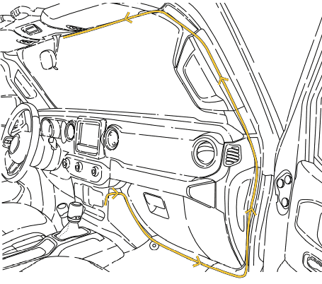

Ok, so this is going to sound super ghetto, I think, but here goes... I aready have all the wiring hidden up the a pillar, and I just ran wires thru the firewall for fog lights. I think I am going to follow those wires and run this wire under the hood, where I will still use the Rove power adapter. I can tap off a fuse to a new power/cigarette lighter like this one, and plug the current adapter I to it. It will all be hidden under the hood anyway, just won't have to look at the plug inside the Jeep. It will be run off the same fuse, so same difference. Am I sounding like an idiot? I can take the truth ;)

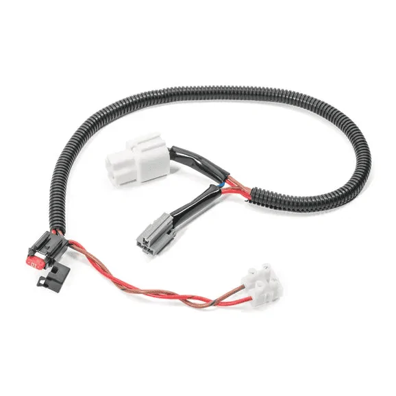

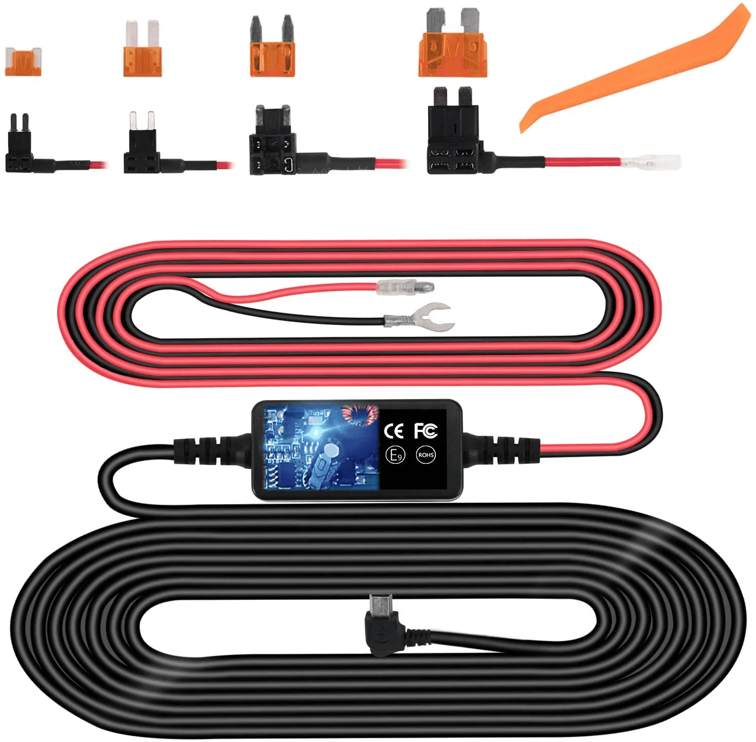

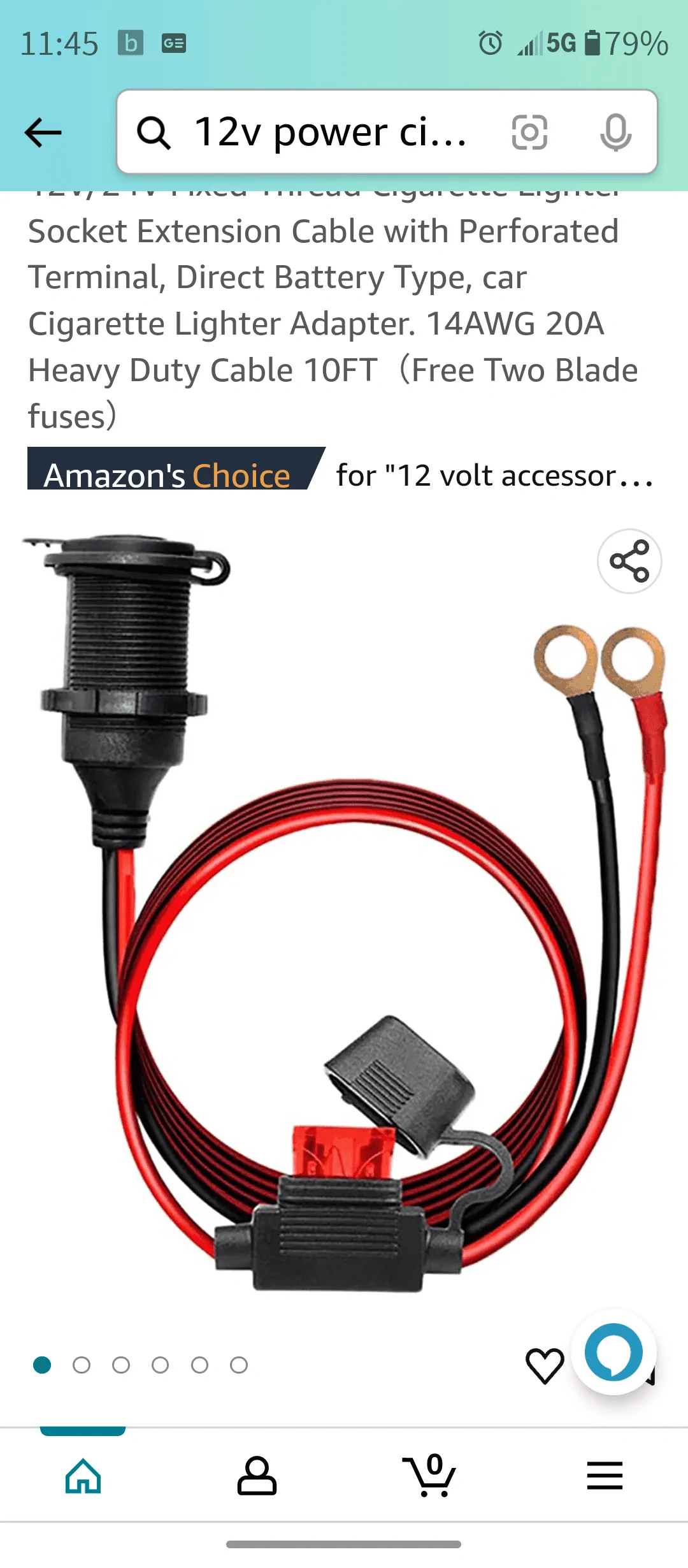

The adapter you linked connects to the battery, not to a fuse tap. So they’re right it will constantly be on, instead of a switched ignition source. You are better off either getting the harness, which is super easy to put in and gives you a power terminal to screw into. Or, tap into a 12 V ignition source like they showed from the mirror or something. From either of those 12v switched power sources, convert to 5V.
If you had a true fuse tap to an ignition source (not constant on), then yes you could run a 12v outlet to that under your hood and then plug in your existing cord into that under the hood.

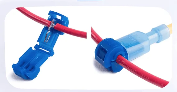

when you say "tap it off" are you referring to those thingies that bite into a cable without the need to splice it?.. like this?
Jeep Wrangler JL Wiring a dashcam? 1678467913489
If so... then.. well.. I am not a fan of such idea... especially in a vehicle.. that gets hot, humid... cold.. vibrates.. etc....

Thanks, guys. Yes, when I said "tap" I meant with a fuse tap adapter, not those wire cutter type connector crimpers.
