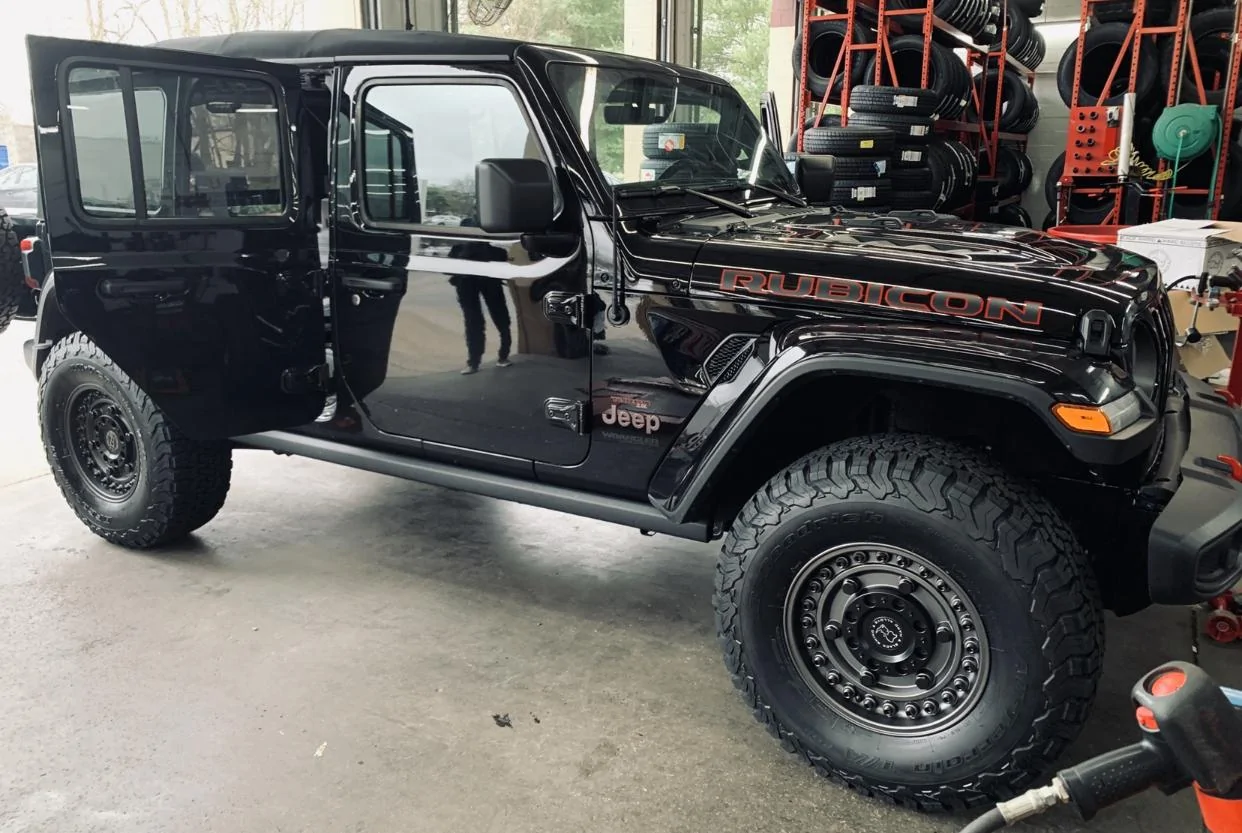

Update - got the wheels and tires ;) - Speedo def not self adjusting lol
