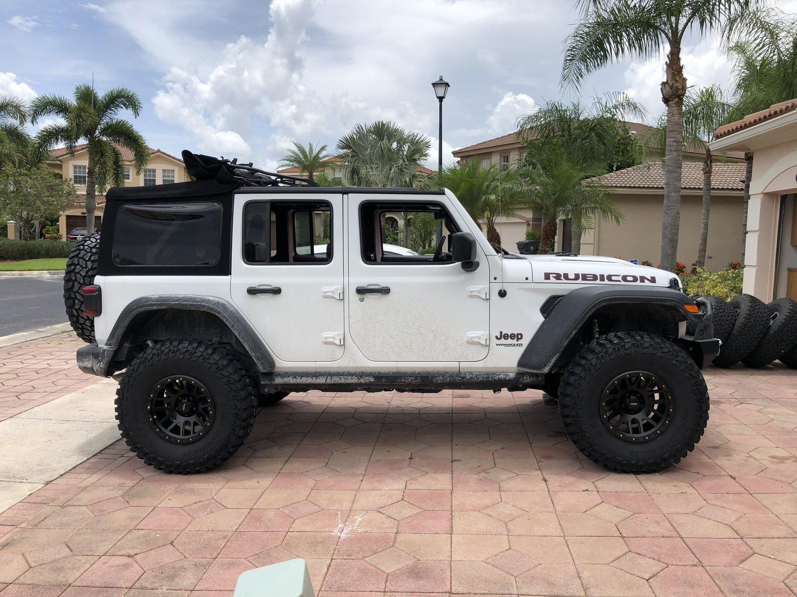

245/75/17 have roughly 641 revolutions per mile
285/70/17 have roughly 616 revolutions per mile
difference of less than 4%
Fact is your tire isn't big enough for you to really notice, and "aftermarket" GPS in general isn't calibrated to be this accurate. You just got lucky in that your tire is hardly bigger than what the vehicle had OEM. Had you gone with a 35" tire, you'd be off by nearly 7% and you would absolutely notice that considering at 60 on the speedo you'd be going nearly 67mph.
