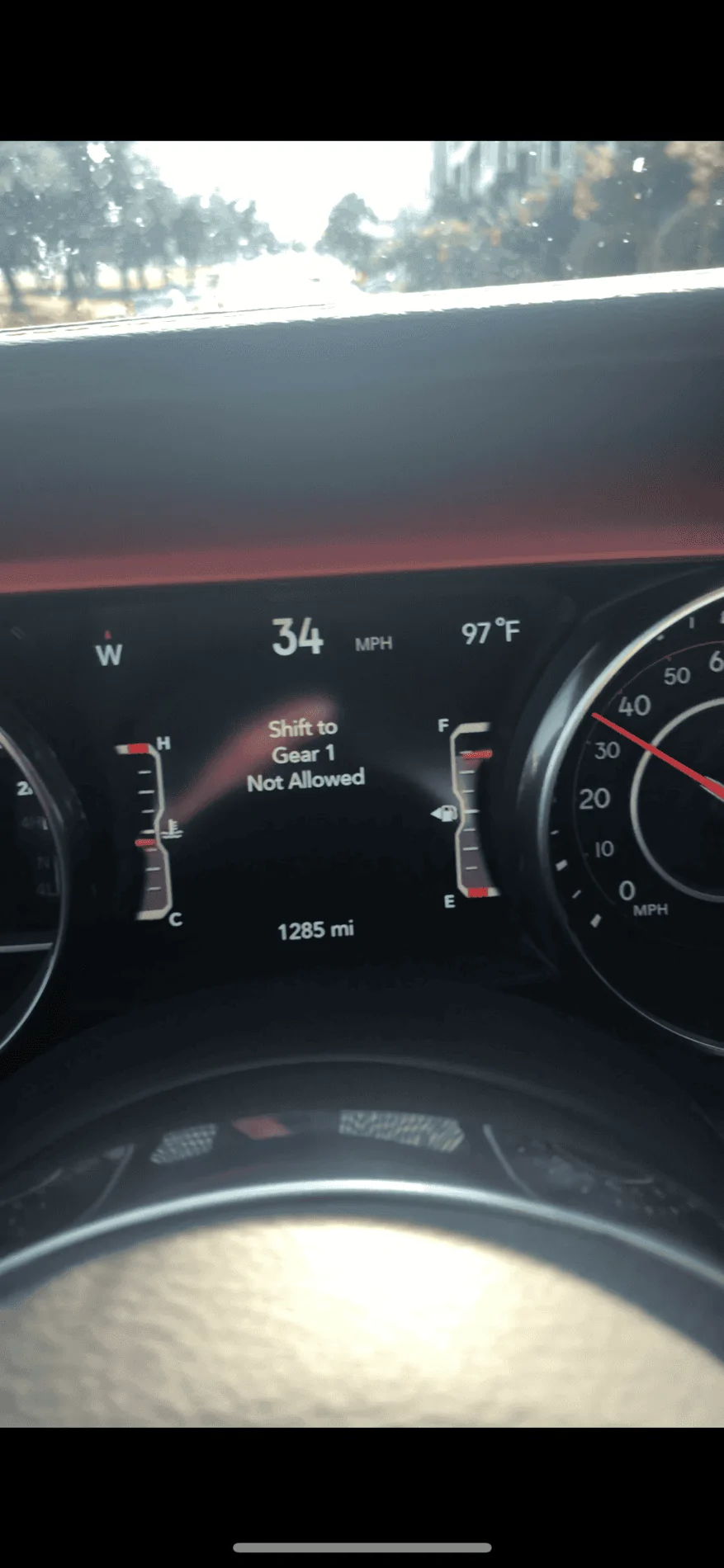

Ok, driving home after work I noticed it once more, so I tried to pay attention a little closer to when it happened. I was wrong about 25 mph, it was when trying to shift from 3rd to 2nd while going over 30 mph that it comes up.
I tried to take a video, but couldn’t take the video, shift and steer in a safe manner. I did snap a pic though where I discovered I was going 34 mph when I tried to make the shift, which is maybe a little faster than I should be going when trying to downshift to 2nd.

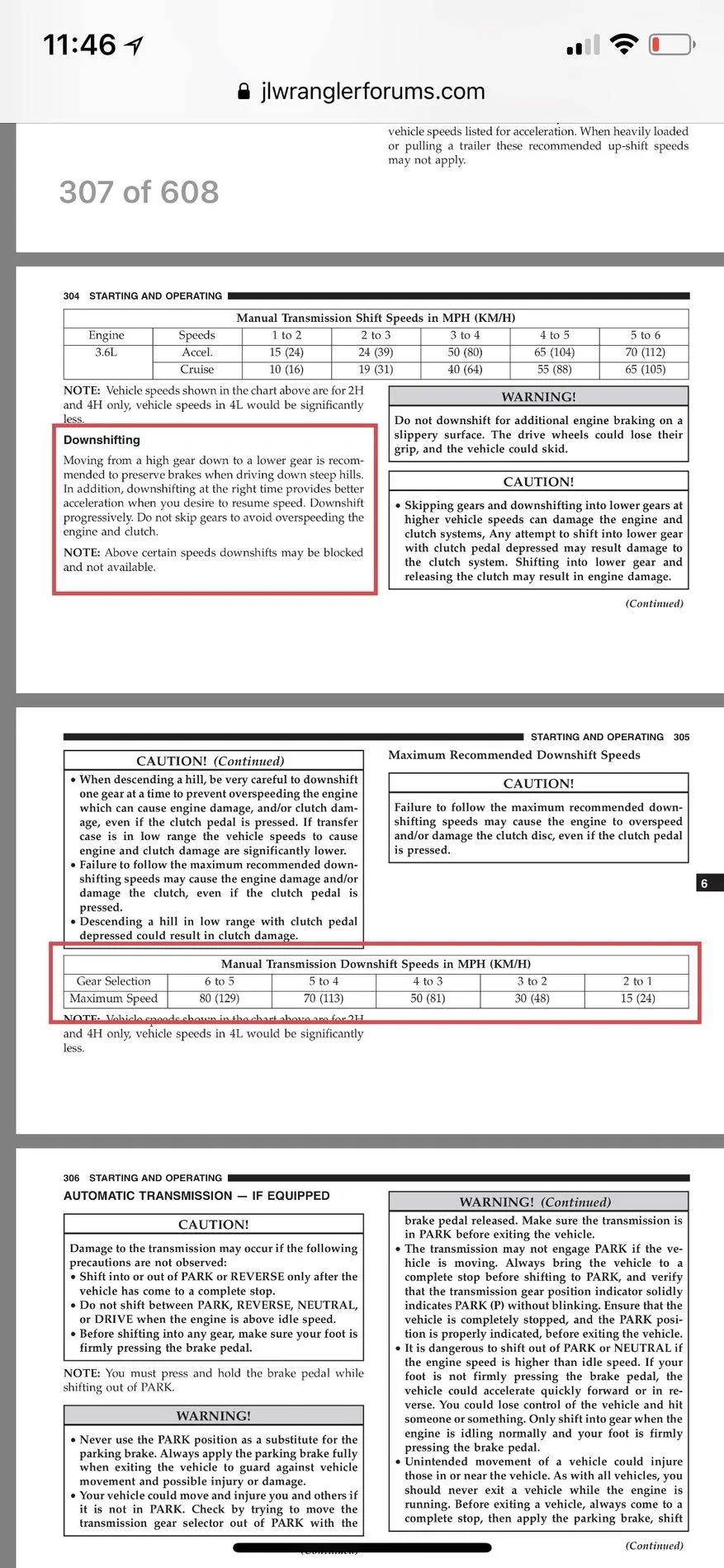

When I got home I looked in the owner’s manual, and it does recommend downshifting to 2nd at under 30 mph, and did not mention anything about how to turn off the “Shift to Gear 1 Not Allowed” warning. Anyways I’ve attached a screen shot of the owner’s manual section explaining the recommended downshift speeds.
The warning isn’t a big deal if I can turn it off, and if anything it made me look in the owner’s manual where I discovered I may be shifting to 2nd at too high of a speed, so there’s that.
