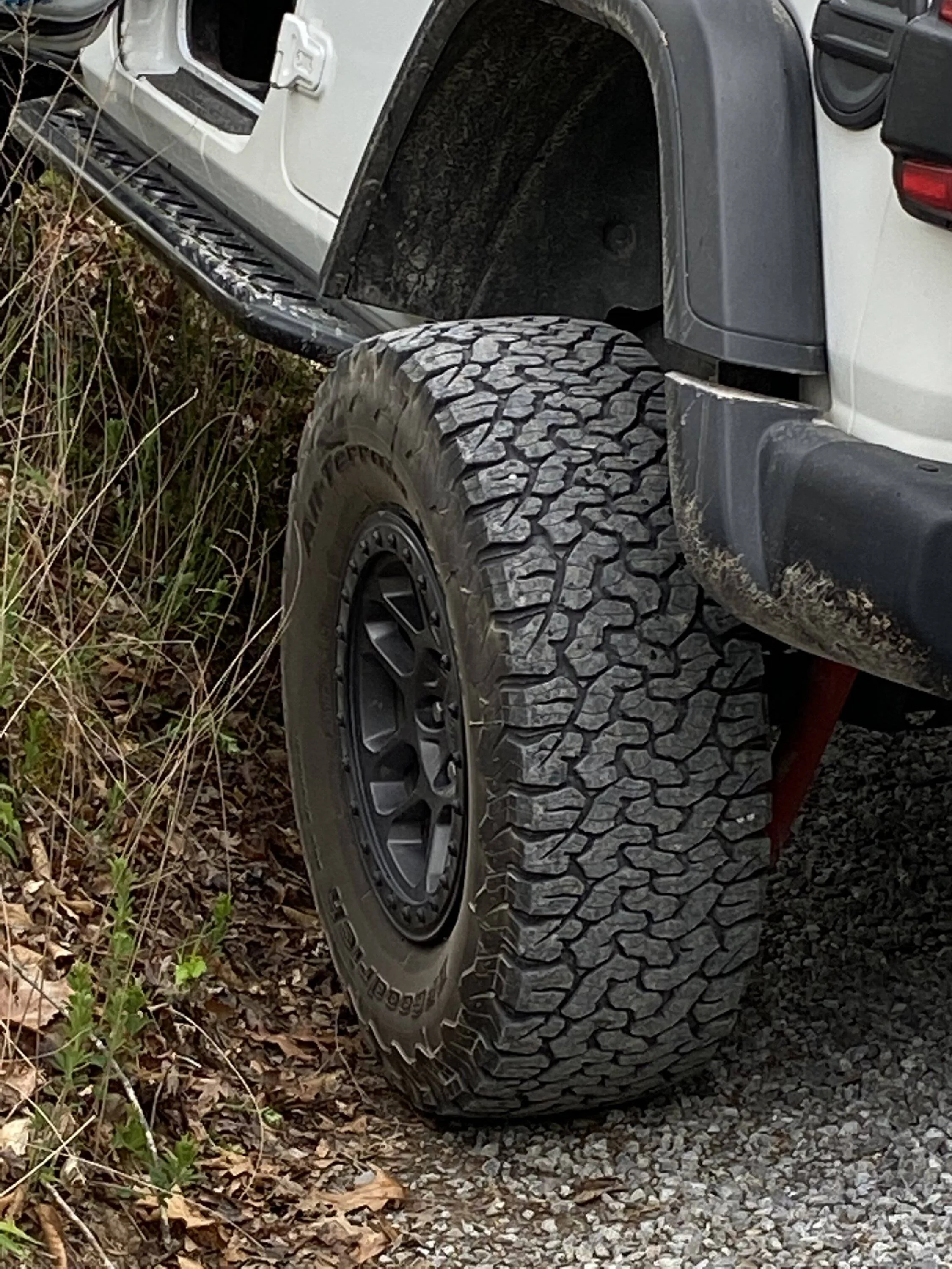

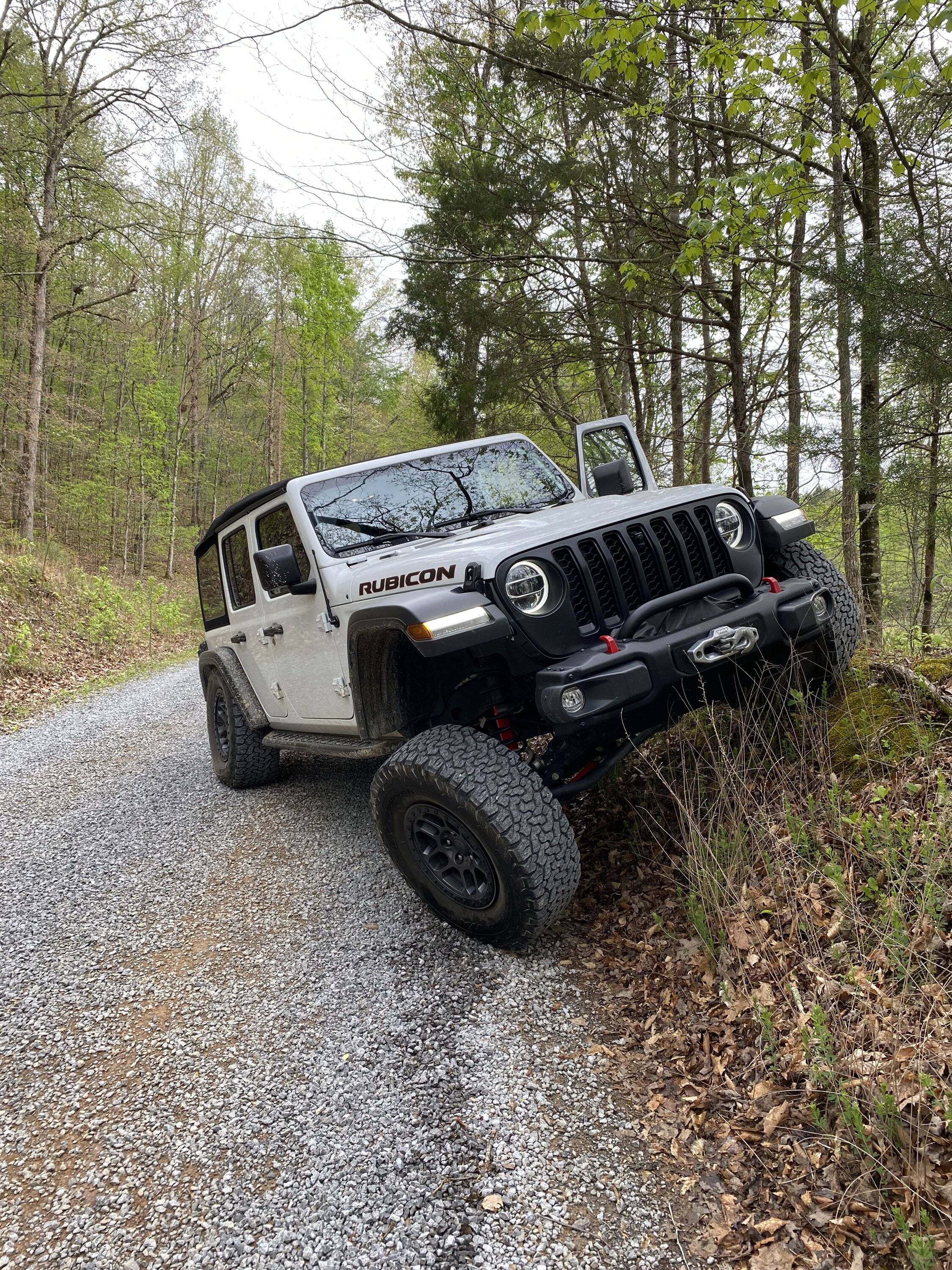

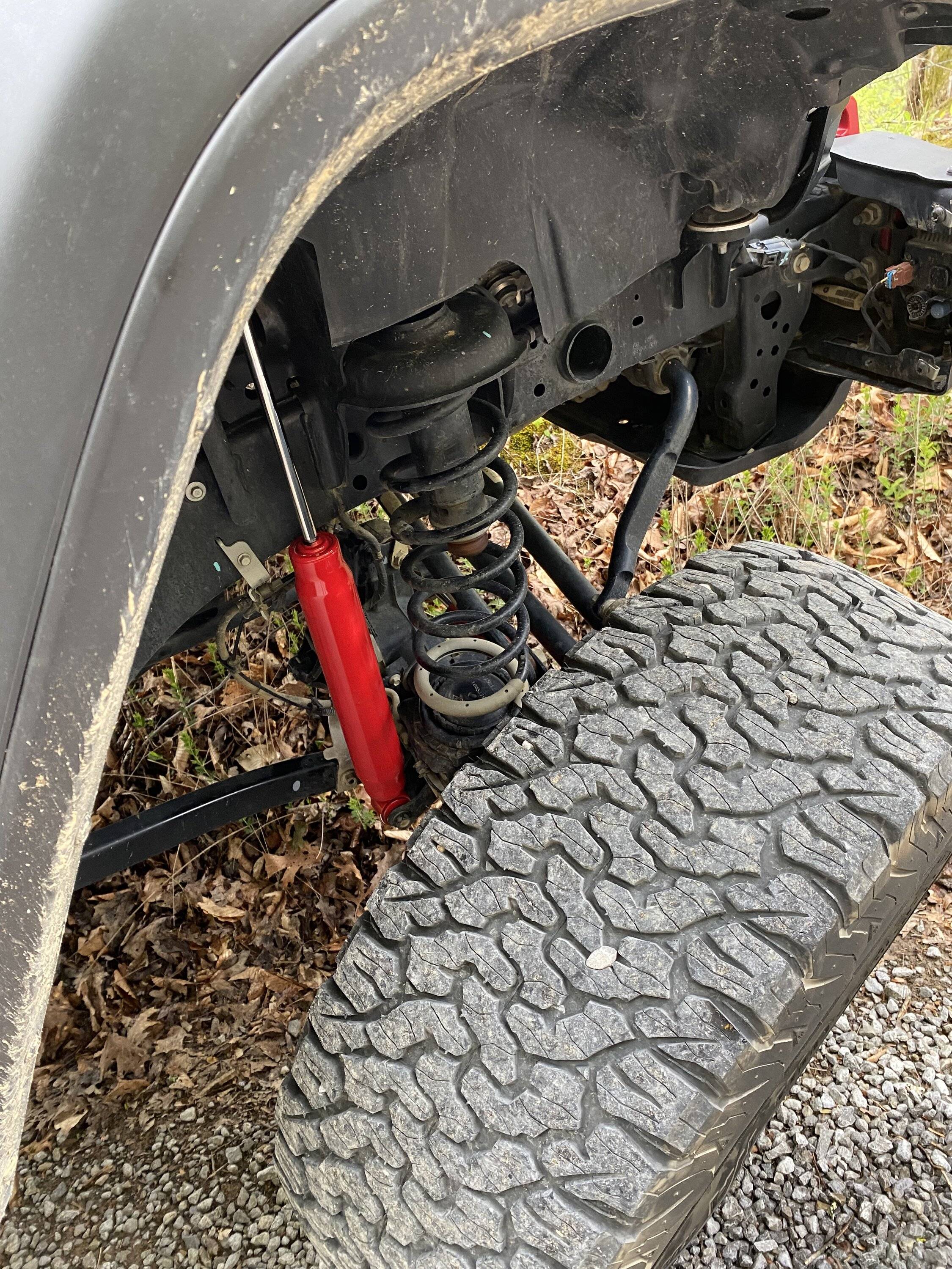

I think I have got about all you can get out of a stock rubicon XR suspension with a few mods. Front3/4” spacer for more space between front bumps that come lower from factory on XR, longer front shocks to get max droop. Rear bump extension taken off, and rear sway bar disconnected.

Might want to check swaybar . Looks close to inverting. Might also see if spring is loose at your full droop.
