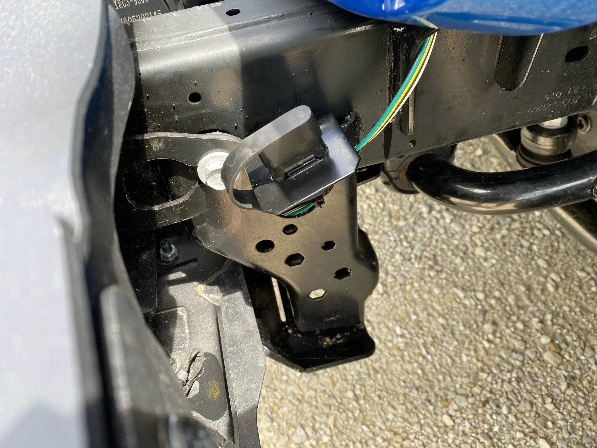

Why I am waiting for all the parts to arrive, been looking at how to run the wiring from front to rear of my 2-door. Was thinking about running it thru the drivers side frame rail as there are several openings from the front to about the front of the rear tire but than I am not seeing any openings to the rear, Looking for how others have run their wiring for ideas.

Sorry for the late post.
Just ran the wiring for the tail lights on my 21 JLURD. Used the Curt wiring harness. Plugs into tail lights.
I ran the cord to the front along the frame rail, drivers side. Up, over the rear spring perch, followed along a wire loom, dropped down beside the fuel tank. Then on top of the frame rail, to a wire loom to the engine compartment. Up the inner wheel well and around the brake block. Around/under the air box to the corner of the radiator. Dropped down there. To the frame at the body mount.
I mounted the angle/plug on the outside of the frame, just behind the bumper, facing up.
Wire is zip tied, about every foot, to wire loom, frame, or whatever is there.
Still have to get the front part of the wires, at the bumper, wrapped in loom.
