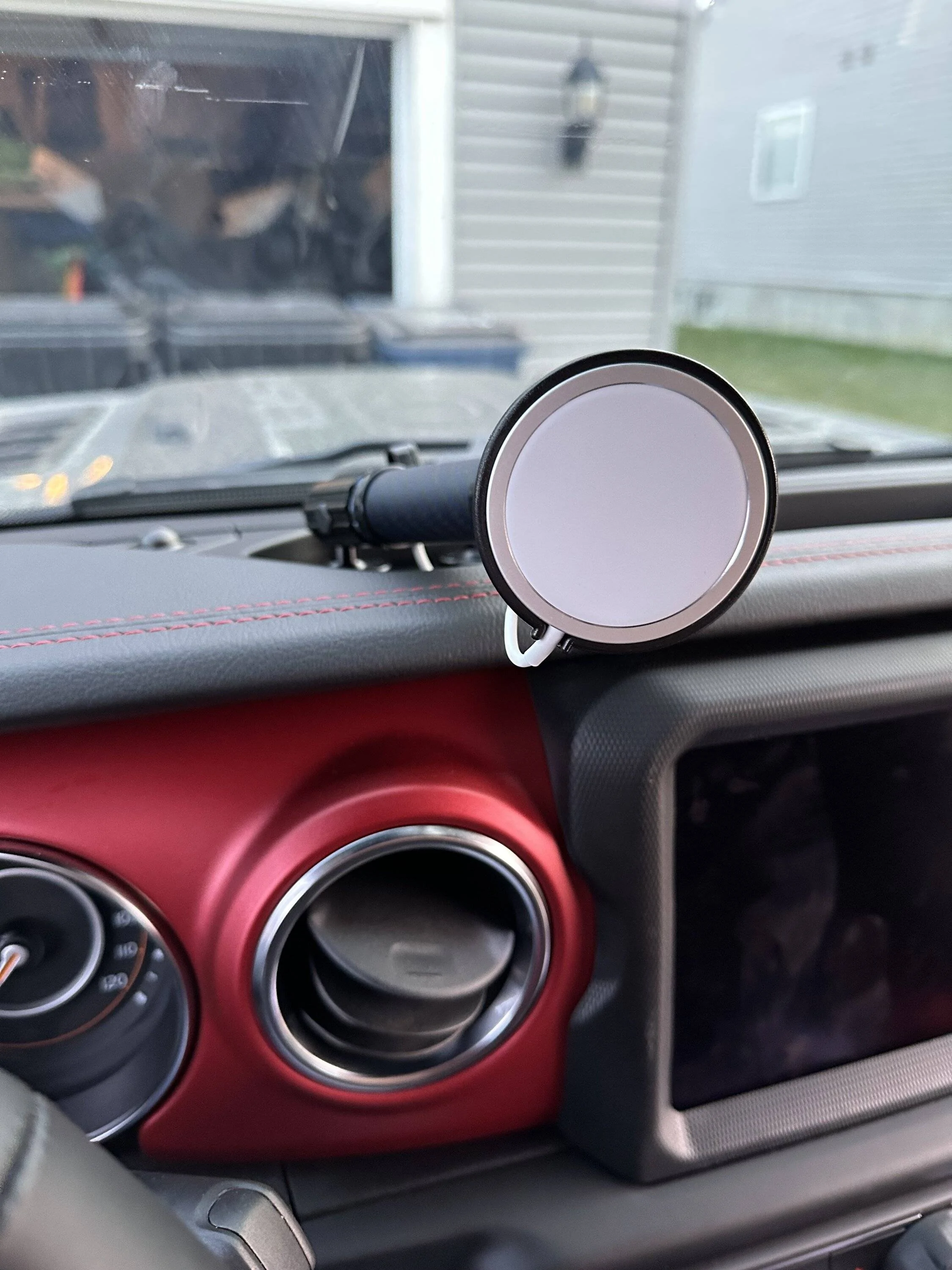

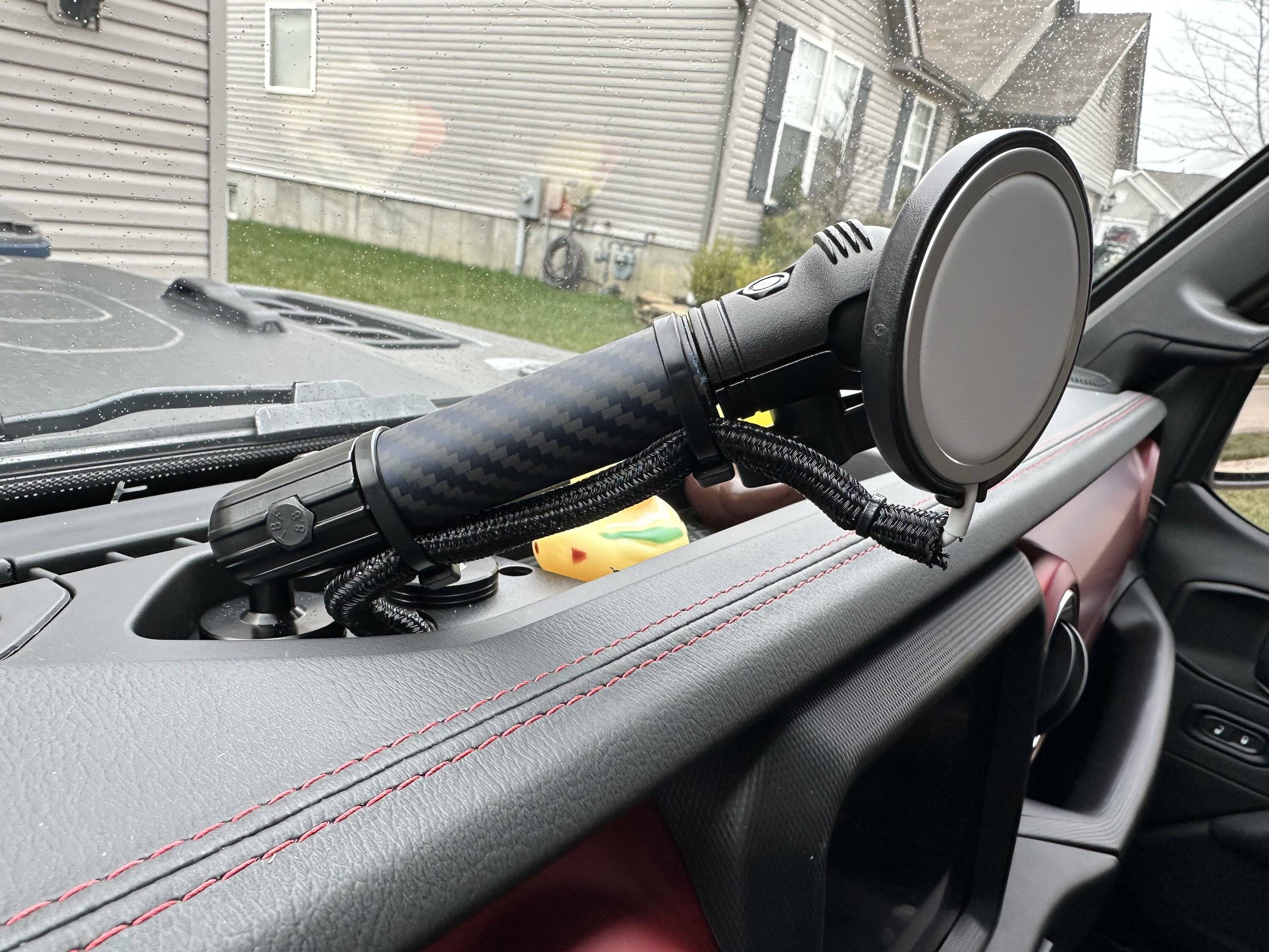

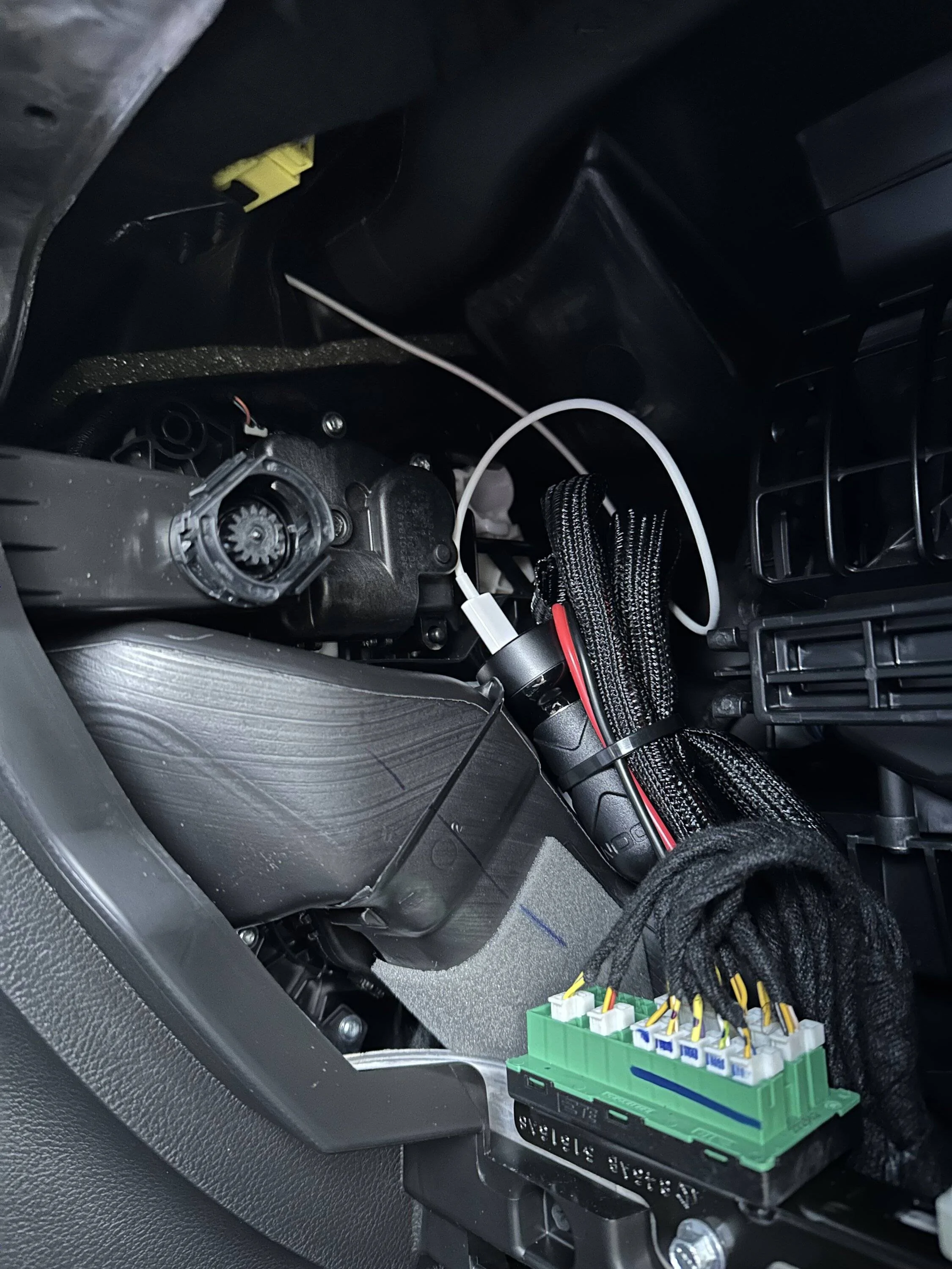

I took a bulletproof mount arm with a RAM mount MagSafe charger holder and used the Apple MagSafe charger on my dash. Wired it into a 12v lighter behind the glovebox into the aux switches. You could also do the same thing with one of those add-on 12v plug wires if you don’t have the aux switch wiring

Nice job, does it fall off on the trails?
I haven’t gone on any trails since I installed it. Roads are no issue though. I paired it all with the Ottocast wireless CarPlay so I still have CarPlay and fast charging. works great.
