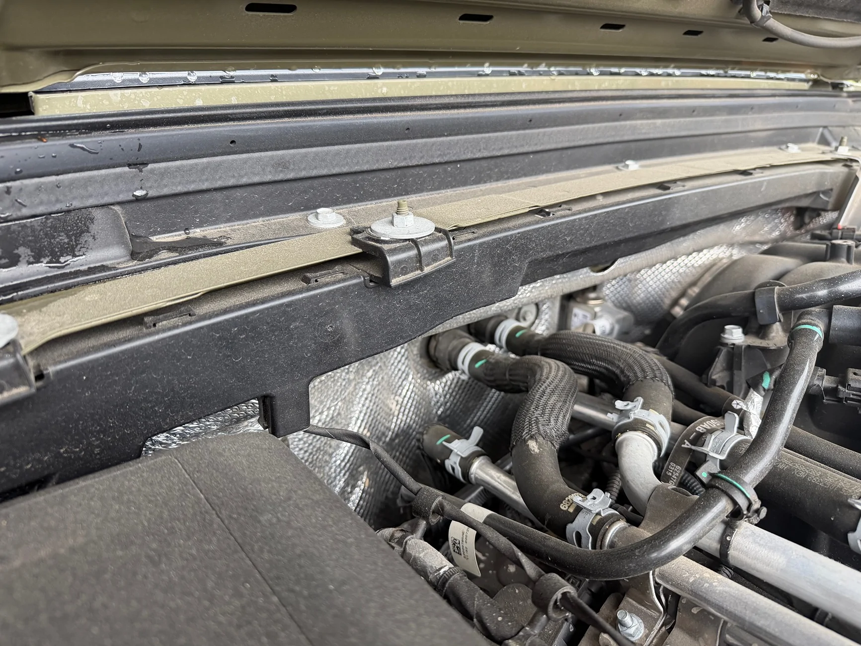

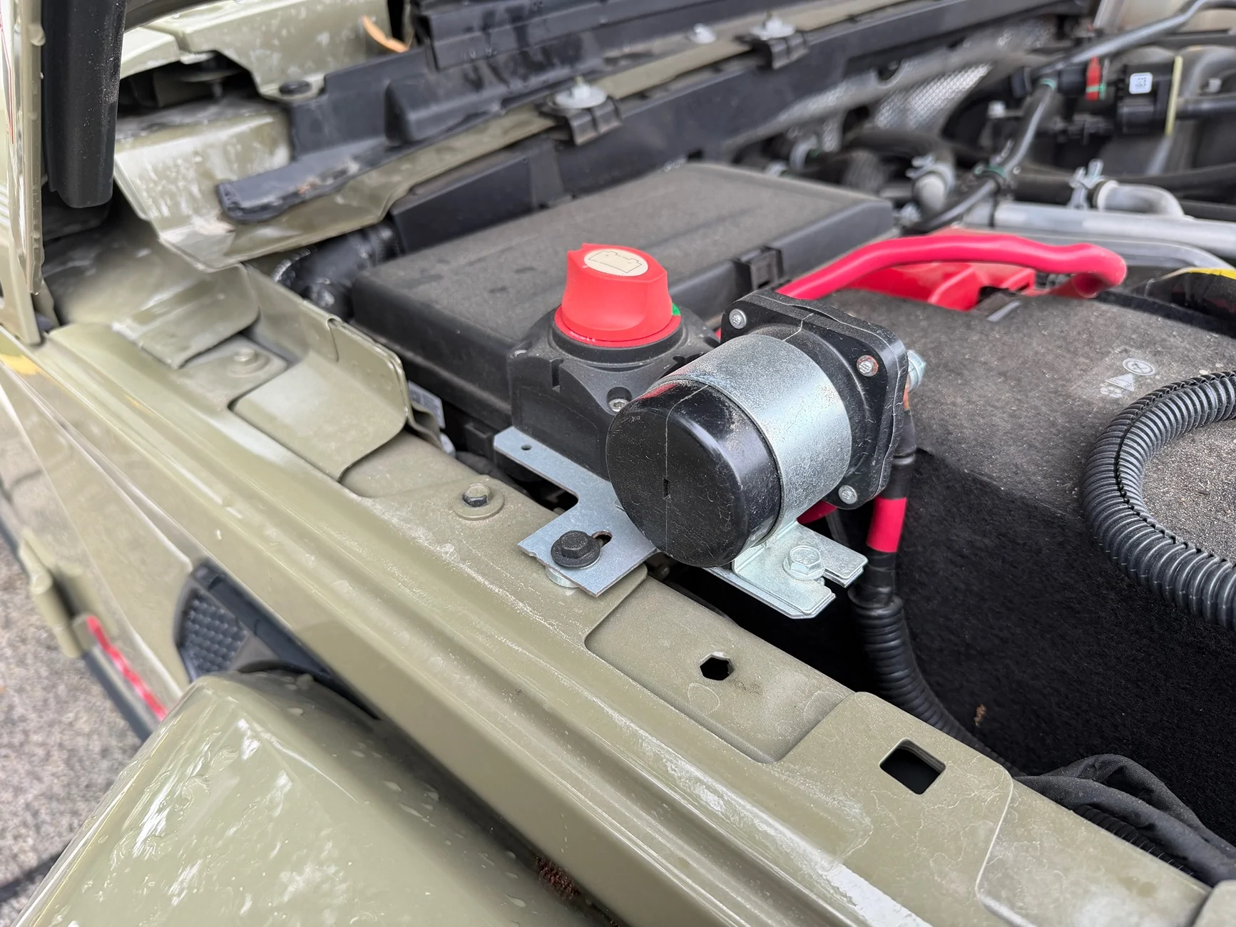

Attached pics. Yeah mounted where it’s at if there is a side impact it could very well still cause a crush/pinch. I think that’s where I think mounting it back close to the fire wall would be beneficial. In terms of the setup I could not find a similar setup anywhere. The solenoid is controlled by the aux switches and if it fails I can still get my lazy butt out and manually turn power on to the winch. But thinking about it now I did just have a real good idea to eliminate all of this and go straight to the damn battery.
Bottom picture is where I’m thinking of mounting.
