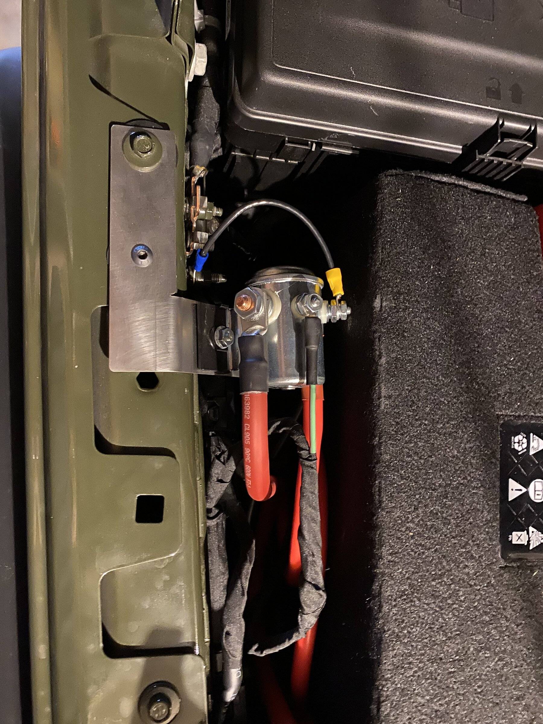

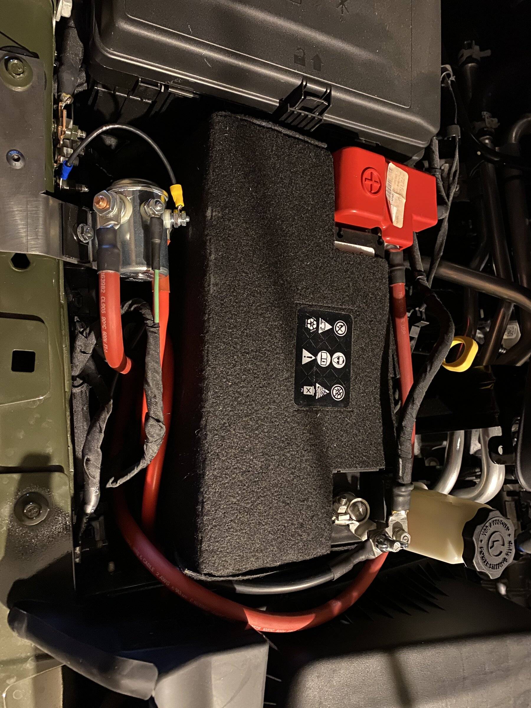

So I went with a solenoid wired to my AUX switches. Custom bracket for the mounting….came out sweet with no additional drilling….used existing bolts and treaded holes.
Jeep Wrangler JL Battery Disconnect for Winch? EA83A7A1-B0B3-4BC6-9900-0A4FF59E8310
Jeep Wrangler JL Battery Disconnect for Winch? D9C92F5B-4014-47E7-83BC-0246D2146B80

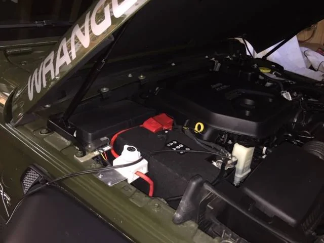

I put mine here and seems sturdy enough just added some washers to secure it on the flexible rubber/plastic. I did have to use one of the extra black wires that came with it and just wrapped it with red tape.
Jeep Wrangler JL Battery Disconnect for Winch? 9142BD6A-8860-419B-887D-AD8A53735610
Jeep Wrangler JL Battery Disconnect for Winch? 7A909999-325E-4E8E-93F1-1DEFC6C5D5EB
