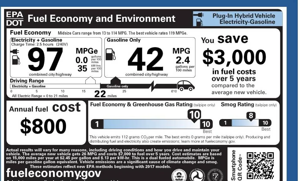

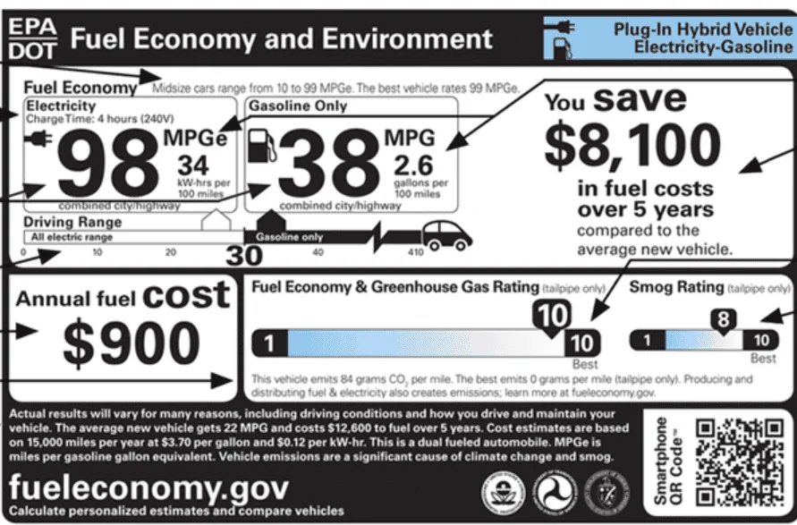

Jeep is rated at 68 kWh per 100 miles
Fusion Energi is rated at 35kWh per 100 miles.
Break even on a Fusion Energi is about $2.00 a gallon.
Break even on a Jeep is about $4.00 a gallon
any gas price less than above, the EV car loses $ per mile vs gas
pretty easy to calculate the difference in costs.
also, pretty easy to calculate your cost per mile.
just remember to charge your Jeep with 68 kWh you will use anywhere from 75-80kWH Of energy, maybe more.
for example in summer it takes me about 6-7kWH to get 5 in my battery. Winter 7-8 kWH to get 5.
Please don't take this as being negative. It’s just the facts and science.
I would jump on the 4xE if it was more efficient. It just isn’t there yet.
2017 Fusion EPA ratings
I can go 21 miles on $1.12 of electricity. I can go 21 miles on 1 gal of gas. I'm not Einstein, but I can figure out that gas has to be less than $1.12/gal to beat the electric cost. What am I missing here? Talk to me like I'm a ginger.

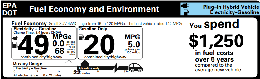

The $4/gallon number only adds up if you misunderstand what MPGe means and think it is saying that the 4xe gets 49 mpg from what I can gather.

This is incorrect and nonsensical if you look at what the information is actually saying and how the 4xe operates. Yes, I know that's how Stellantis put it on the window sticker, but it isn't even consistent with itself on the window sticker, much less with how the epa communicates things on window stickers.

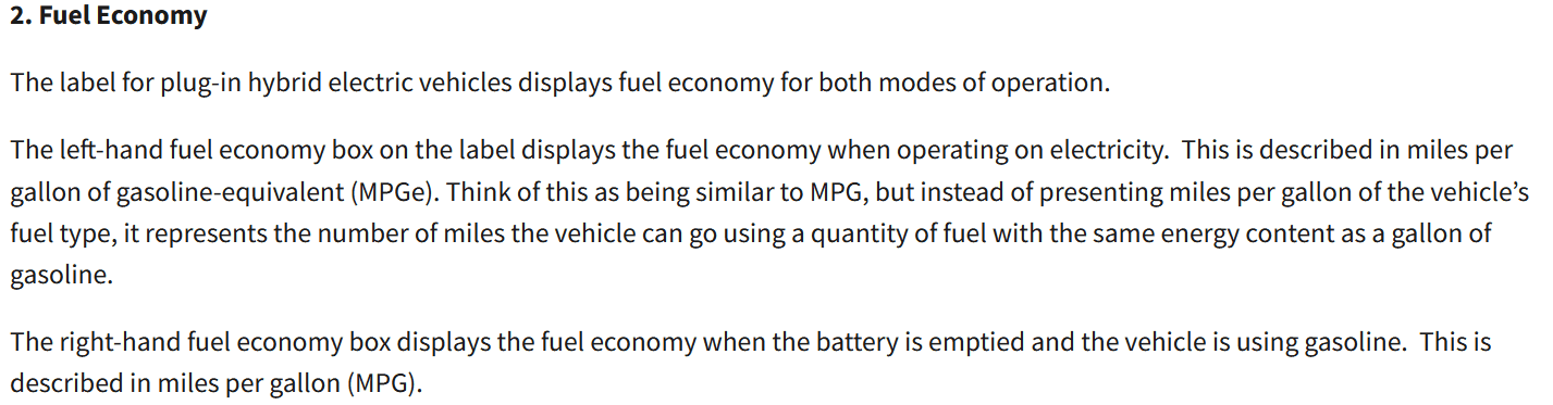

The 4xe is rated at 49 mpge. Mpge is a unit created by the epa to describe efficiency in electric only operation. It is miles per gallon equivalent. One "gallon equivalent" is the equivalent amount of electrical energy stored in one gallon of gasoline; 33.7 kWh. What this is describing is the distance that the vehicle can travel, in miles, on 33.7 kWh of stored energy.
The 4xe has a usable battery capacity when in electric mode of about 15 kWh. If we use that to determine the number of gallon equivalents stored by the 4xe, we would divide 15 by 33.7 to get .46 gallon equivalents. Multiple that by the 49 mpge rating and we get the all electric range of the wrangler 4xe of 21-22 miles.
As mpge is a measurement of efficiency based on the electrical energy stored in the battery, to try to factor in a hybrid usage just doesn't make sense.
Here's where the window sticker doesn't make sense and where the conflict is:
They show "electric and gasoline" as getting 49 mpge, and break that down to 0 gallons of gas usage and 68 kWh/100 miles of electric. It can't be "gas and electric" with 0 gas usage. Further, they show this:
Showing the "electricity and gasoline" range up to 22 miles, but then directly contradict it with the all electric range being miles 0 through 21.
Further, as we know, the idea of a "gasoline only" section doesn't make any sense either, since the 4xe doesn't actually run on gasoline only ever. When the battery is at a <1% state of charge, it still behaves as a hybrid and uses both the gas and electric motors concurrently to proper the vehicle.
If we go to the EPA, we can see how this is actually supposed to be displayed:
Which the EPA describes as:

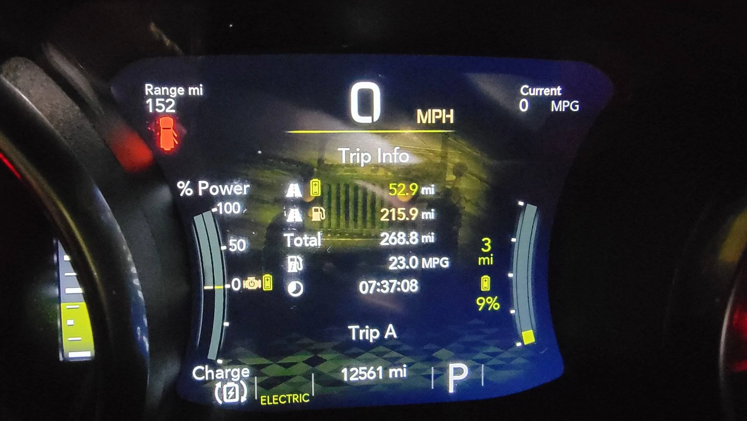

Brother your attempting to explain remedial math to a mechanical engineer with a masters in science whom engineers 1 of Los Angeles largest hydro plants. No disrespect but my actual numbers are higher the "EPA" and "sticker sales ploys". Thus far I've been averaging 23.7 MPG, 22 full electric, and 51.7 to 53.5 hybrid. So we can keep posting your l/kw basic math equations but numbers are numbers. I would highly advise anyone looking to save money looking to buy a hybrid to purchase a 4xE Rubicon, get your rebates, and wheel. I love these posts ?
Good, then you have the background to understand why mpge isn't a rating of some combined hybrid fuel economy.
