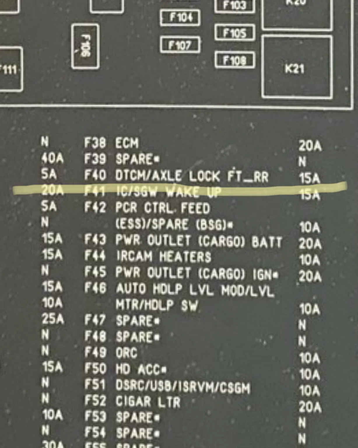

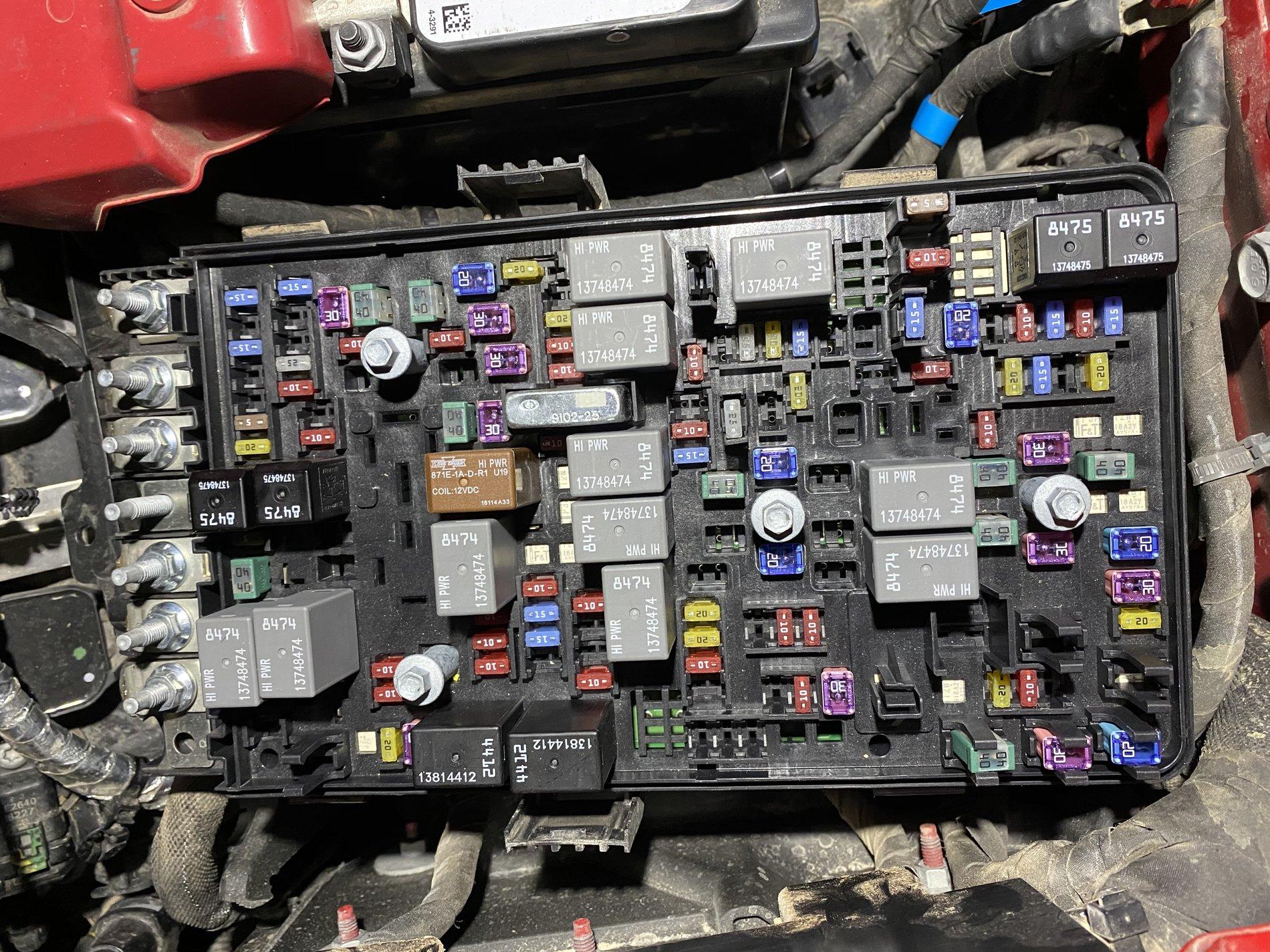

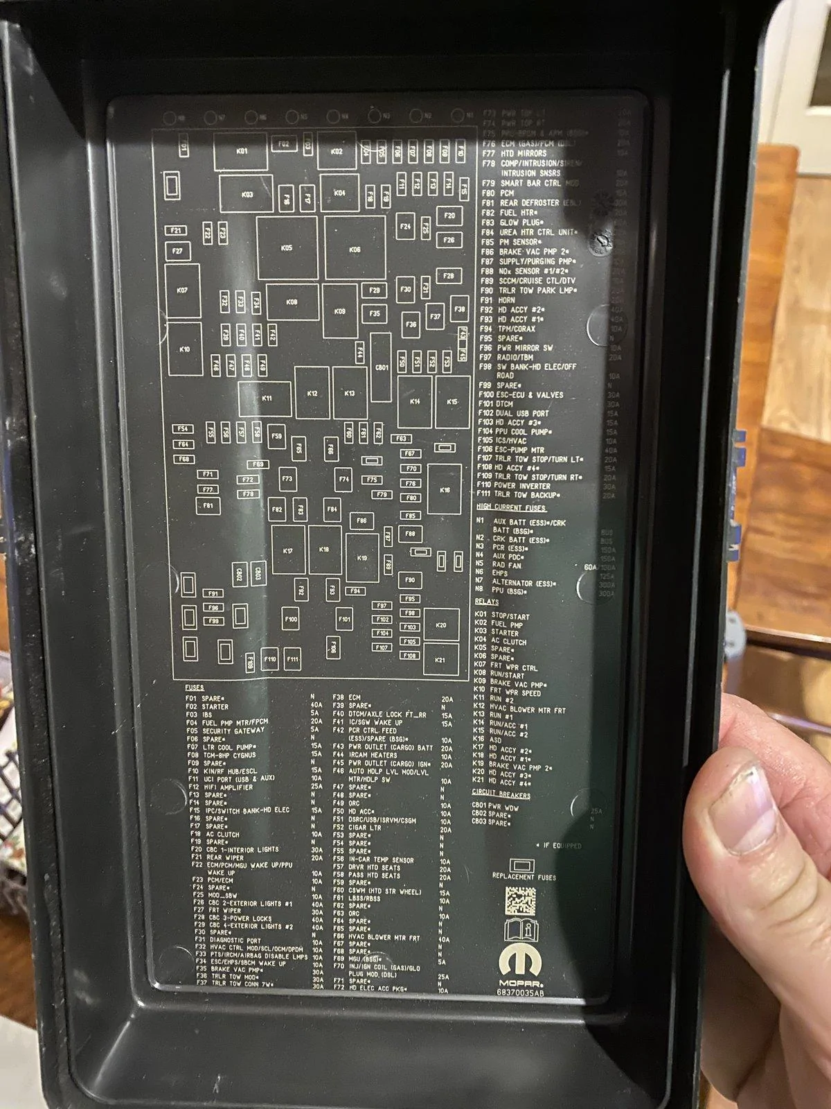

Anybody know which relay controls the lockers?
I'm trying to troubleshoot my 'Service axle lockers' warning message on the dash.

As far as I can see on the electrical scheme, there is no relais whatsoever involved, only the "Drive train control" module, which sends a signal to the locker solenoid(s).

Thank you fir the replies guys, much appreciated.. I’ll check the fuse out.
