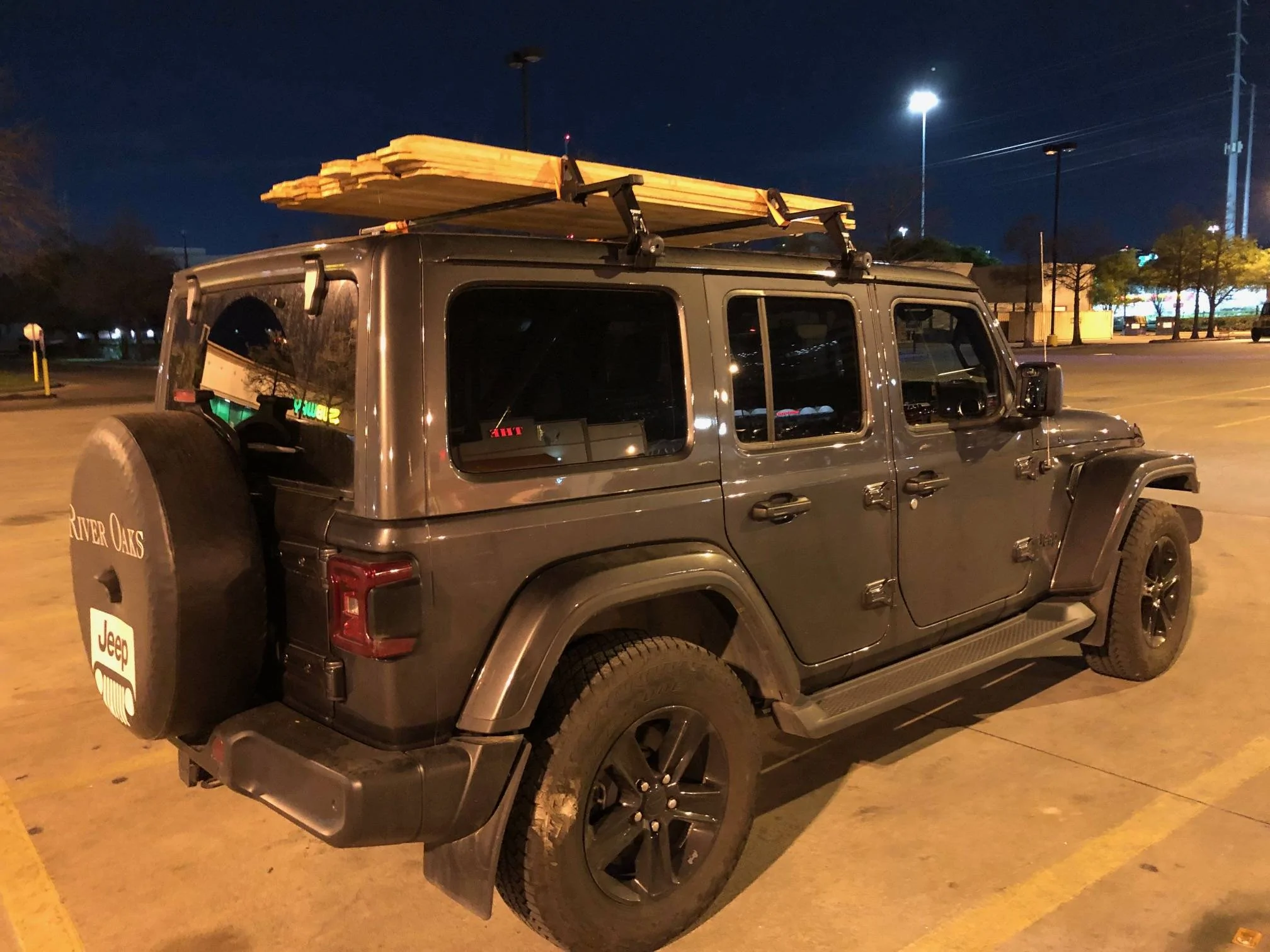

I got the Thule load bars with the rectangular cross section because we have two other setups like that in the family and thus have a number of accessories such as kayak mounts and load stops. I put several minor scratches in my roof the first time that I put them on the Wrangler. Now I wrap the far end in a rag or an old sock before I put the load bar on top of the roof. They have more wind noise than I remember the same cross-sectioned bars having on other cars, but that might be the nature of the Wrangler's (hard top) roof more so than the bars. They work well, but I can't say that I'm super excited by them.
Update on 1 June 2023: The load bars weigh not quite 8 pounds each. Based on the weight of one of those pickets of 55 ounces, the total weight of the wood was 90 pounds.

This is what I have: https://www.thule.com/en-us/roof-ra...018,variation:roof-type-617954|Rain%20gutters . I think that the load is limited by the fact that the Jeep's roof and rain gutters are basically plastic. The Thule instructions say that the load limit is 220 pounds.

I look at this pic and I think that load is risky. Those bars just connect to the the rain gutters and they're not all that strong. They do break. The HT is holding the entire weight and it's not strong either. I don't see a point in risking an expensive hard top over cheap crossbars. That amount of wood is likely the limit as to what those rain gutter connected crossbars can carry.
If you get a rack that can support a RTT these bars would likely be useless. You may be able to repurpose them into bars mounted on the rack with a generic adapter but it would be a bit of a cludge.

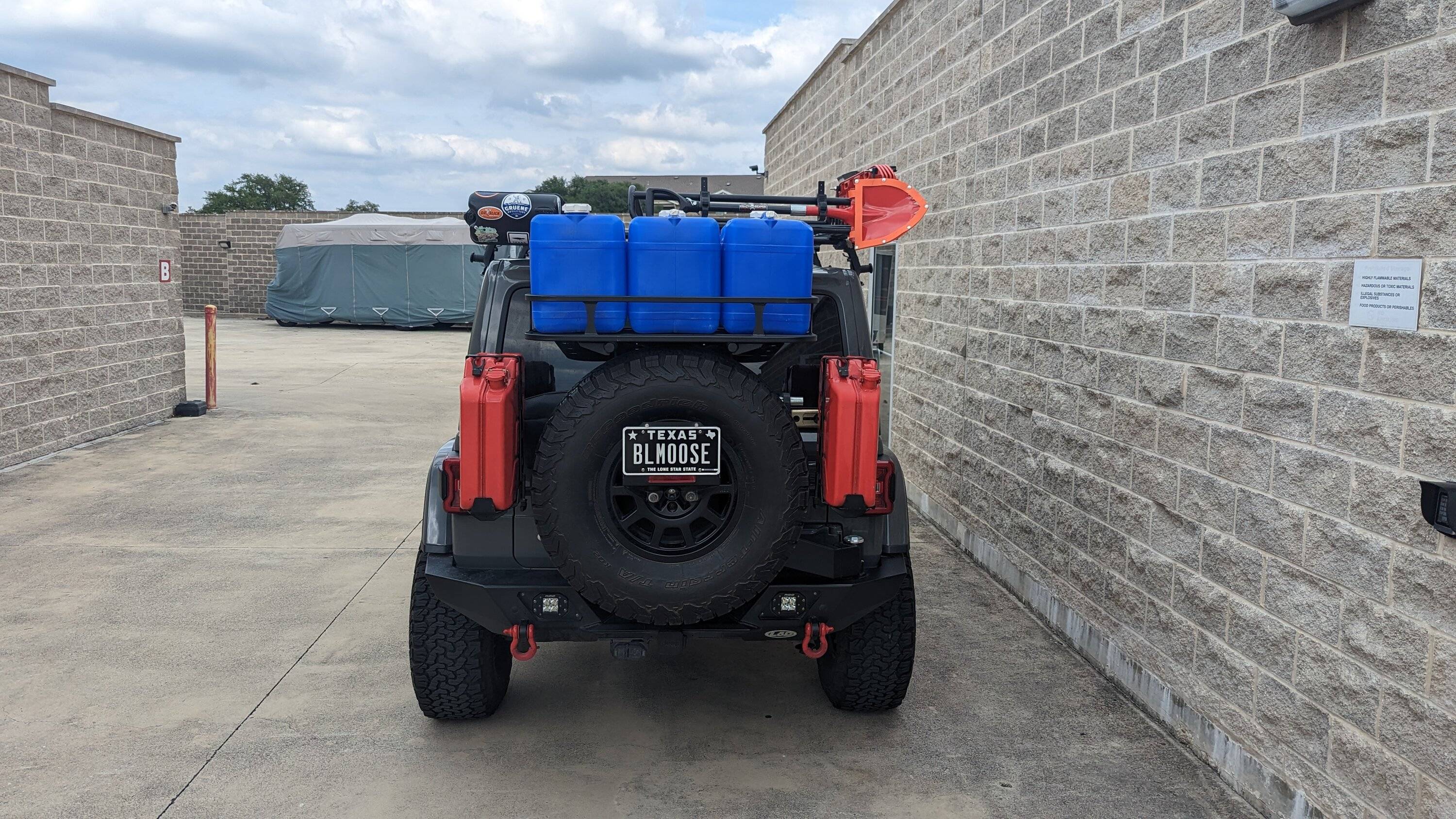

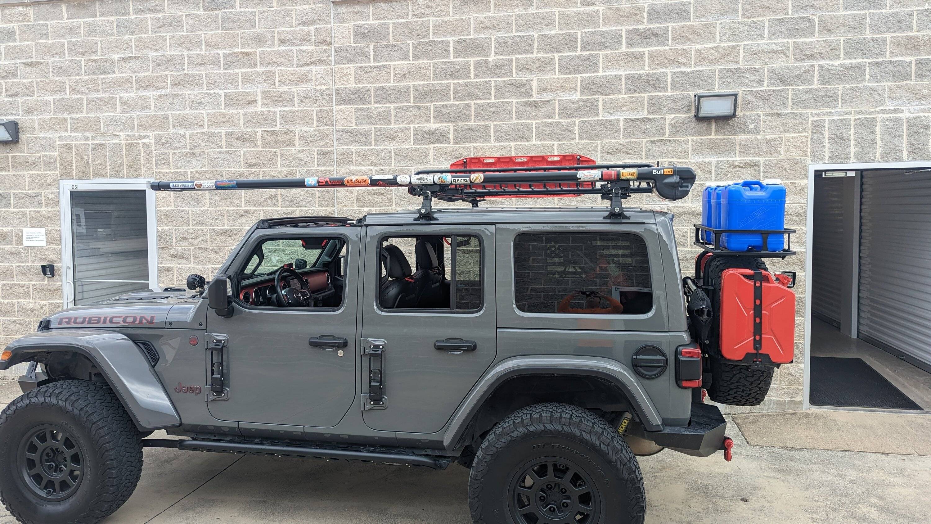

I took, have the Thule cross bars, but they are round. Good for all you see here, TERRIBLE for the Thule Kayak carrier I have. The rotate on the round cross bar.
I dream of one day having a Rhino Rack Platform with the Backbone system.
