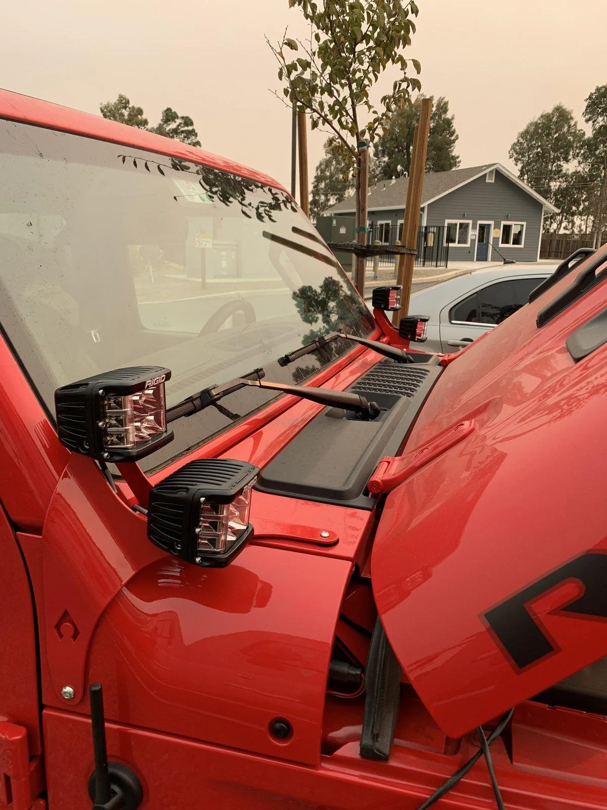

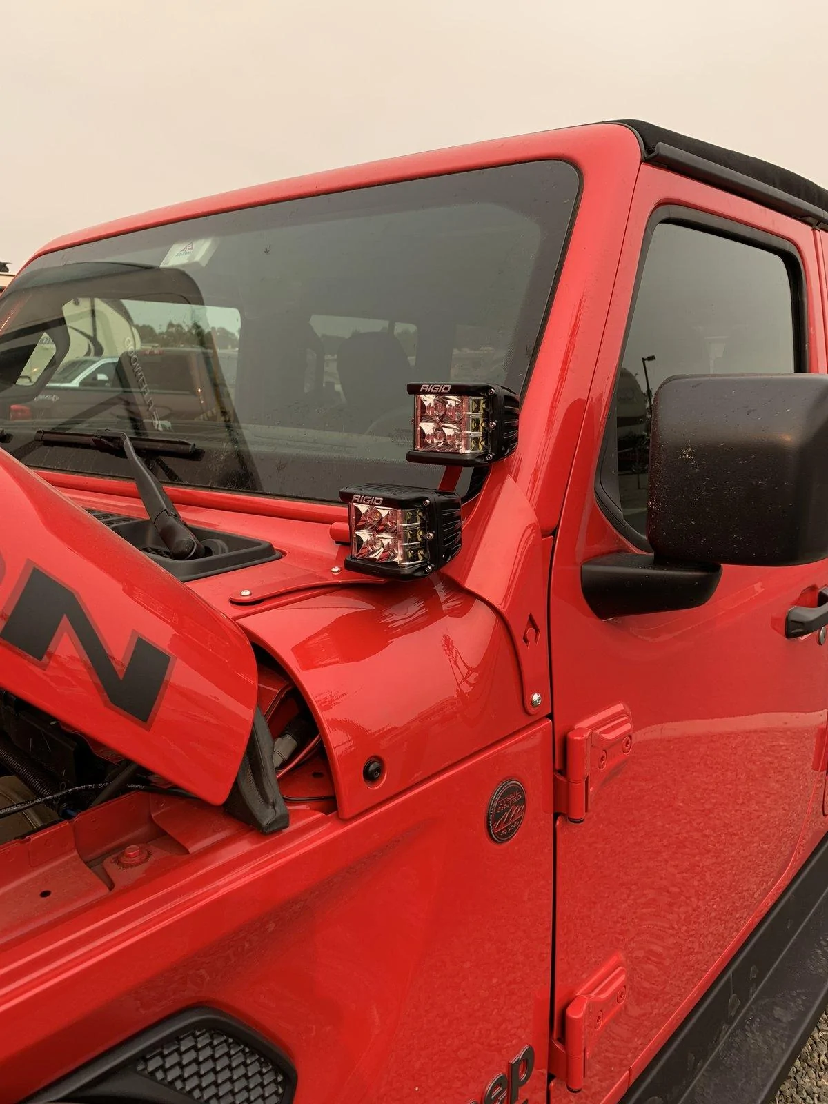

Got the Artec mounts and had them powder coated to match the jeep....I think they look awesome!!!

I'd have to agree... I like the look. I tried the same mounts, but the upper/lower cubes I had were slightly different widths and tightening them up affected the angle of the lights. One was a pair of Rigid D-Series, and it was a pain in the ass trying to hold the nuts in place securing the cubes to the brackets. I ended up removing them & went back to the Baja Designs single-mounts until I get the pair of Go Rhino dual-mounts I ordered. I'm really waiting for Rigid to finish development on their dual-mount brackets that allow for the windshield to be lowered unobstructed.

Yes I agree trying to put the lights on while the brackets are mounted is really not possible...I ended up loosely assembling the brackets and lights off the vehicle then mounting them to the vehicle.

I know this is an old post but how did you match the paint color with powder coat?

Any good powder coater will have a large selection of colors to choose from, whether on hand or by special order. Powder coat is similar to paint in a lot of respects so they should be able to find a color that matches or comes really darn close.

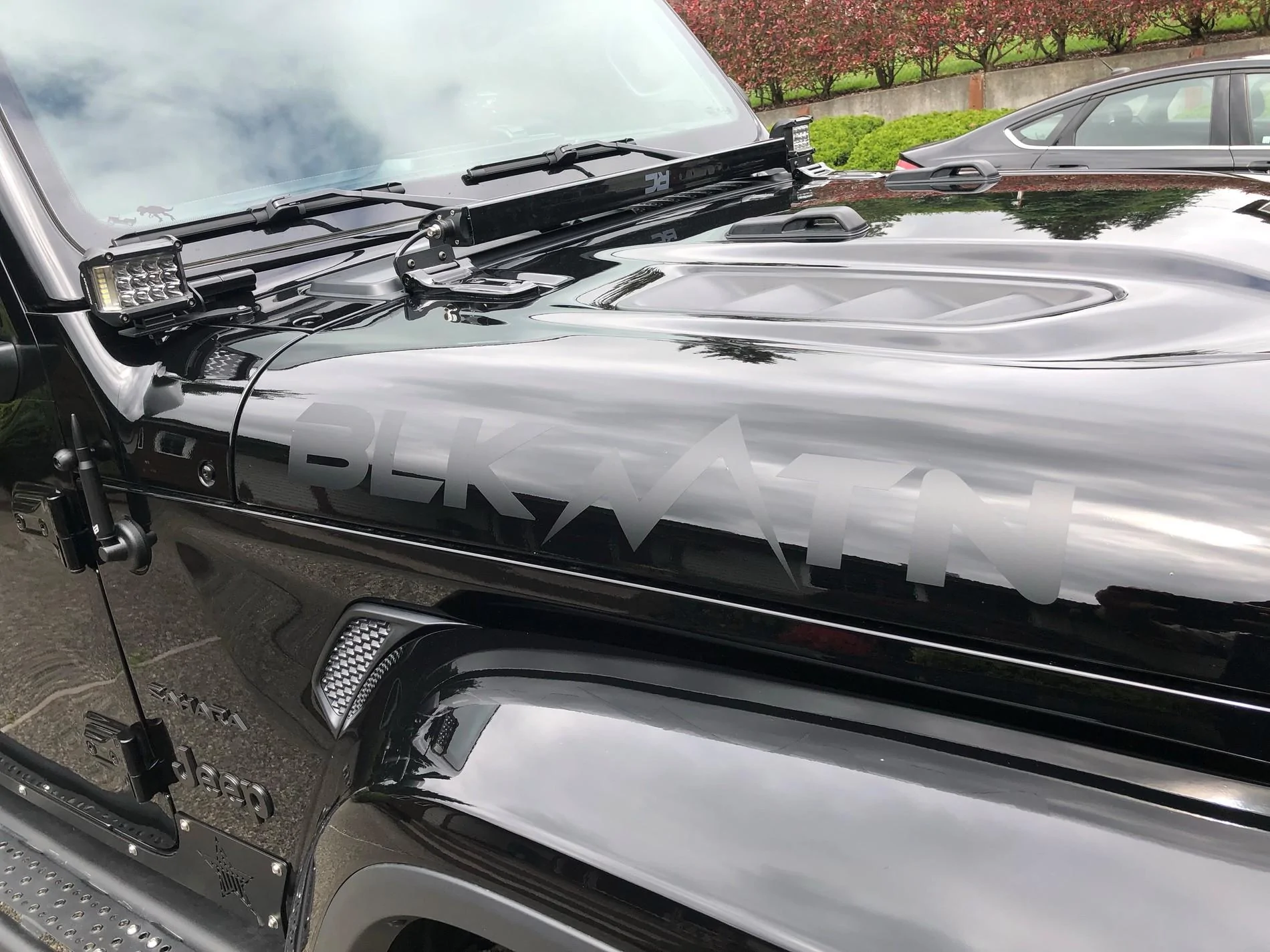

I went with the rough country mount and larger 4" cubes. I also have the 30" hood hing mount light bar as well. The RC mount gets the lights up and out to the side with a minimal bracket. To the OP I highly doubt any will vibrate.
For those considering Cubes and talking about the high priced Rigged Ridge DO NOT WASTE YOUR $$$, there are decent quality no name cubes for 1/4 the cost. Keep in mind how often you will use the cubes especially considering they are not legal for on road use. The only think I recommend on those no-name cubes is to caulk the lens to prevent moisture from getting in that is really their weak point.
For those that have pr plan to also add a light bar, make sure you get cubes with a side throw, as you do not need cubes forward if you have a light bar, however Cubes are more for the side lighting. I own a company that designs LED lighting (not off road LED) and these brands that charge an arm and a leg are simply opportunist there are great low cost options. I highly recommend the Rough Country LED's they have a great warranty and a good company backing them.
Lets face it for 99% of us the LED lights will be used at best a couple hours per year, they are more cosmetic than anything else. While many LED manufactures claim 50,000 life (which is pure BS) most of us will be lucky to use them 50 hours. Keep this in mind.

Looks great! May I ask what brand and color powdercoating you used? I tried to powder coat some parts here at a local shop and they tried a few colors, but nothing matched the Firecracker red color of the Jeep when they came out of the oven. They all looked terrible.
