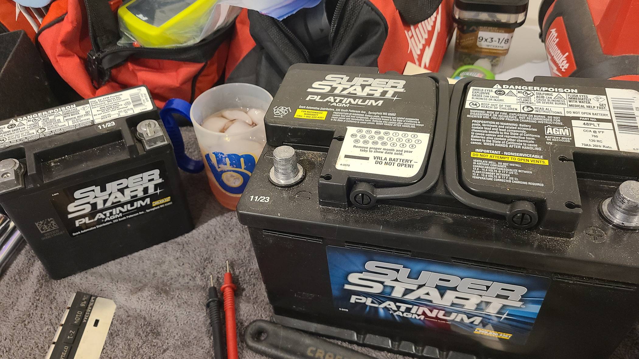

Voltage on both batts removed from vehicle read 12.38.
Will load test them tomorrow.
I also have the high amp fuse bar out and did a continuity check of two through seven and they all beep.
I find it funny that the dealership that replaced the aux battery (which on the invoice said it was a Mopar Xyz something something don't recall, but clearly it's not) just had an Oreilly's super start brought over from the store in town :(
The main battery was an Oreilly's I warrantied earlier in the summer. I don't have a problem with Oreilly's batteries because they have been great about the warranty, but maybe I should have a problem and they aren't good for this vehicle?
I'll take all suggestions - glad to be wrenching on this vehicle with the right facilities and a nice weekend to figure it out.

Bought my own load tester and a really good battery charger (15 amp for AGM)...Charged both main and aux battery to 100% over five hours...then load tested. Battery was showing in the "weak" (around ten volts) for a 500 CCA and this batt is supposed to do 760 CCA's.
Once again jumped it to start so I could get it back in the garage and sure enough it fired up.
Bottom line I'm going to warranty this Oreilly main battery, bet my money back, and do a Mopar or something better.
