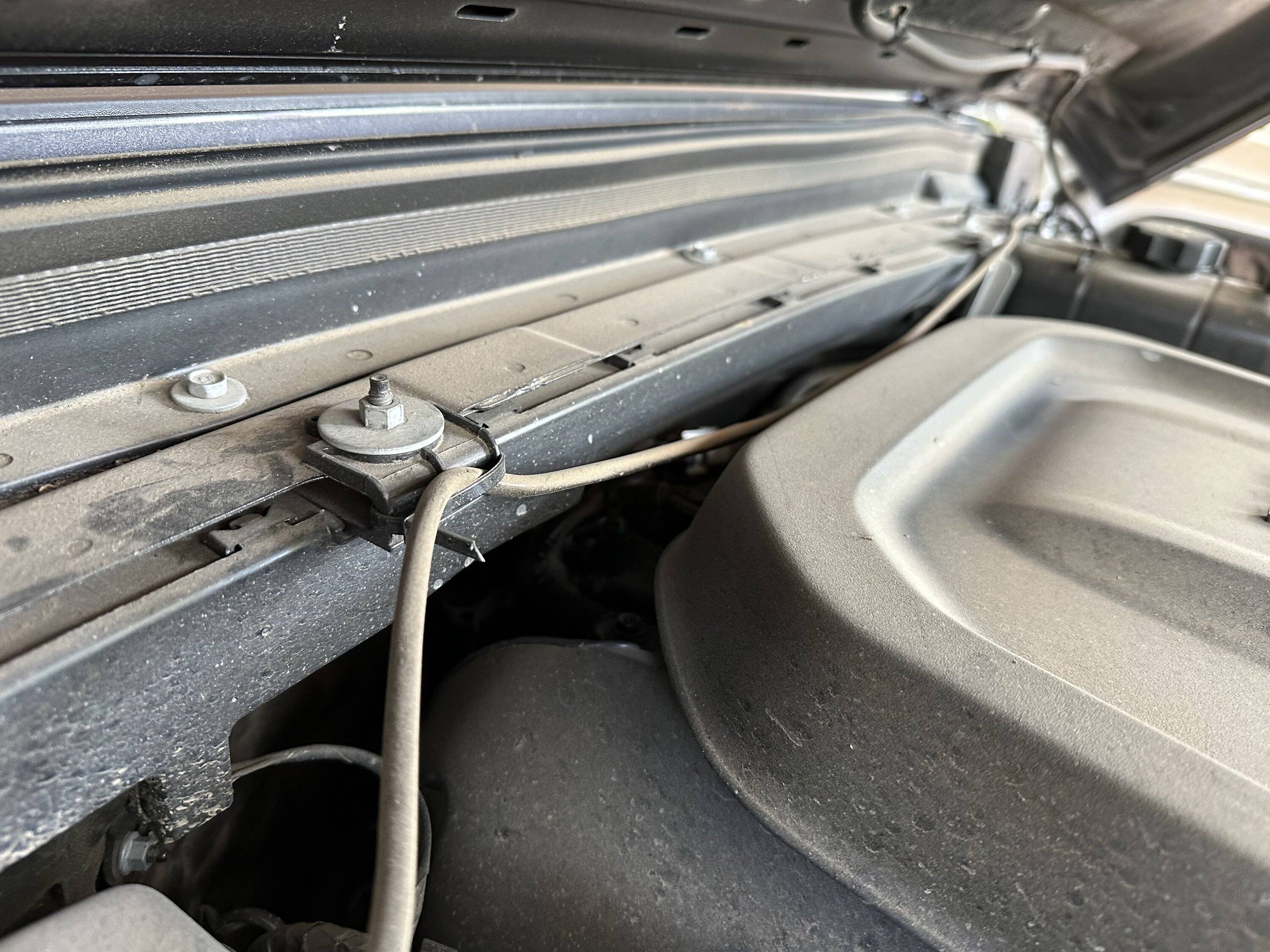

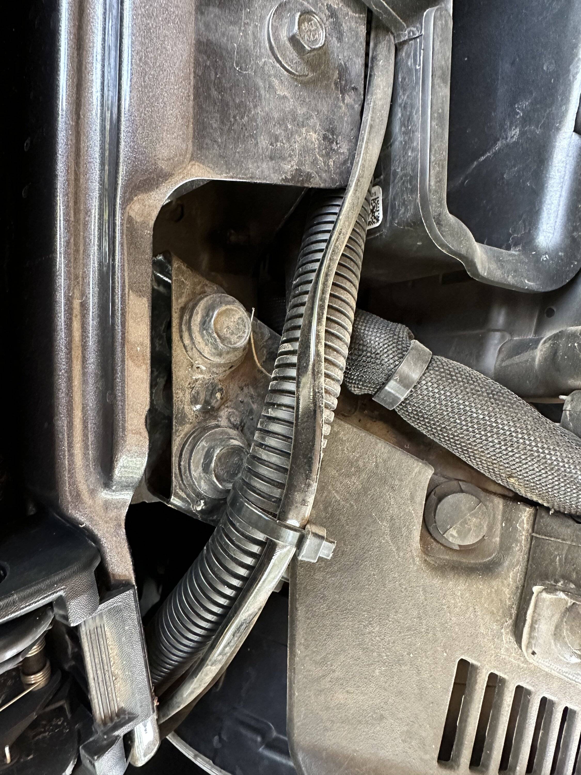

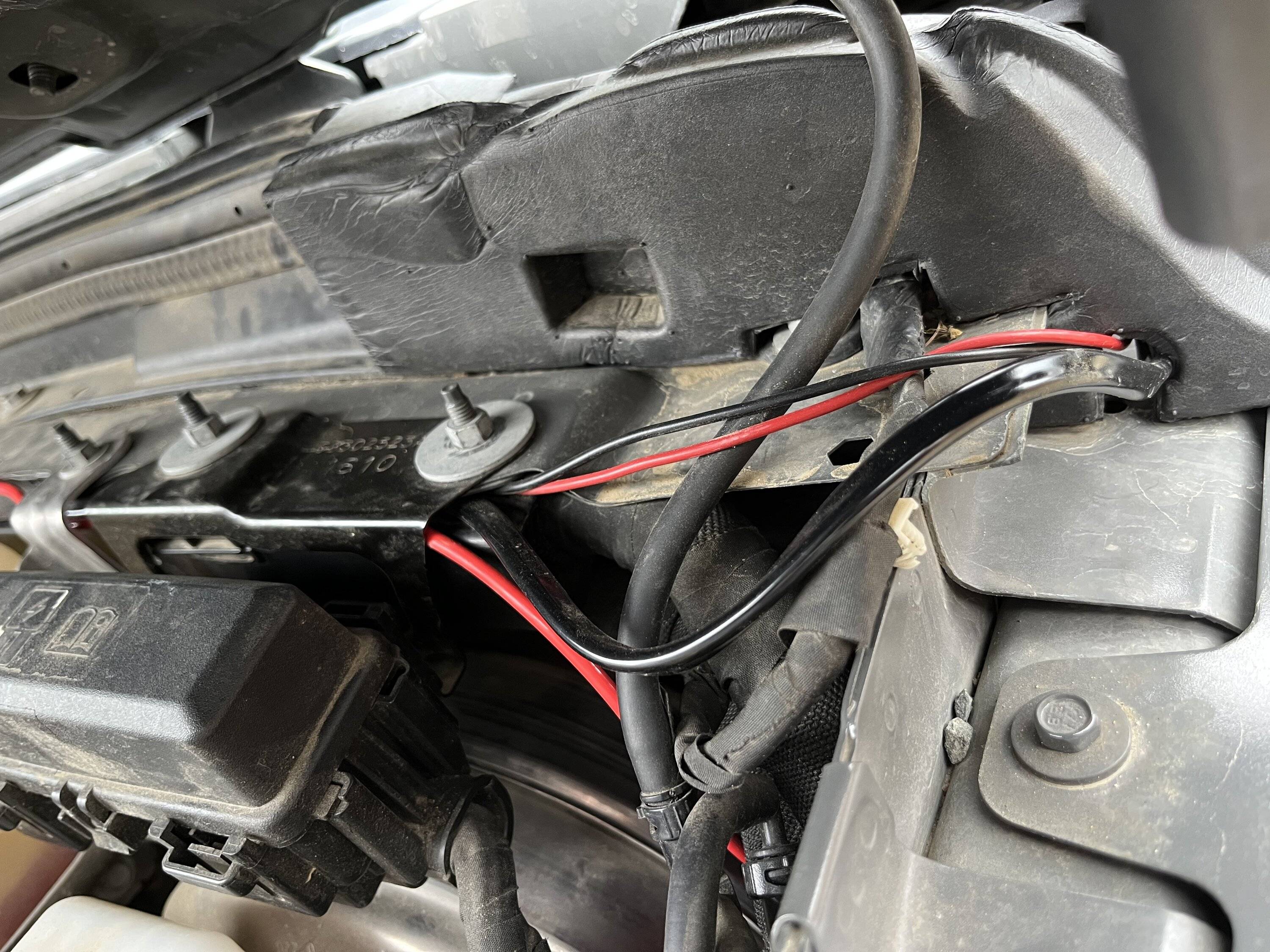

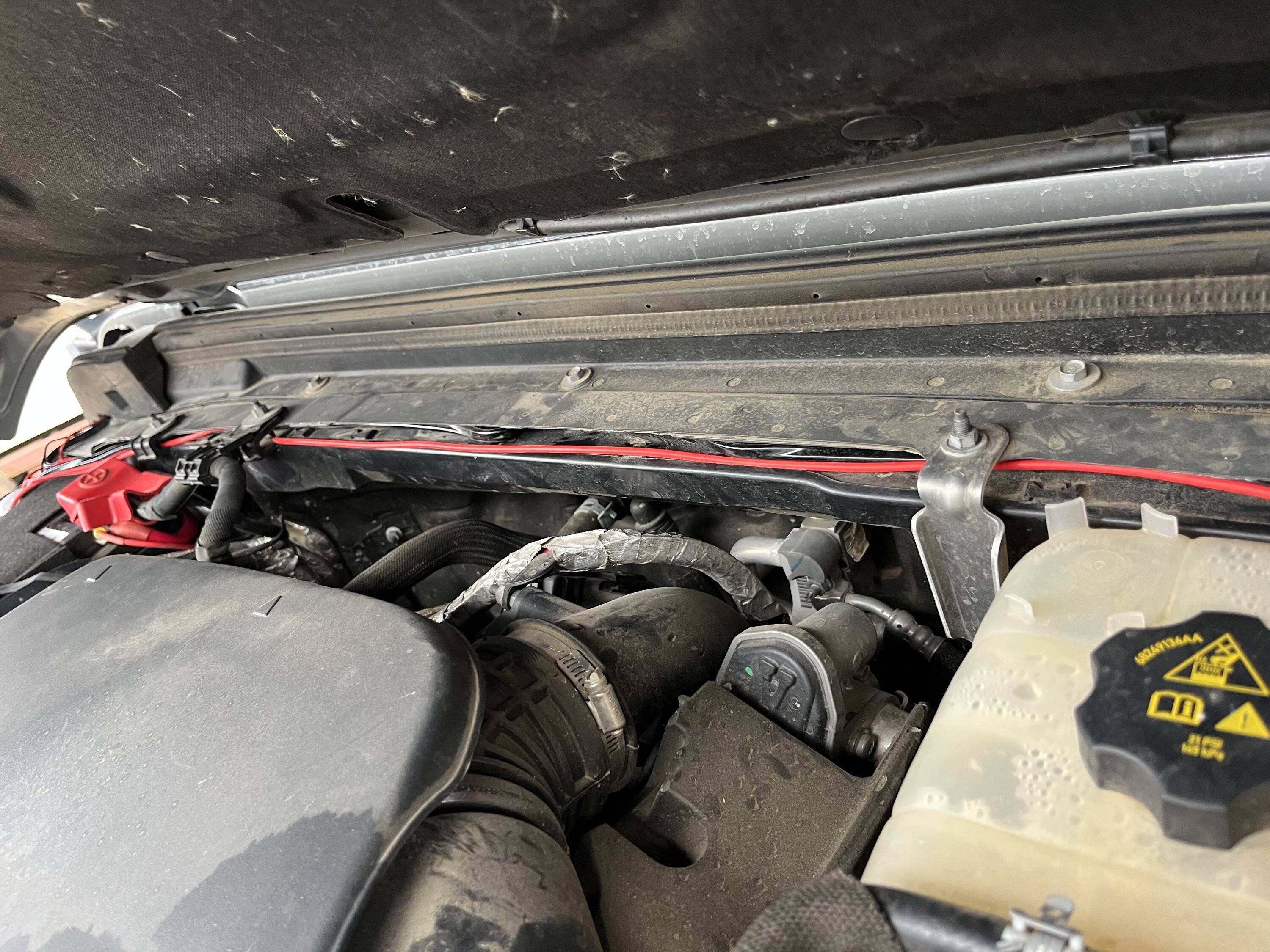

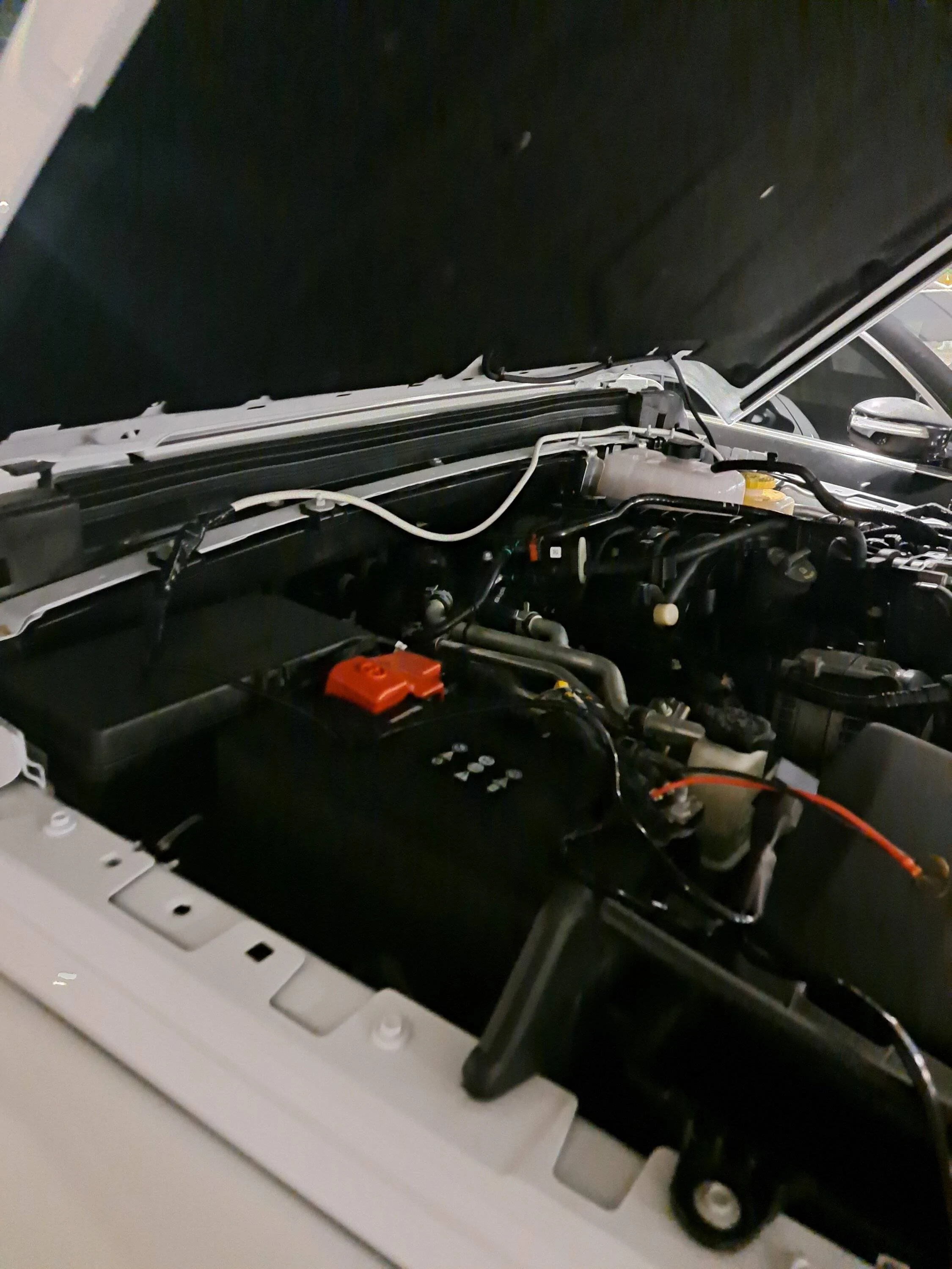

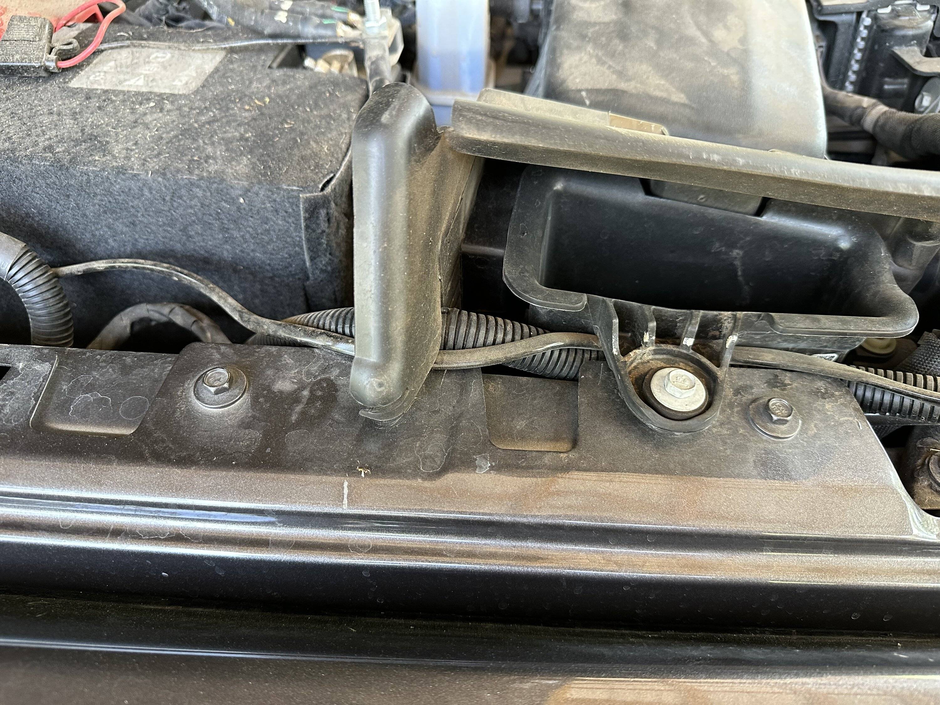

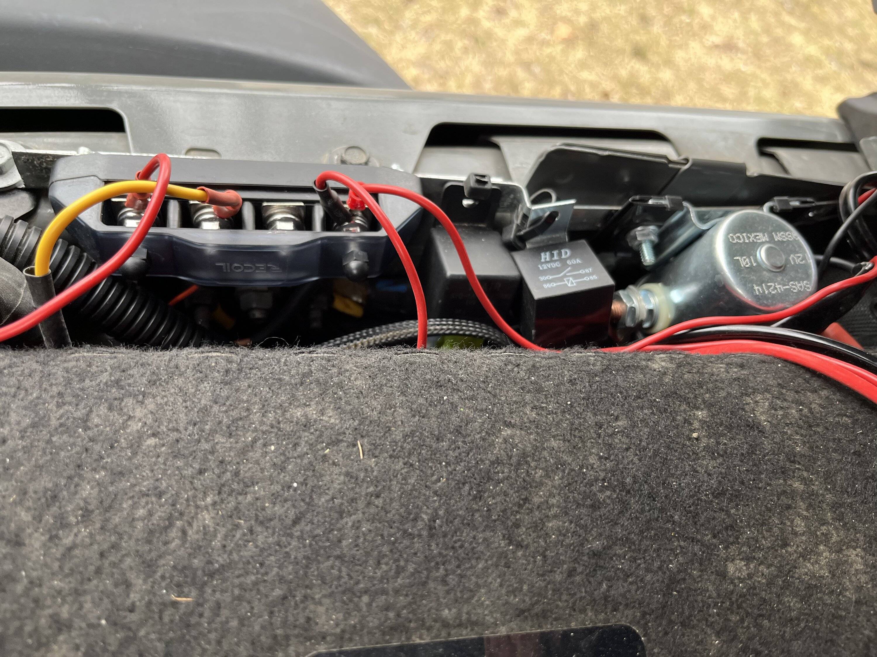

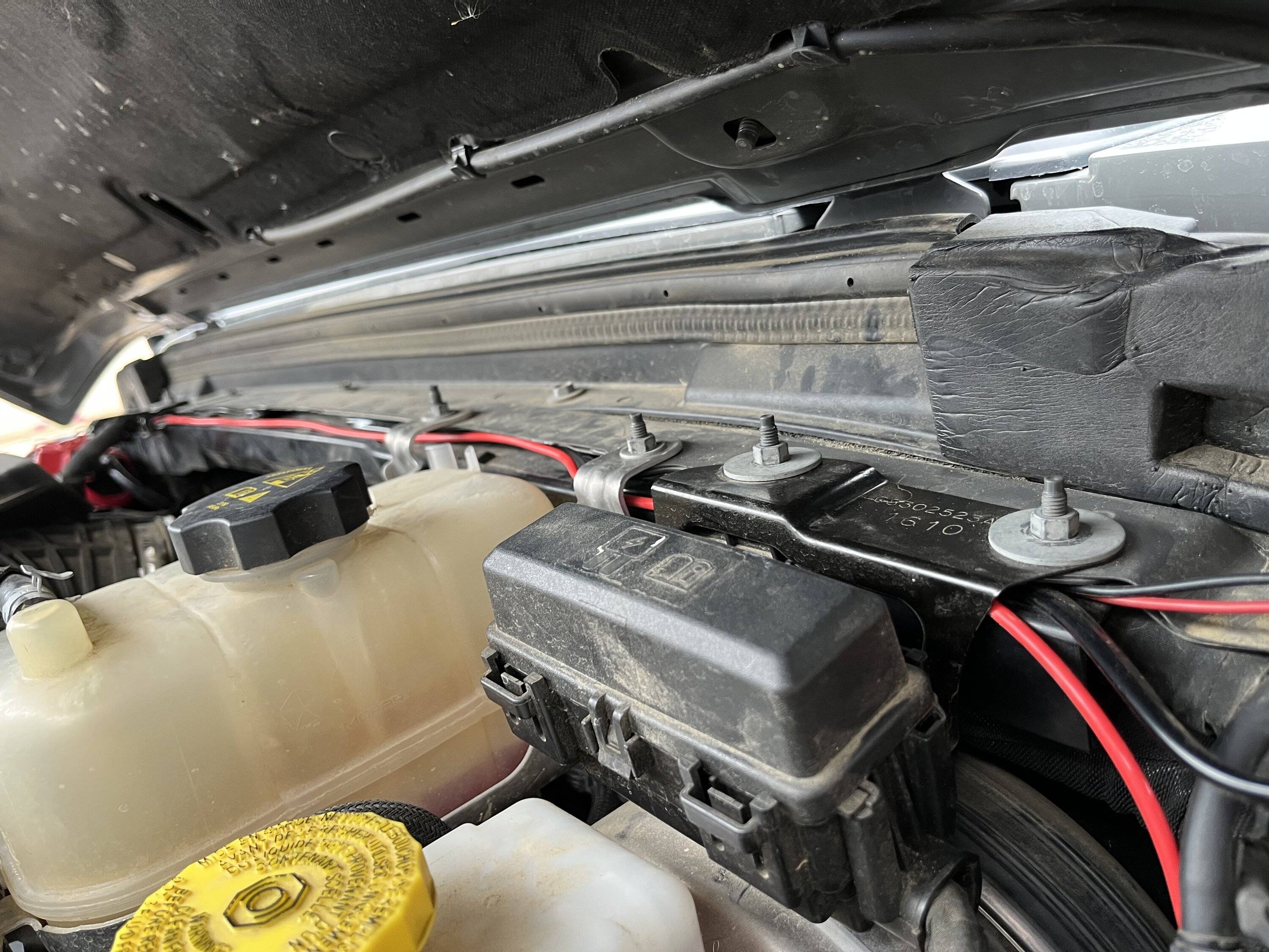

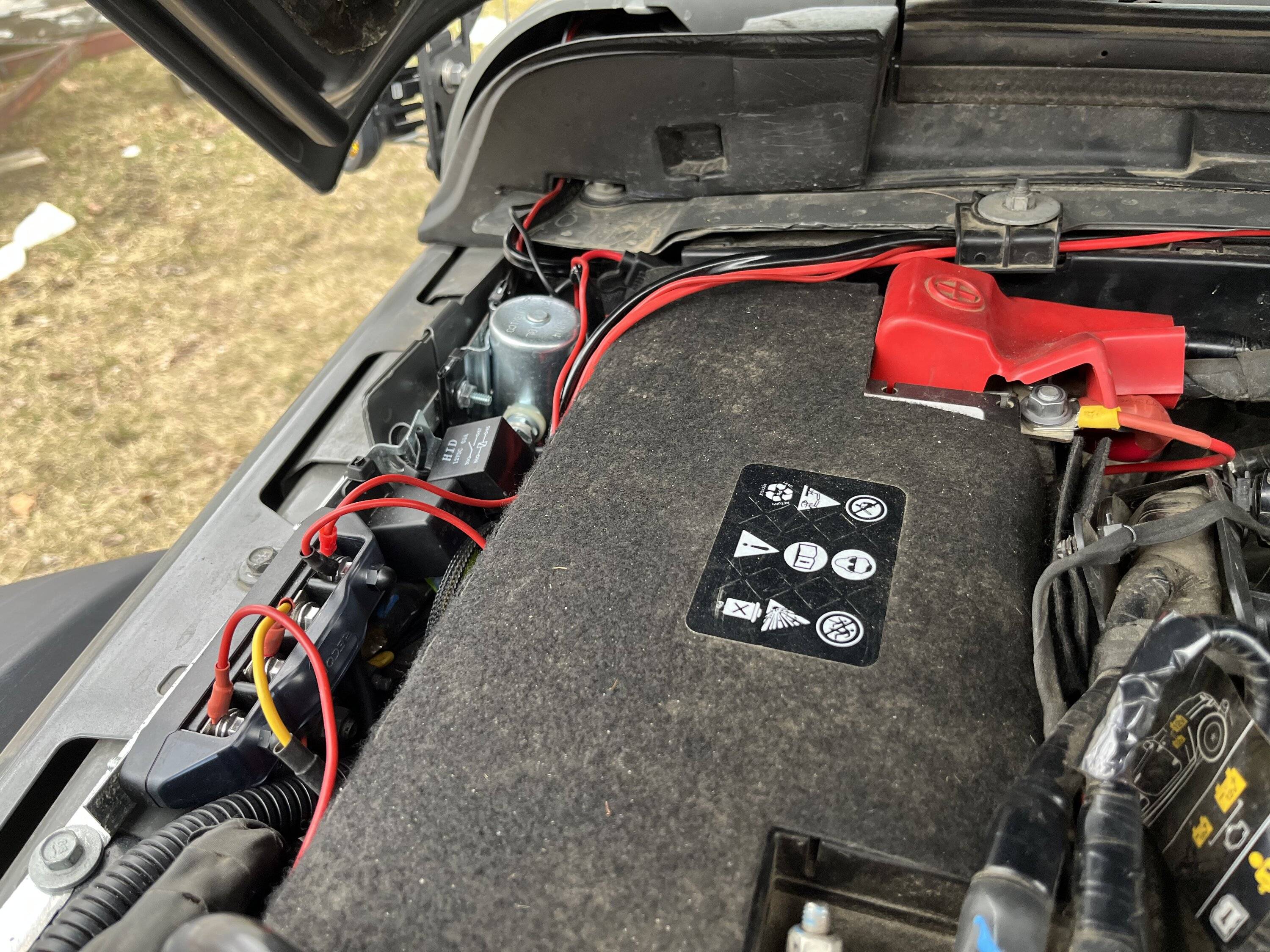

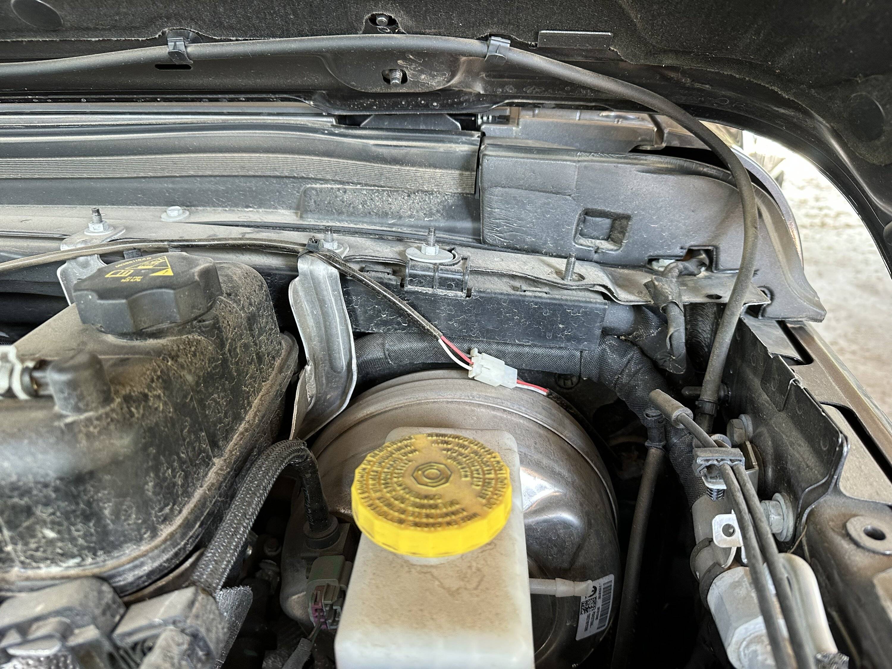

This is how I ran mine. The relay you will see along the back of the engine compartment.

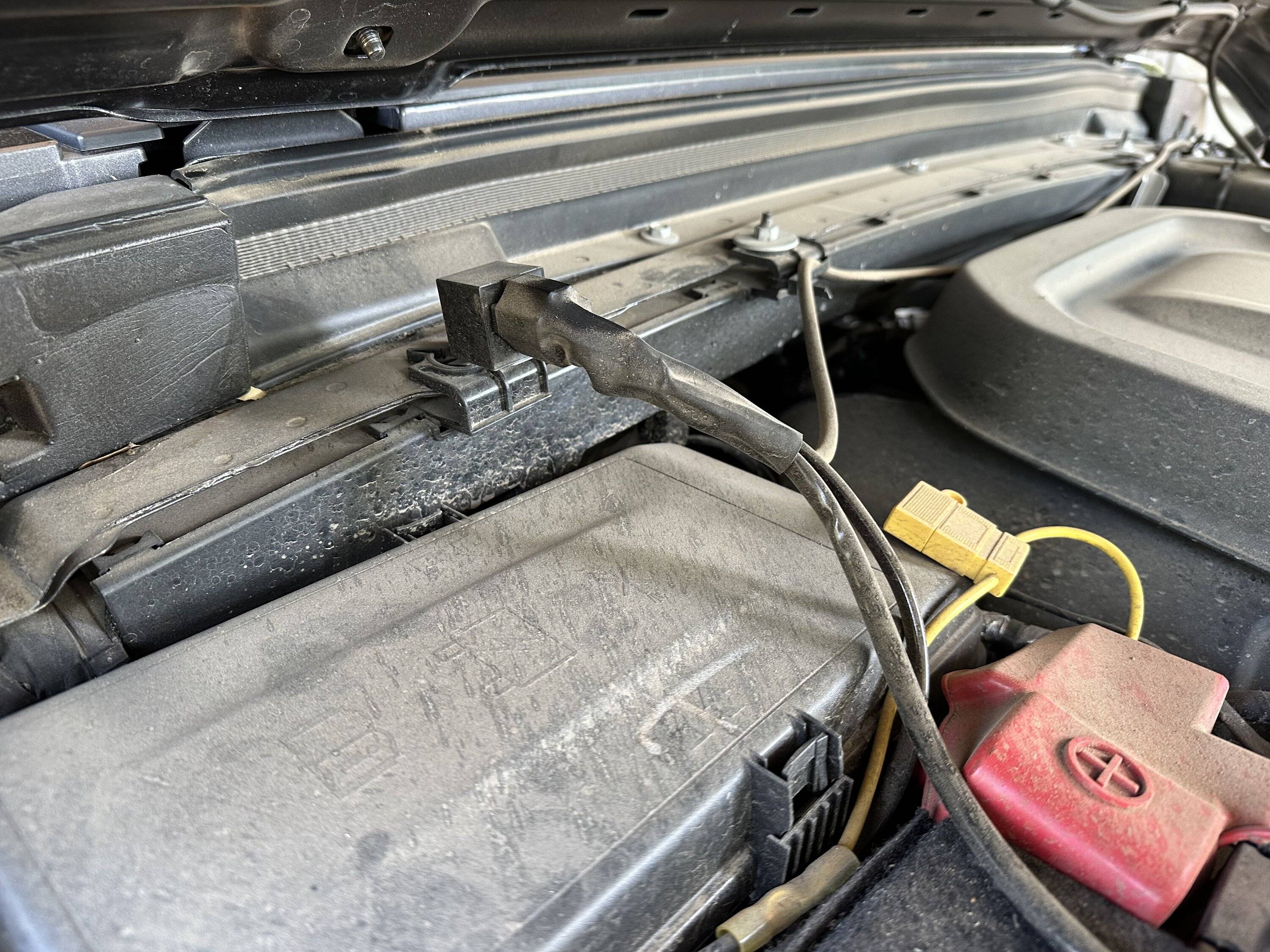

I’ve tried to run all my wires next to the plastic wiring tray. I set up my relays and solenoid near my bus bar that I’ve hooked up to make swapping aux switch positions easier as I go.
