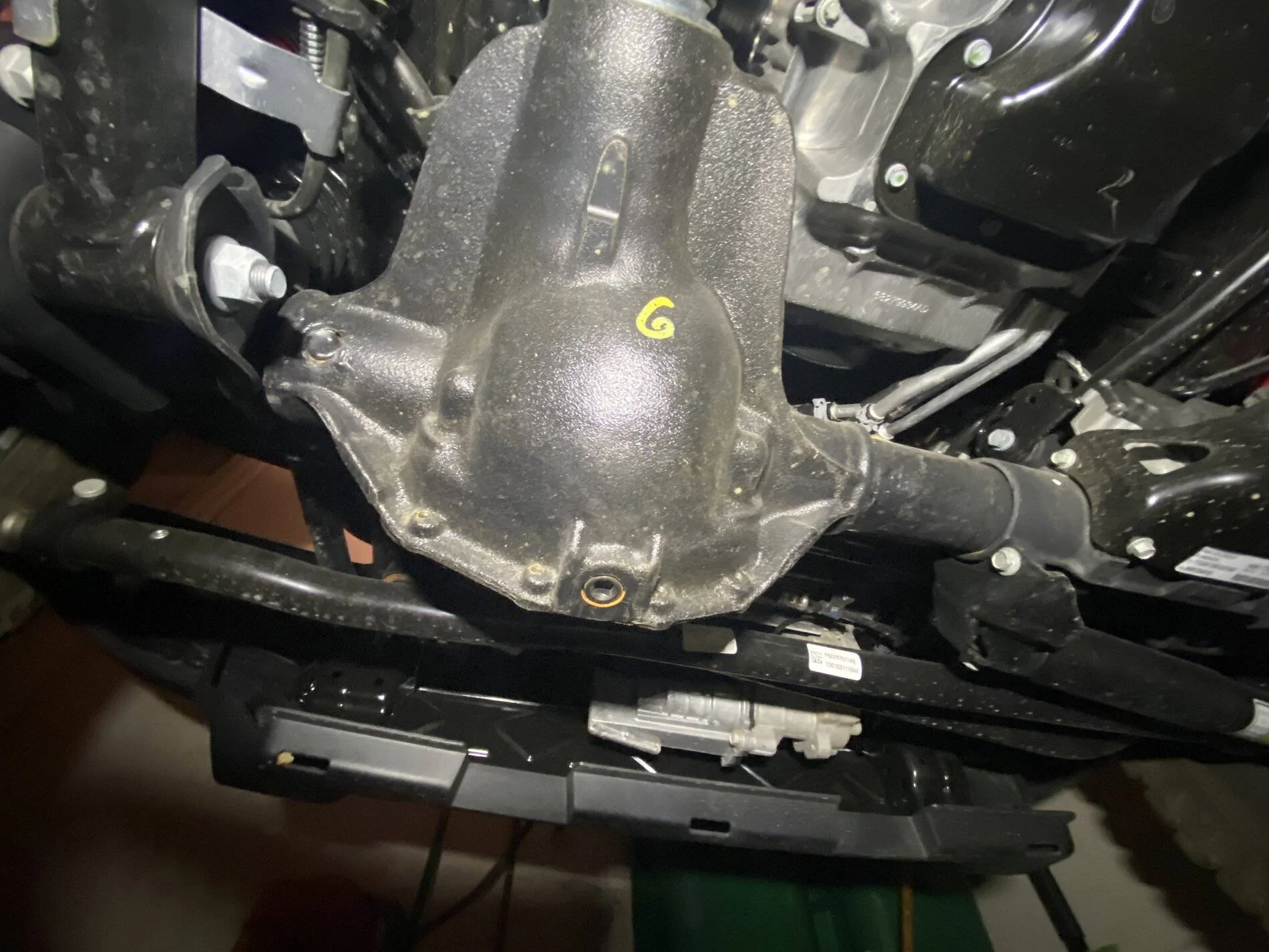

Nope. Another XR owner who recently took delivery is also seeing the same situation. I wonder if they are using a different part. Gonna be a PIA to change diff fluid.
At least it’s just the front. When I changed both of my diffs at 40,000 the front oil still looked brand new. And I use my 4wd fairly often. I could probably get away with doing the front every other time I do the rear.

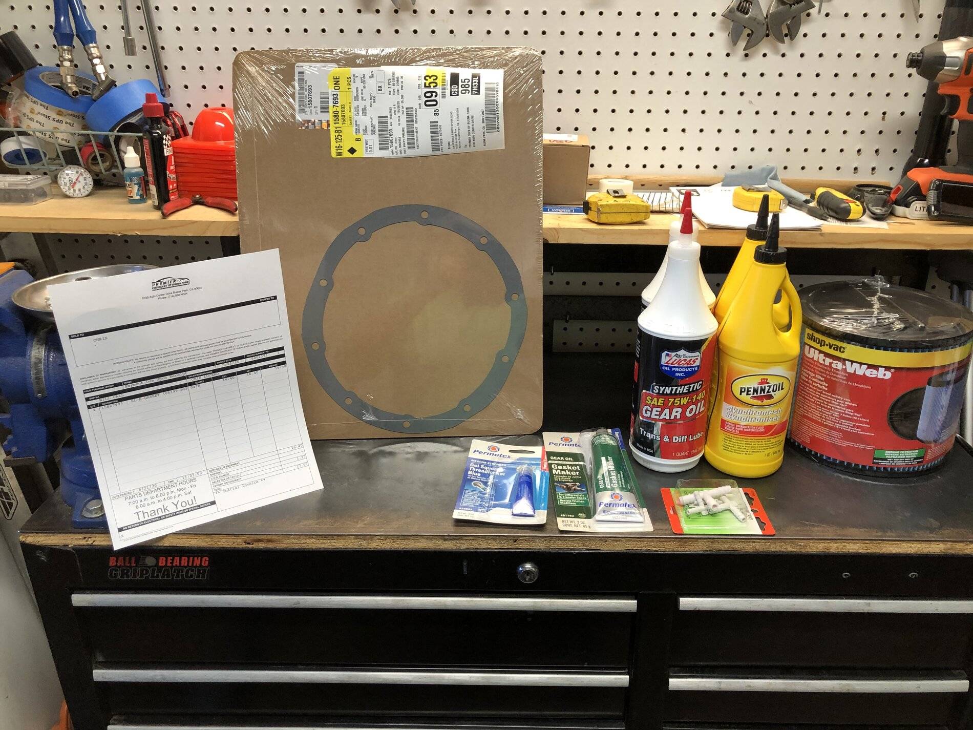

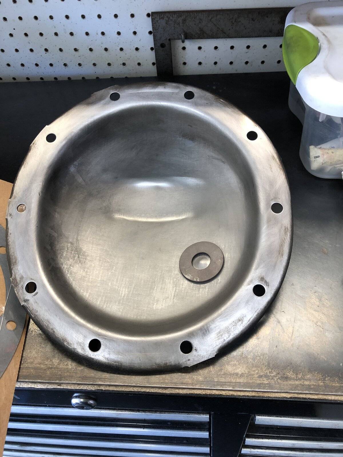

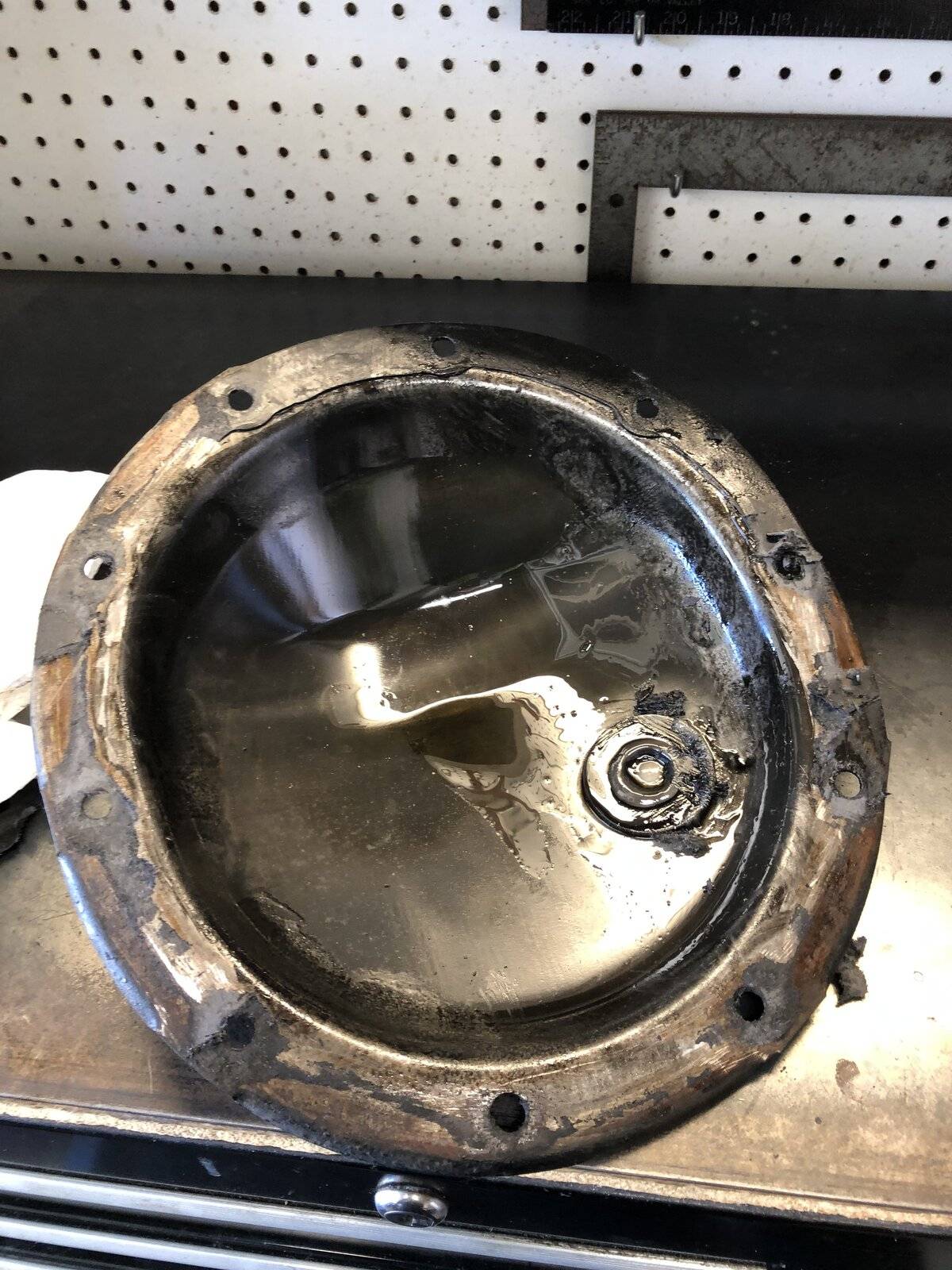

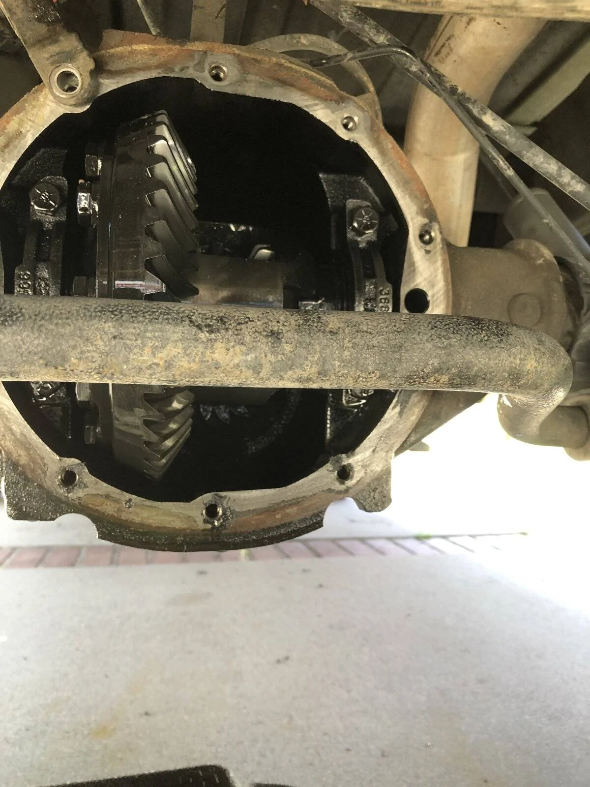

The cover should always be removed when changing diff fluid. It gives you a chance to clean and inspect components for wear and damage. It is not hard at all. 30 minutes tops to service provided components are within specs.
To make it easy on yourself always replace the cover gasket. It makes future service much simpler with less scraping. If you use silicone go real light so as not to get any into the cavity.
