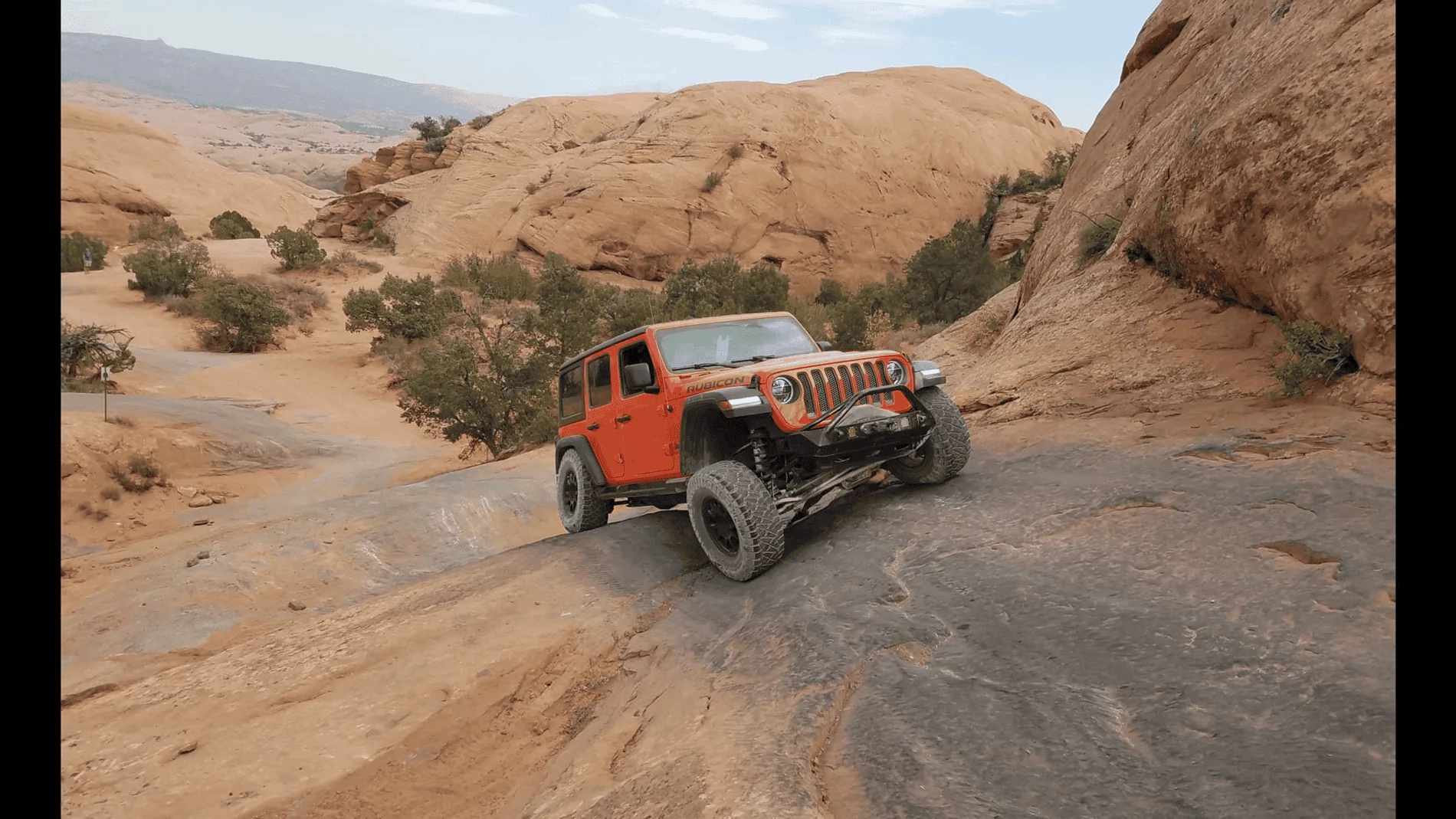

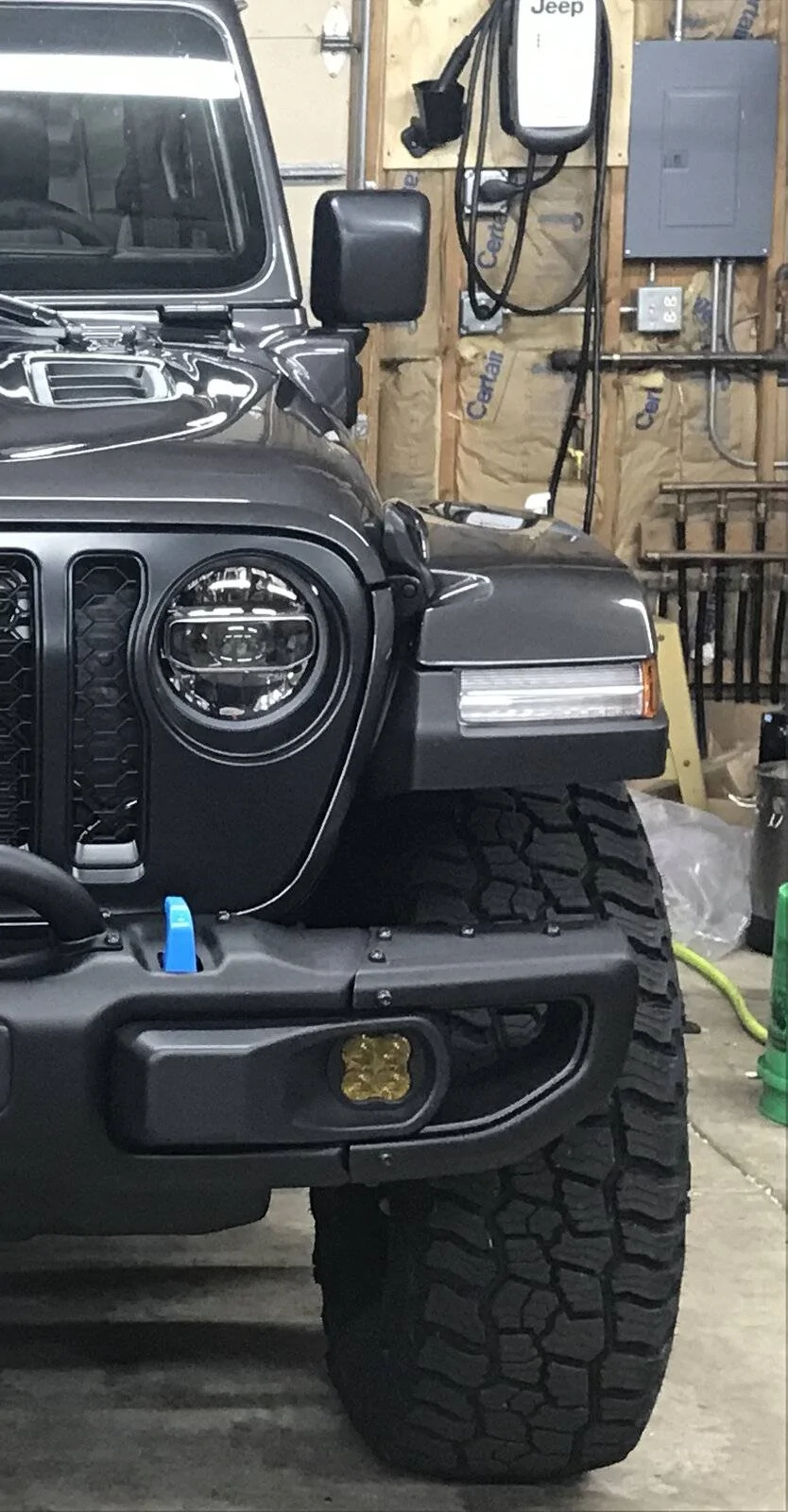

My Method MR702s were 0 offset. I loved them as far as looks etc. they tucked very well with 35" tires. (I ran them with and without a lift with no issues.)

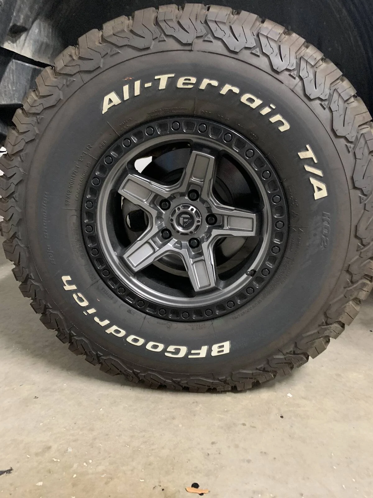

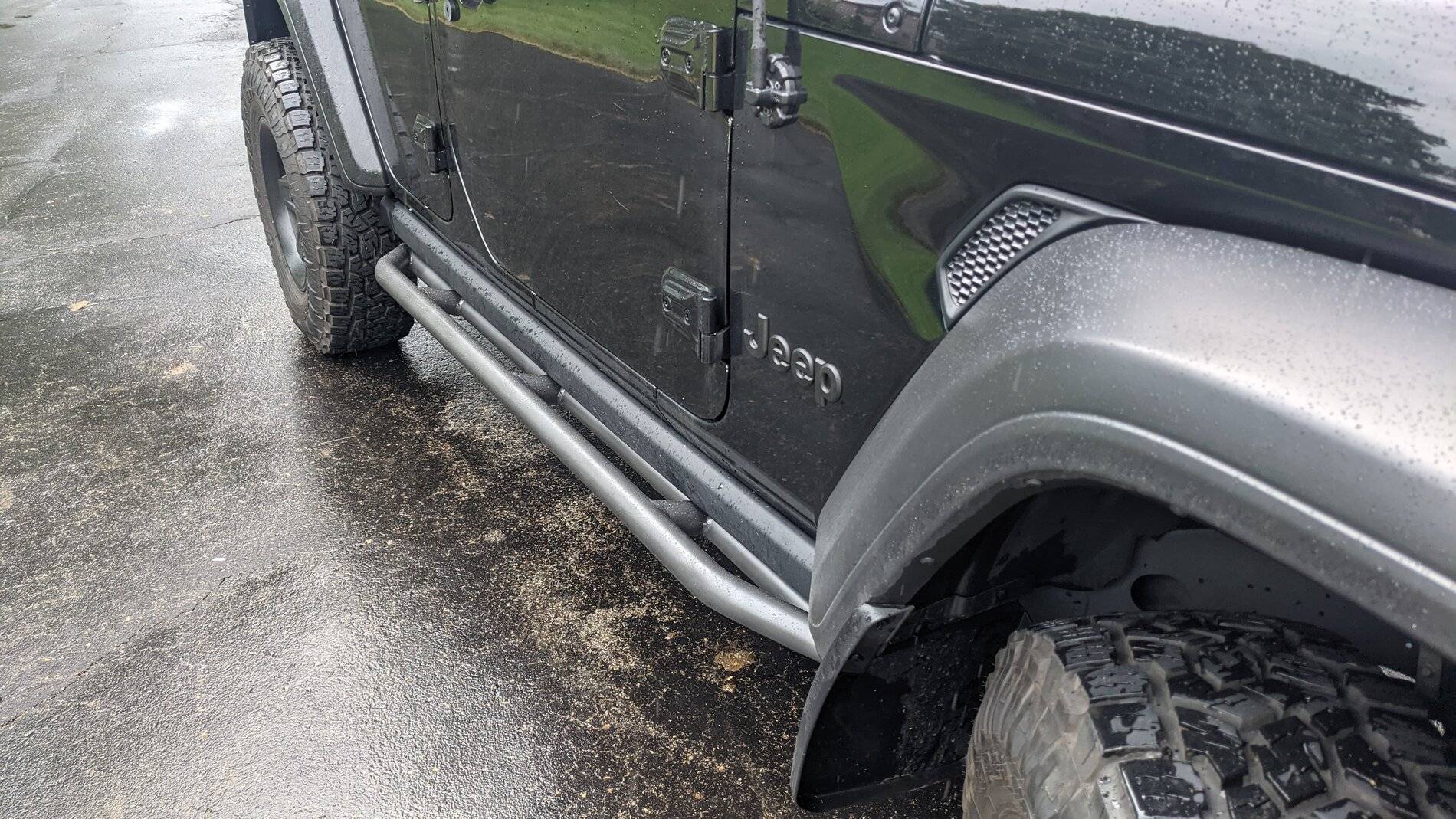

I run AEV Pintlers with 0.75" wheel spacers. 285/75/17 Toyo AT3's - they stick out maybe 1.5"
