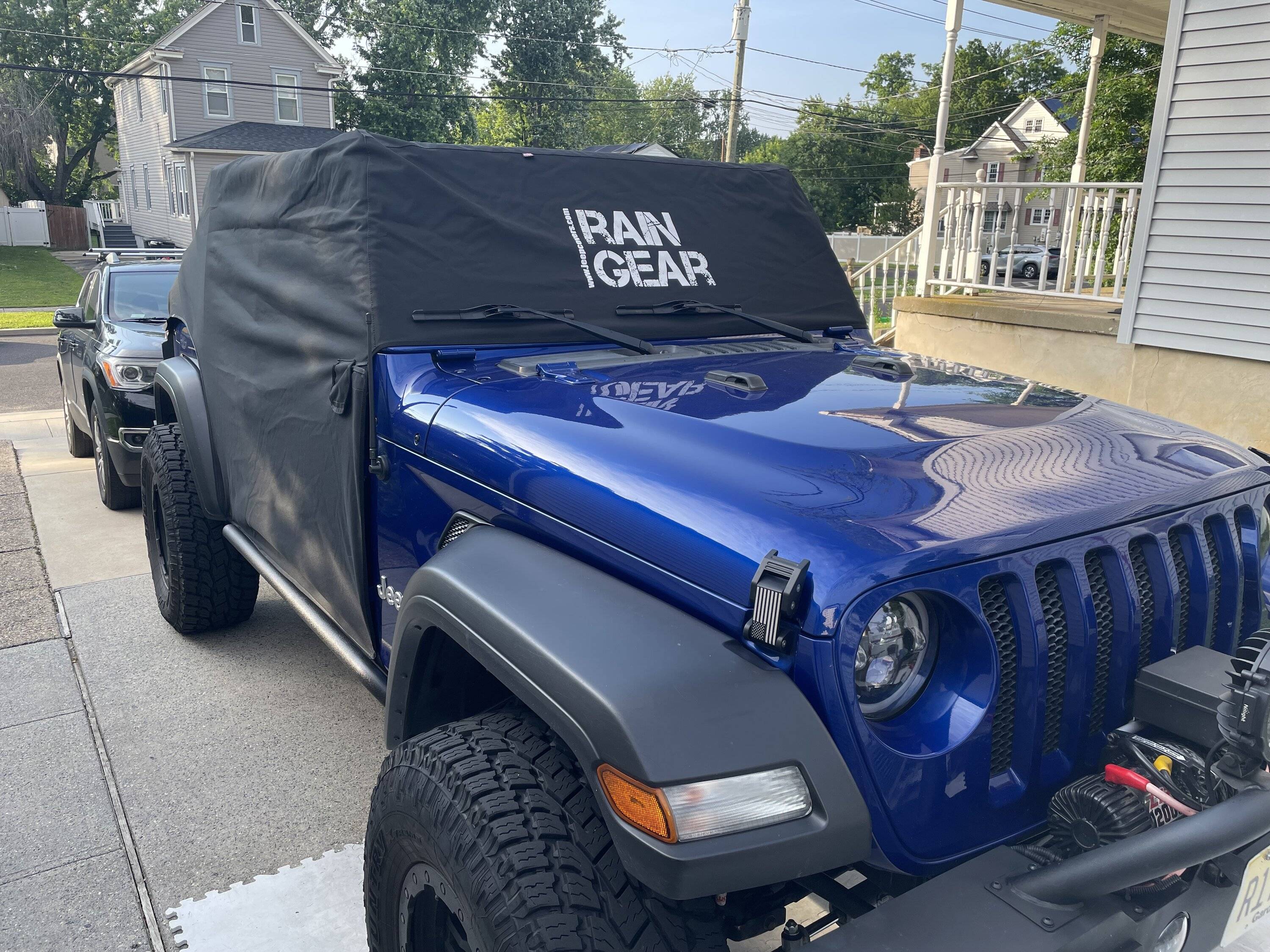

Looking at those wheels on Black Rhino website they are only available in a 17x8.5 -18 offset. You are going to have alot of poke. Here is a 17x9.5 -18 with a 35" tire on a 12.5 wide. you will have about 1/2" less poke.

Good point that I didn’t think about. I did add rubi fenders to my sport and the fenders cover a little bit more of the tire. If it quits raining today I’ll take a pic of how it looks now.
