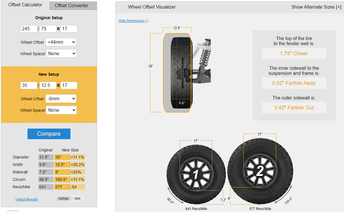

I have a 2033 Wrangler Sport with stock 17-in wheels and 356/75/17 tires. I want to upgrade to a 35-in tire with compatible 17 inch wheel. I'm adding a 2 1/2 inch lift and looking at 17x9 wheel set with a -6 offset paired with 35" x 12.5" tires. Is this enough wheel offset with the lift to avoid rubbing? Are wheel spacers needed?

If your 356/75r17 ( 38"x14" )is what you are Running now on the stock rim( I hope not) with no Wheel spacers the new setup will be farther away from the suspension. if your Jeep is still stock with 245/75R17's your proposed setup should be good you can play around here with different sizes and offsets with or without spacers.
