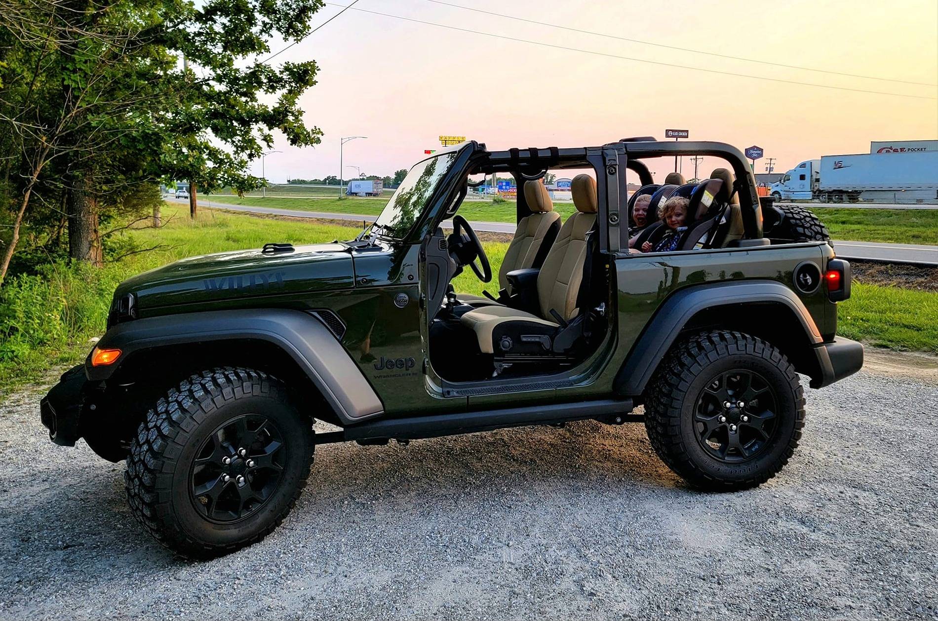

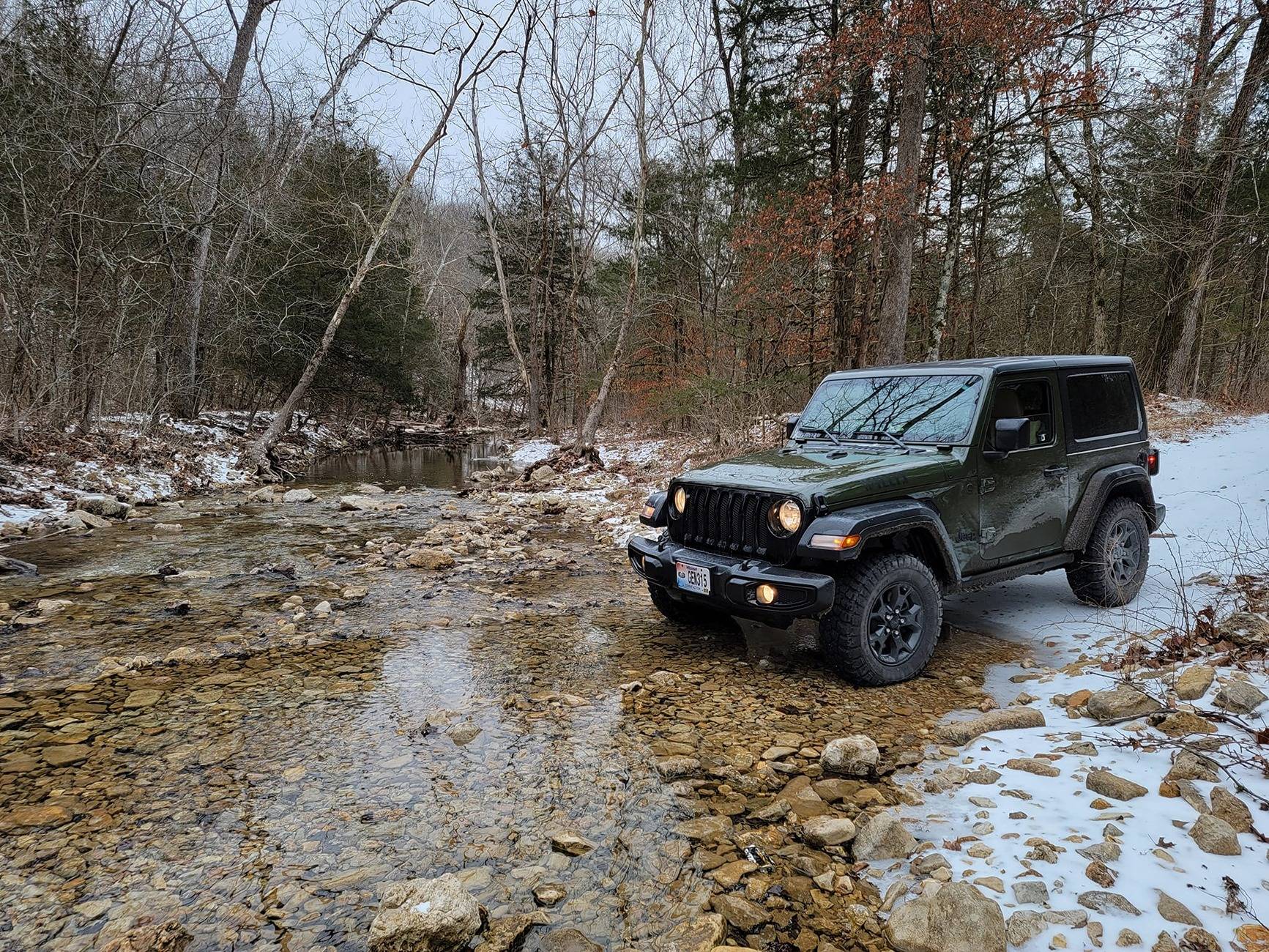

I have a 2023 Willys Sport 2-Door and I am just about ready to be in need of tires at almost 36k miles. The stock 32" BFG KM2 tires have been great, but now that the need is there to replace, I'm wanting to step up to 315/70R17s. I found 315/70R17 Goodyear Territory MTs for $207 per tire at Walmart, which to me sounds like a steal for 35s. I'm planning on going with the AEV 2" Spacer lift with the Pro-Cal SNAP for speedo recalibration. I am wanting to keep the stock Willys MOAB wheels because I really like the look of them. Here are my three questions:
1.) Will I need wheel spacers to keep from rubbing the lower control arms? If so, what size do you think I will need to clear?
2.) Since 315/70R17s are technically wide 34s, will I need to reinforce the spare tire carrier and swing gate hinges immediately, or can I get by without that for a while?
3.) Will 315s clear the stock plastic bumper without a spare tire relocation bracket?

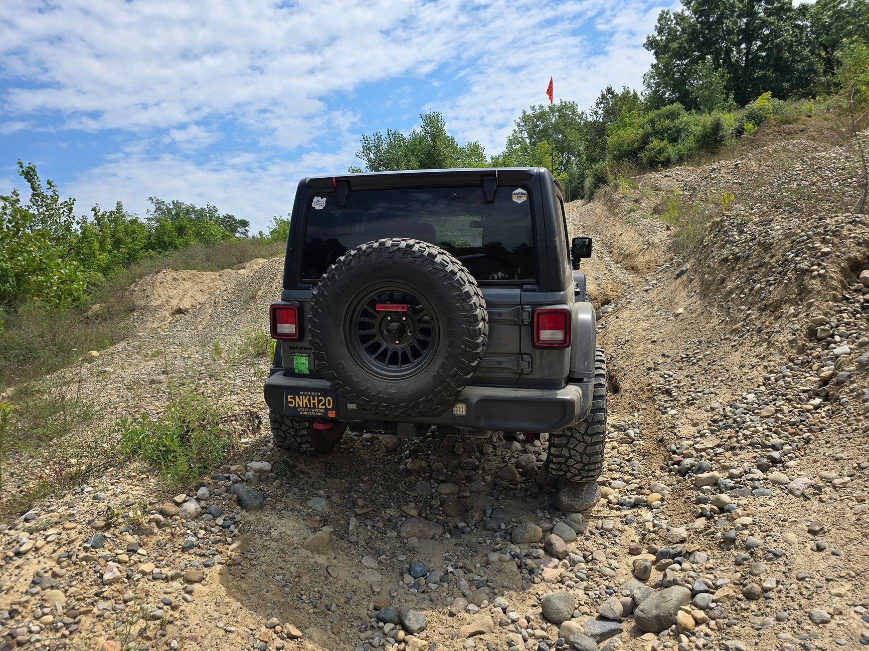

I had 35" tires that fit the spare tire carrier, however they were mounted on 17x9 wheels with 4.5" of backspace... not sure how that affects anything, and they were a snug fit (rubbed the plastic bumper a smidge).
tire dependent too.. some run taller and mine rubbed a lot before i ponied up for a relocation bracket from teraflex.. some $150 bucks thing.

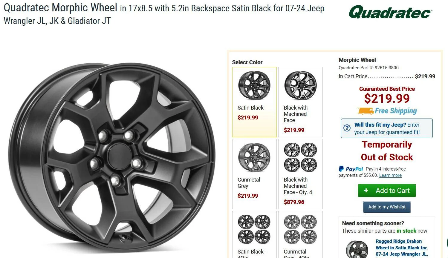

Thanks for your reply. So, 1.5-1.75" spacers will be needed to use stock wheels. Check.

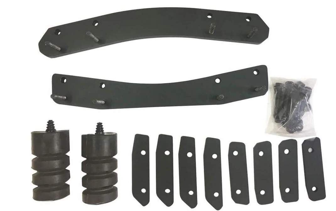

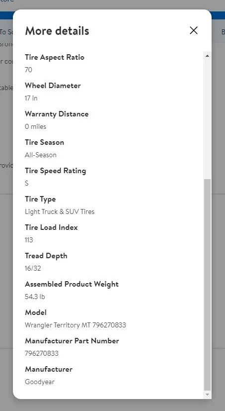

Since the stock Willys wheels are 21Lbs, and the tire weight is 54.3Lbs, for a total of 75.3Lbs, then I won't need the tailgate reinforcement, but I will need a spare tire relocation bracket. Correct me if I'm wrong on anything. I want to do this right so I'm not tearing things up prematurely.
yeah you wont need reinforcement. I'd say put it on as is.. if it doesnt fit at all OR if it rubs so much that its not a forever solution - then get one of these
https://teraflex.com/jl-spare-tire-relocation-bracket-kit.html

Yeah I suppose there are a few variables. I also got the Teraflex Alpha HD spare relocation to pull the new wheels closer to the Wrangler. I thought it was interesting how their instruction manual says that no hinge reinforcement is needed unless the spare is over 100 pounds.
I was only talking about the cheaper relocation bracket..
Teraflex Alpha is super expensive and not needed at all for a 70lb combo from OP
