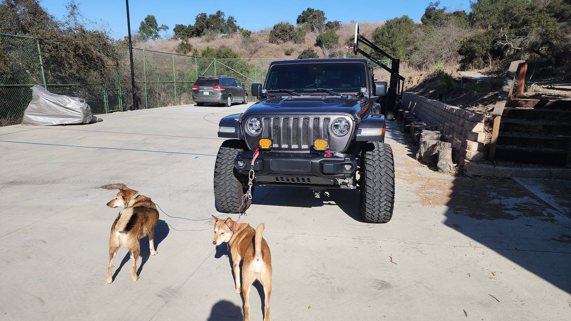

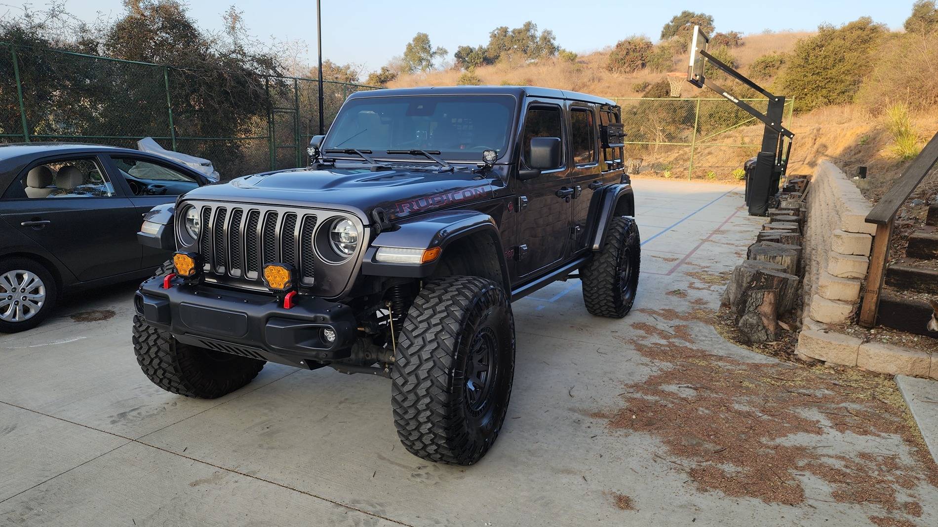

Didn't want to start a new thread.
Should I get wheel spacers or not?
They stick out a few inches, but sometimes when I'm walking to work and I look back, I wonder if another 2" would look better. I'm torn, so figure I'd ask here.

I think it looks good now but that's subjective.
If I have to guess your current offset is about -12mm? 4.75" ish back spacing?
For most after market wheels, the minimum adaptor you can add is 1.75". If you are really going after the look, it not ideal but I don't see why not, as long as the adaptors are good quality and properly installed/routinely checked.

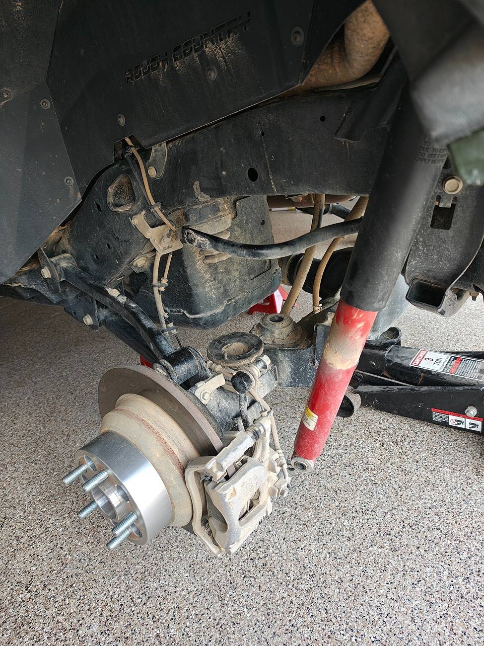

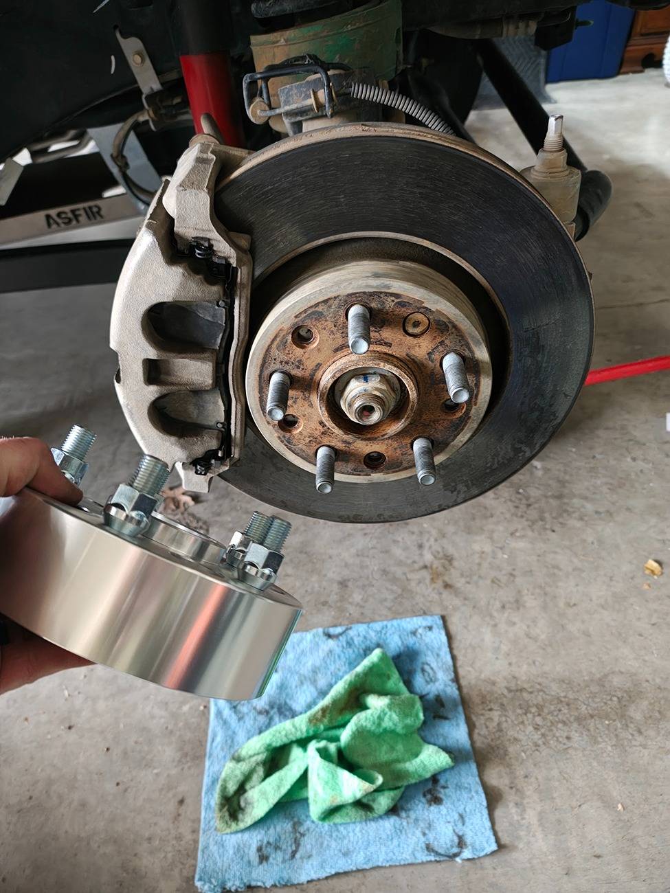

I went with 2-in rough country wheel spacers purely for aesthetics.

The poke looks good if you ask me. Just do yourself a favor and get yourself an alignment if you do install these. My Jeep was tracking true for 3 years straight, put on some 2 in wheel spacers and all the sudden it pulls hard to the right at any speed over 40 mph. 😣
