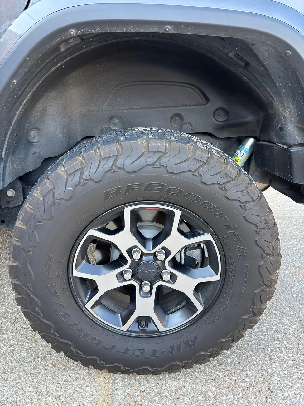

2019 JLUR on a MC GC 2.5 inch lift. This is MT BB AT 35s on stock Rubicon rims. No poke. They did rub a little at full lock.

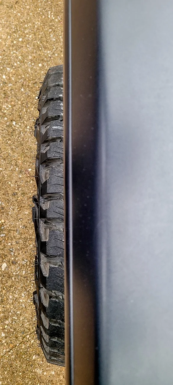

This is the same MT BB AT 35s on Method 703 bead locks at 0mm offset. Just a little poke. Zero rubbing at full lock.
Jeep Wrangler JL Wheel offsets 20250212_094651
Jeep Wrangler JL Wheel offsets 20250212_094641

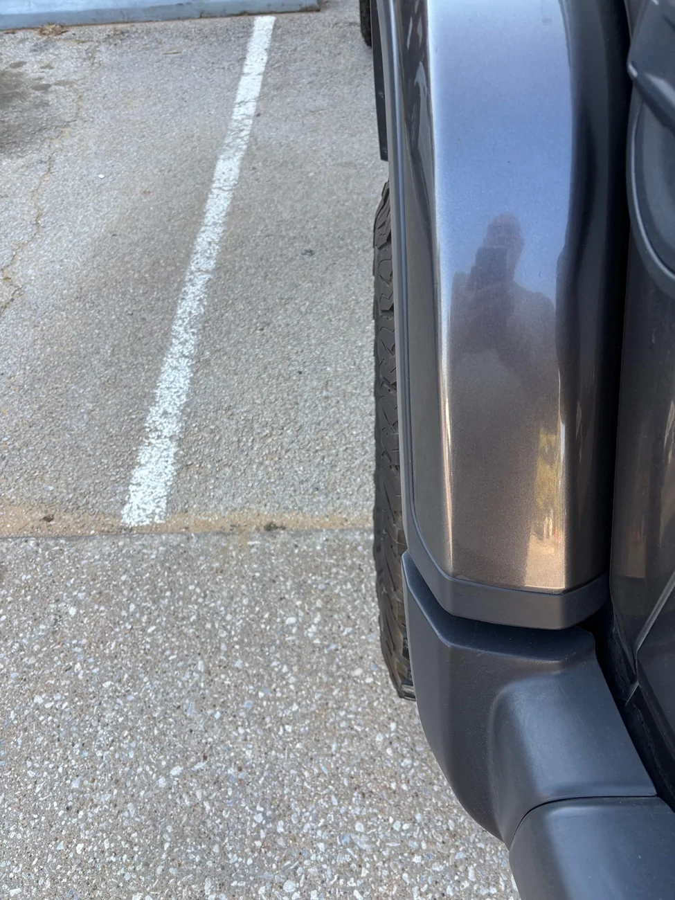

Depending what local laws are youd have to decide on how wide you can go. With 37s you have to go wider . Aprox -18 offset to clear the front skid plate . Which still requires a hammer adjustment to make clearance. Smaller tires would be fine with 0 to -12 offset. ( zero to half inch from center. ). I have a stock set of the rare hutchinson beadlocks with stock offset and. Have to use a 1.25” wheel spacer to get them to clear. They stick out same amount as my other jeep which has -18mm offset (3/4” ) from center . I added the mopar flares to stay legal ish .
