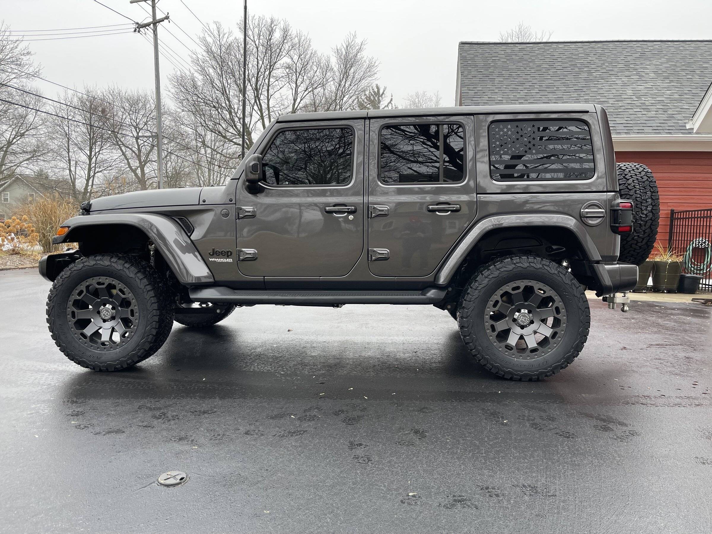

I ended up getting a set of Black Rhino wheels and putting 35" K02's on them after installing a 3 1/2" Teraflex lift. with Falcon SP2. I stayed with the 20" inch wheel because I like the look and with 35's there is quite a bit more sidewall, not enough to really rock crawl, but this is not my intention. As far as using the stock rims with 35's, I don't think it will work because the stock rims have a big offset that pulls the wheel in. Might be able to get away with it if you use spacers, but I am not 100% sure.
