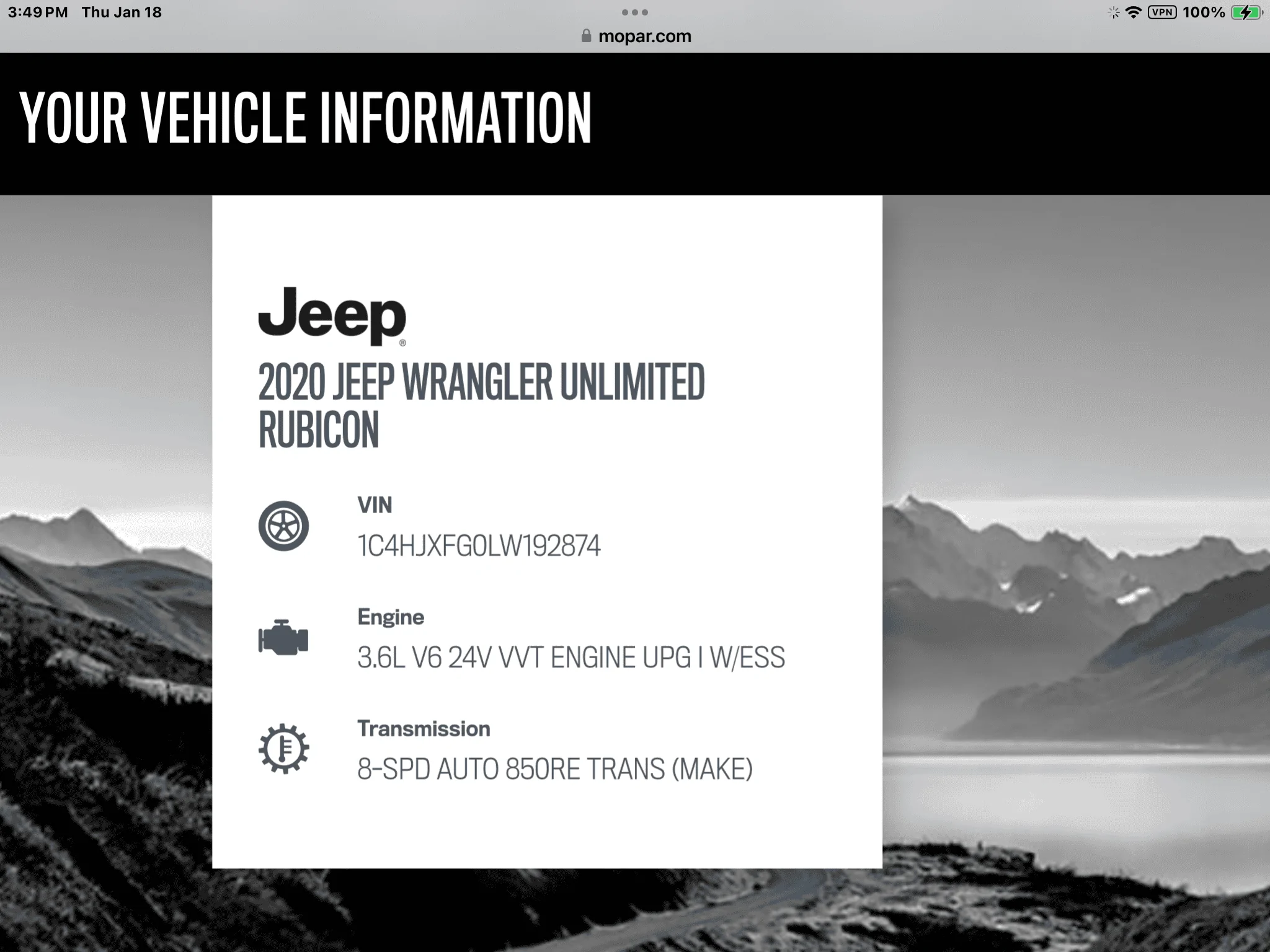

So the window sticker in your post is not etorque. An example of a window sticker with etorque is below.
Jeep Wrangler JL What years get etorque for which motor? IMG_0656
