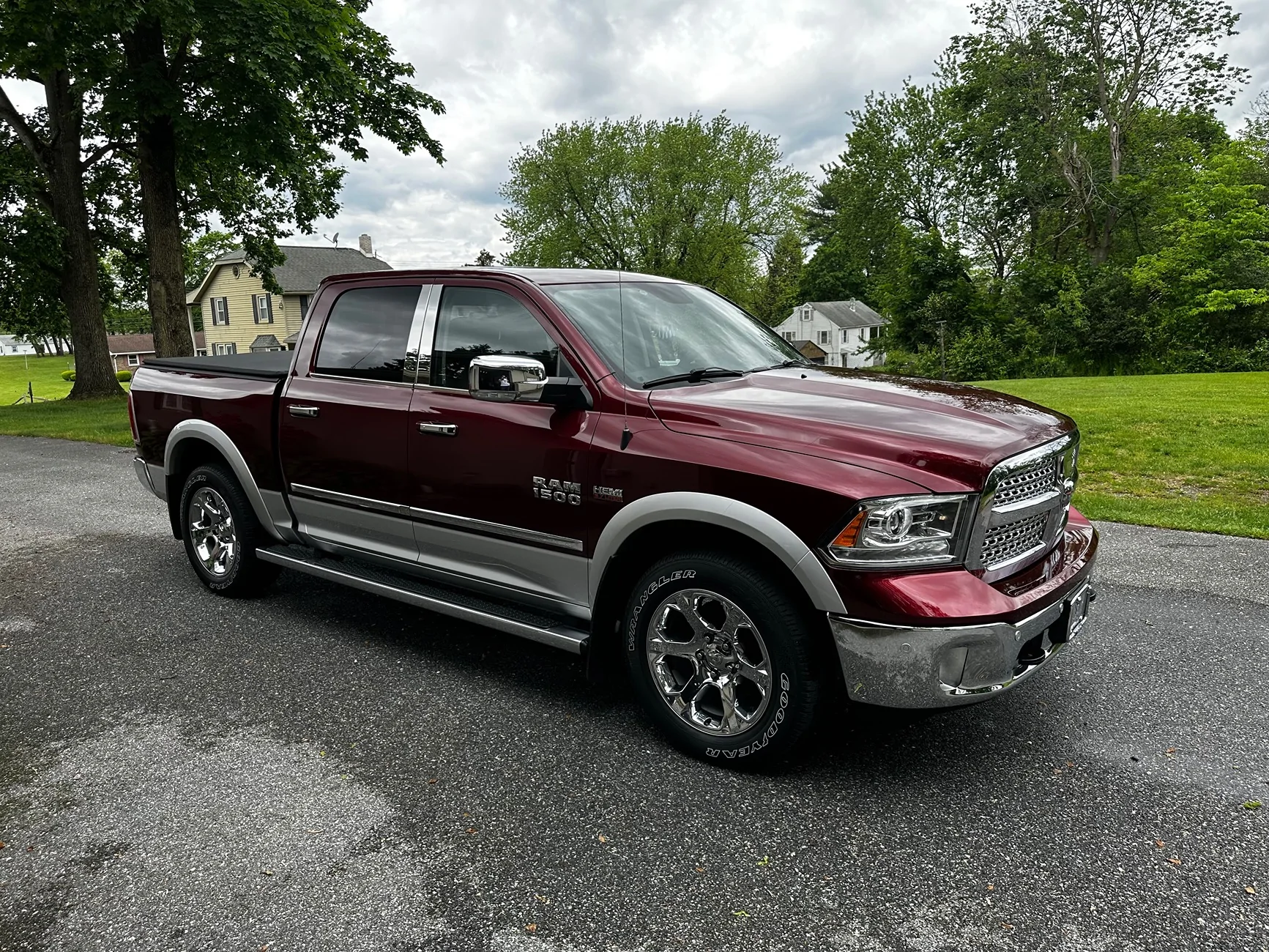

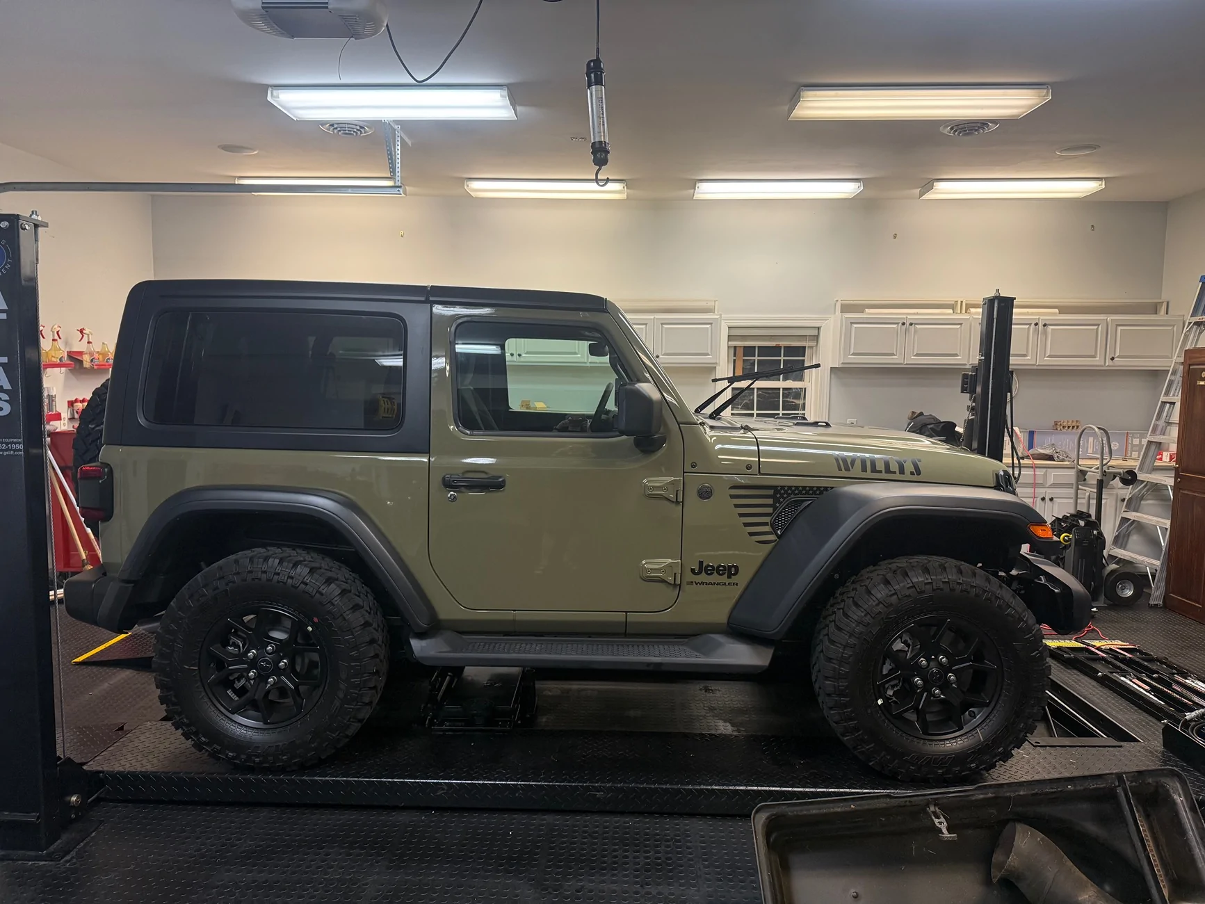

I've used Krown here in PA. My RAM 1500 is 9 years old and still looks great. No rust noted up till now, so I used it on the new Willys I just purchased. It costs $139 for a truck and $129 for a car/Jeep. I do it once a year and there's a warranty if there is through and through rust.
Jeep Wrangler JL What undercoat to prevent rust (from snow)? IMG_2133
Jeep Wrangler JL What undercoat to prevent rust (from snow)? IMG_4125
