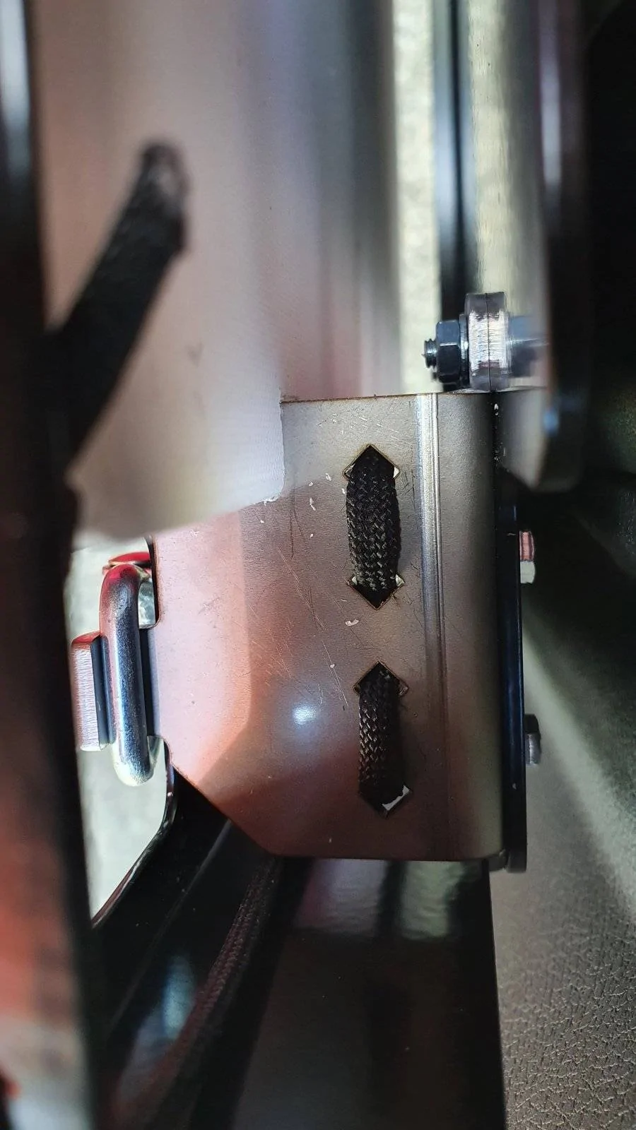

Mine did rattle until I put a pair of furniture feet pads on the front surface of the backplate. As mentioned in an earlier post I put rubber weatherstripping behind the backplate but that was to take up the space between the backplate and the plastic trim surface of the tailgate.

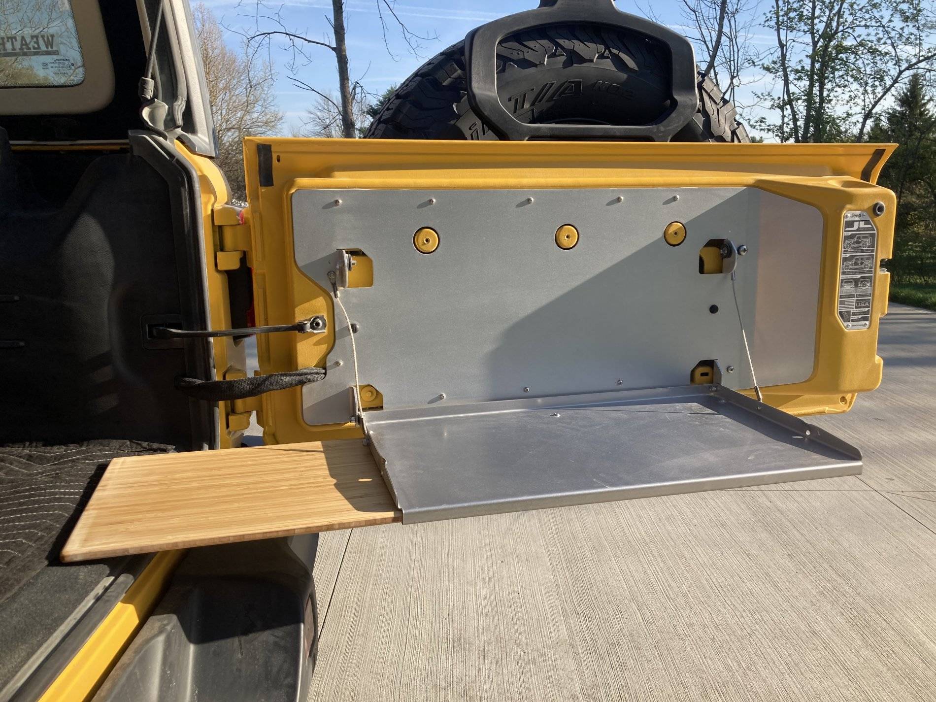

For everyone that is using a table with an additional slide-out board: if you slide the board towards your jeep, you can rest it on the cabin floor.
Now you can put much heavier items on the extension, like gallons of water. It also helps protect lighter objects from wind, and won't wobble everywhere and knock things over if you actually use it as a cutting board that you'll never wash, since it is closer to the fulcrum and not hanging off the end of the tailgate/lever.
I use the Frontrunner table, and I've removed the thumbscrews holding the table entirely, so it can slide either direction. This also lets me pull the whole slide out to use wherever, or to successfully clean it.

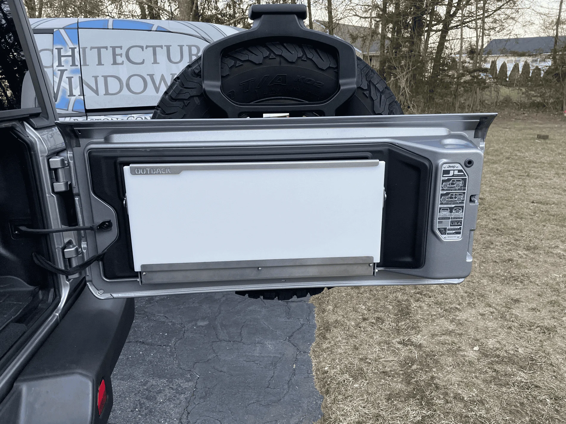

I ended using my Outback Adventures table from my JK. Drilled new holes and used the threaded holes on the rear door. I originally mounted it high cause I didn't think I would have enough clearance for it when I closed the door and just wasn't going to use the slide out shelf. Once I had it installed I noticed that I had enough room and could lower it and use the sliding shelf! No rattles so far and is pretty sturdy without screw attachments points along the bottom of it.
It's not perfect but saved $300!

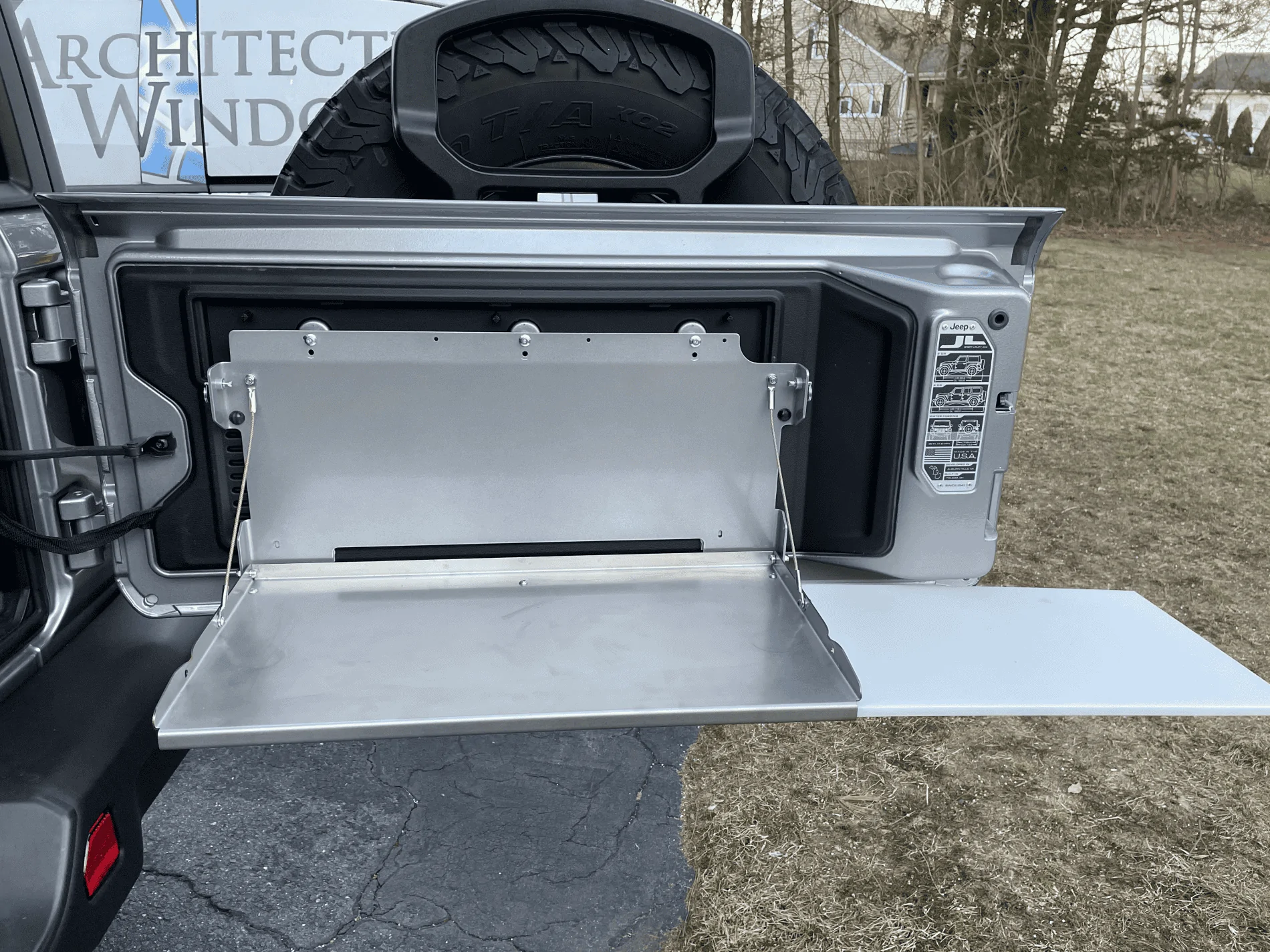

Installed a Springtail, also added a chopping board from Amazon, chopped it to fit and sanded smooth. Screwed some rare earth magnets to the back and notched the board so when it's closed the latch brackets and magnets hold it in place. The magnets also lift the chopping board up 5mm and allow the straps from the bags to go through without getting in the way. Only mod I did to the table was to replace the bolts with black button head bolts as I didn't like the hex head ones being so obvious.
You can kinda see the chopping board slotted around the upper brackets in this pic of the thing all closed up. It just slips into place when closed.
