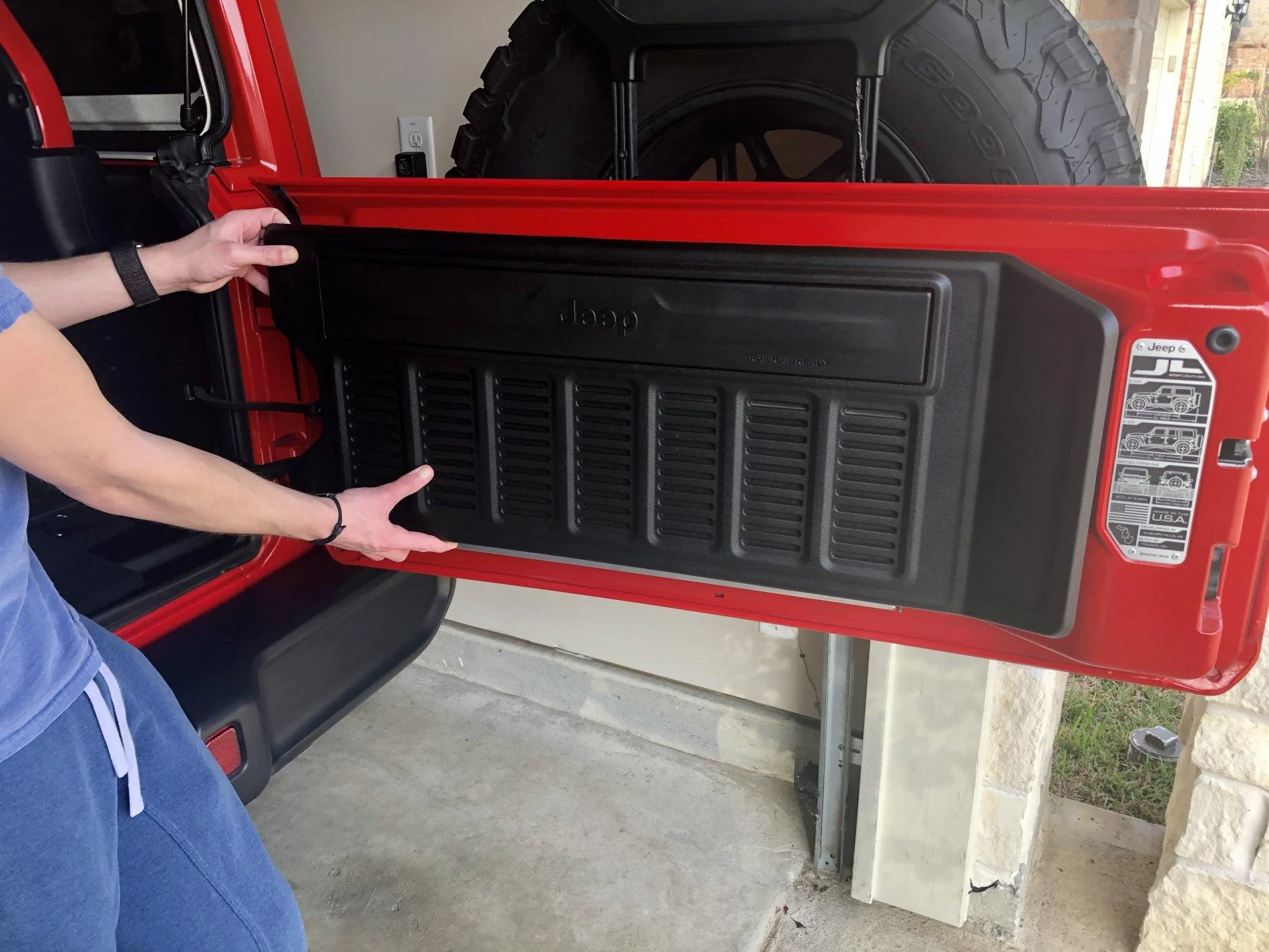

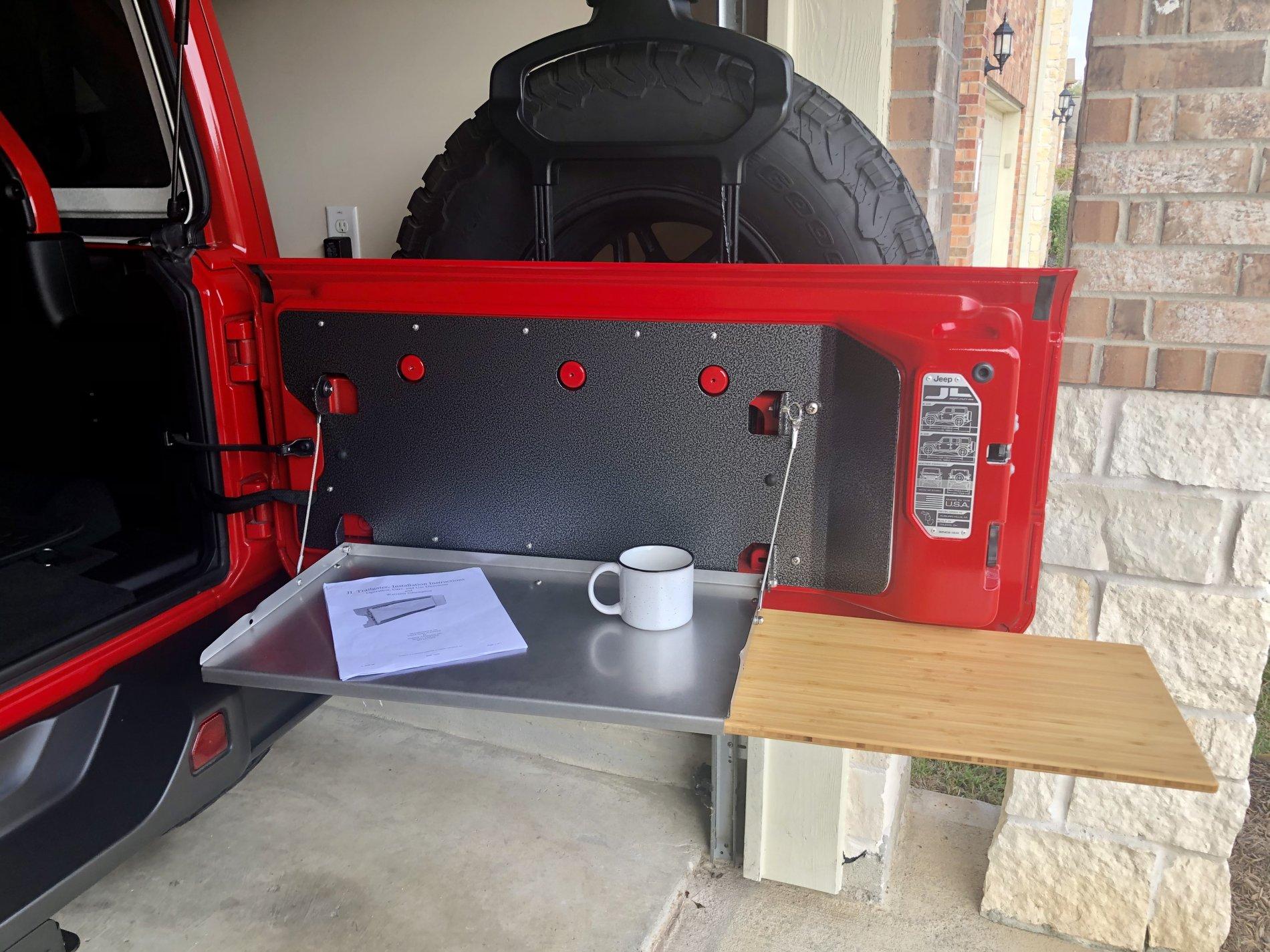

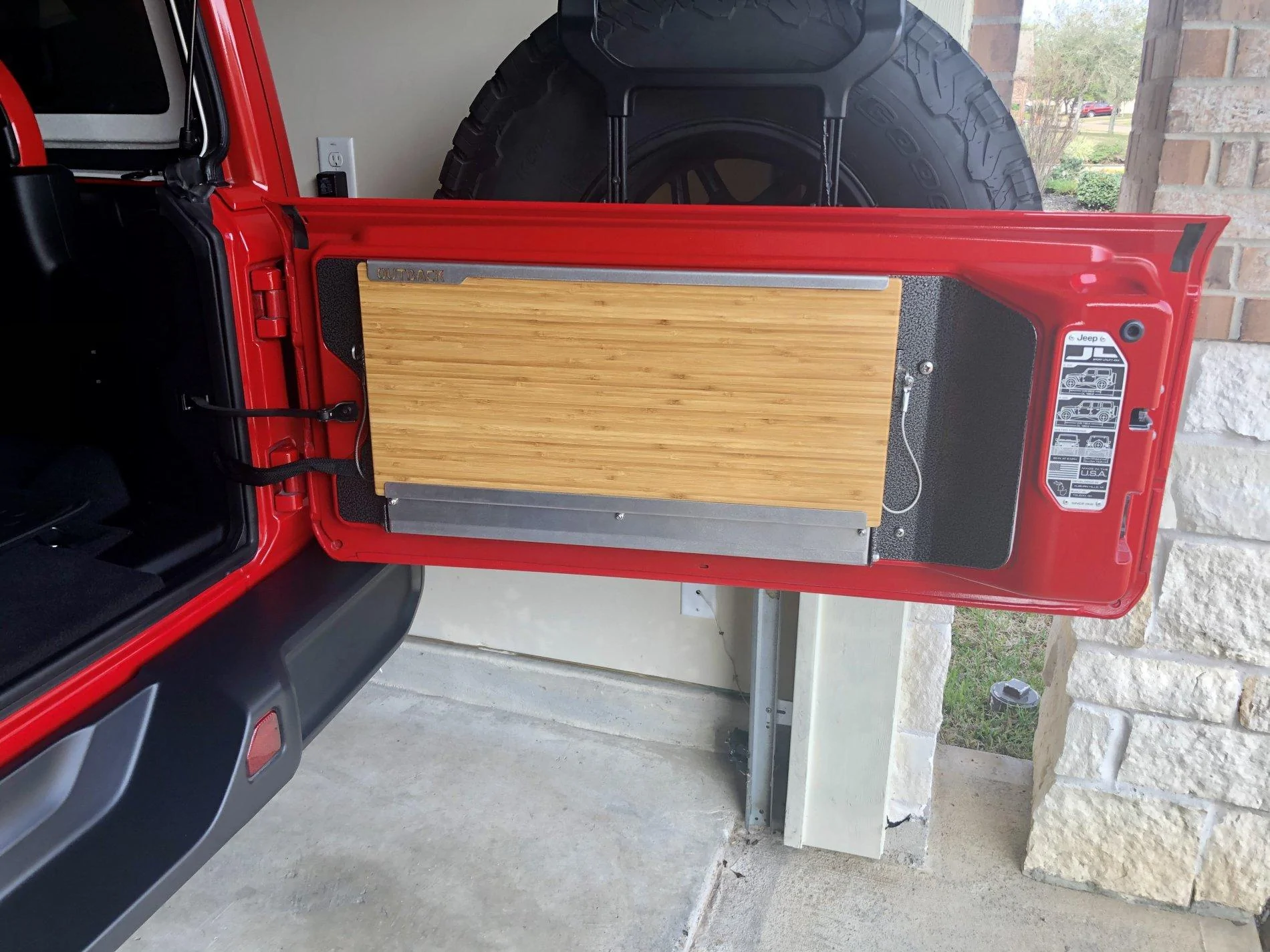

Ive had the RSE table for quite a while now. I see some folks saying it only mounts with 3 bolts. Mine came with additional self tapping screws for the bottom. Love this thing.

i thought about drilling holes in the aluminum backplate to align with the mounting threads on the lower half of the tailgate but I ended up just putting some adhesive backed rubber along the bottom edge and it has been fine.
IMO it’s the most solid design I found among all options out there. The Trailgater looks niftier than the RSE but I really don’t want an exposed cutting board that I slide back into place after chopping food. I’d rather put a used cutting board away in a lidded plastic tub. Nor did I want such a cantilevered surface that was supported only along its short edge. I use my tailgate table as much for all kinds of outdoor equipment setup/prep as I do for for kitchen duty.

There were holes on the table for the self tappers. They lined up just fine.

I just installed my RSE table yesterday and found the bottom does need some support. What type of adhesive backed rubber you use? I’m debating using the self tapping screws or the rubber, I’d prefer not to drill holes if I don’t have to.

Heavy duty weatherstripping. Not the open cell foam type but the rubber type.

Does this table rattle while on trails? I really like this design but am concerned it'll rattle something furious.

Mine did rattle until I put a pair of furniture feet pads on the front surface of the backplate. As mentioned in an earlier post I put rubber weatherstripping behind the backplate but that was to take up the space between the backplate and the plastic trim surface of the tailgate.
