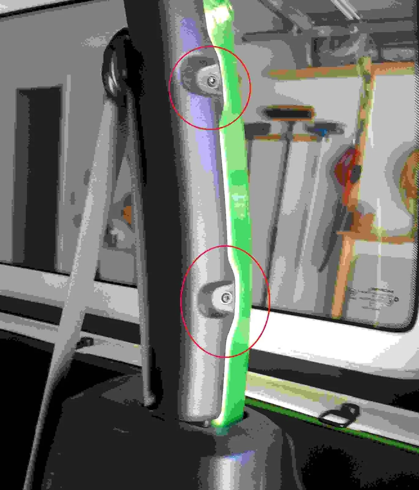

What is the correct tool to undo this screw?

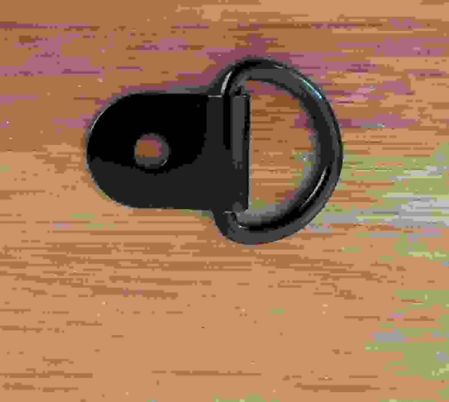

I wish to place D-rings there.

Should be a torx head screw. T-15 or T-25, I believe.

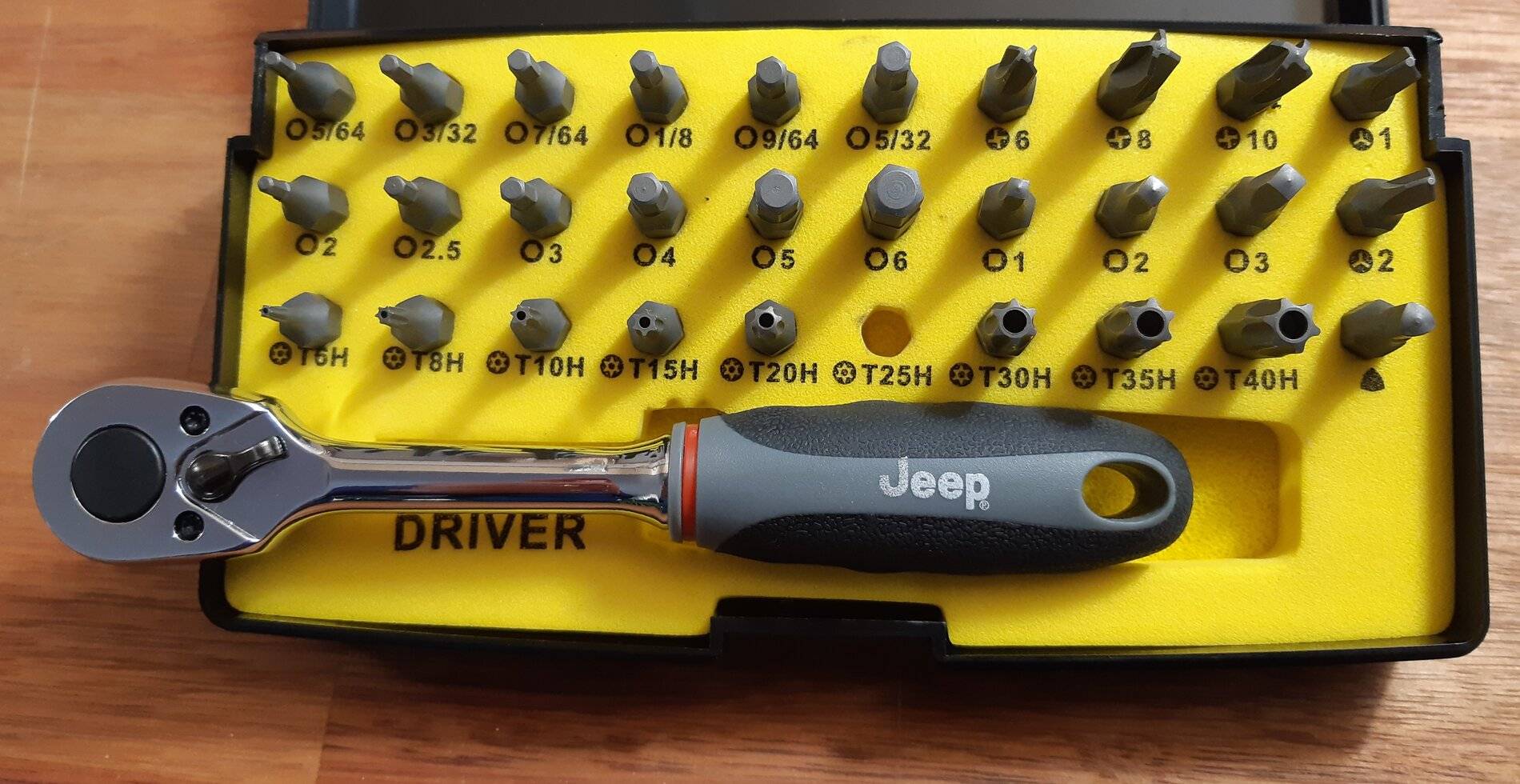

I didn't know what a "torx bit" was! I know now.

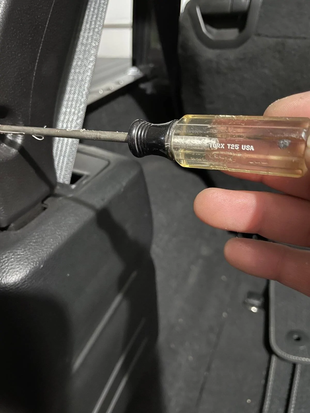

As it turns out I have a box of torx bits. I confirm the correct one is a T25.

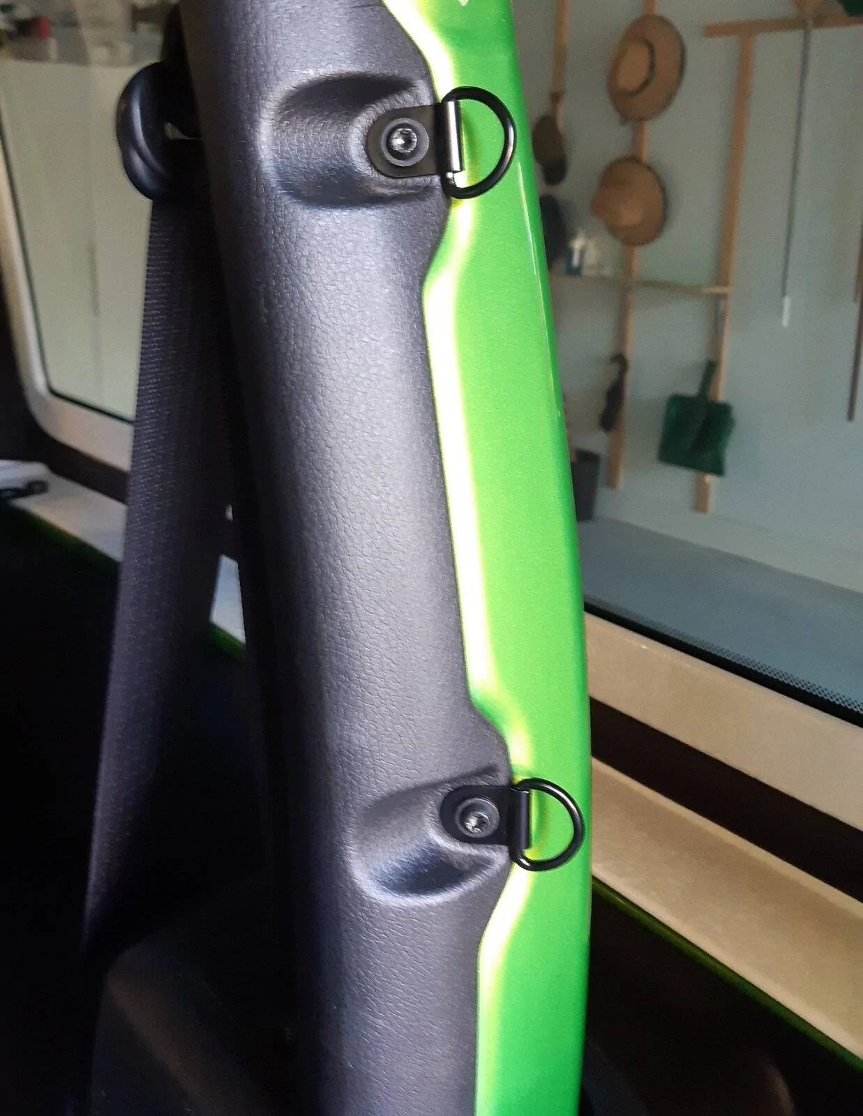

There are 3 on each side so yes I installed 6 all together.
