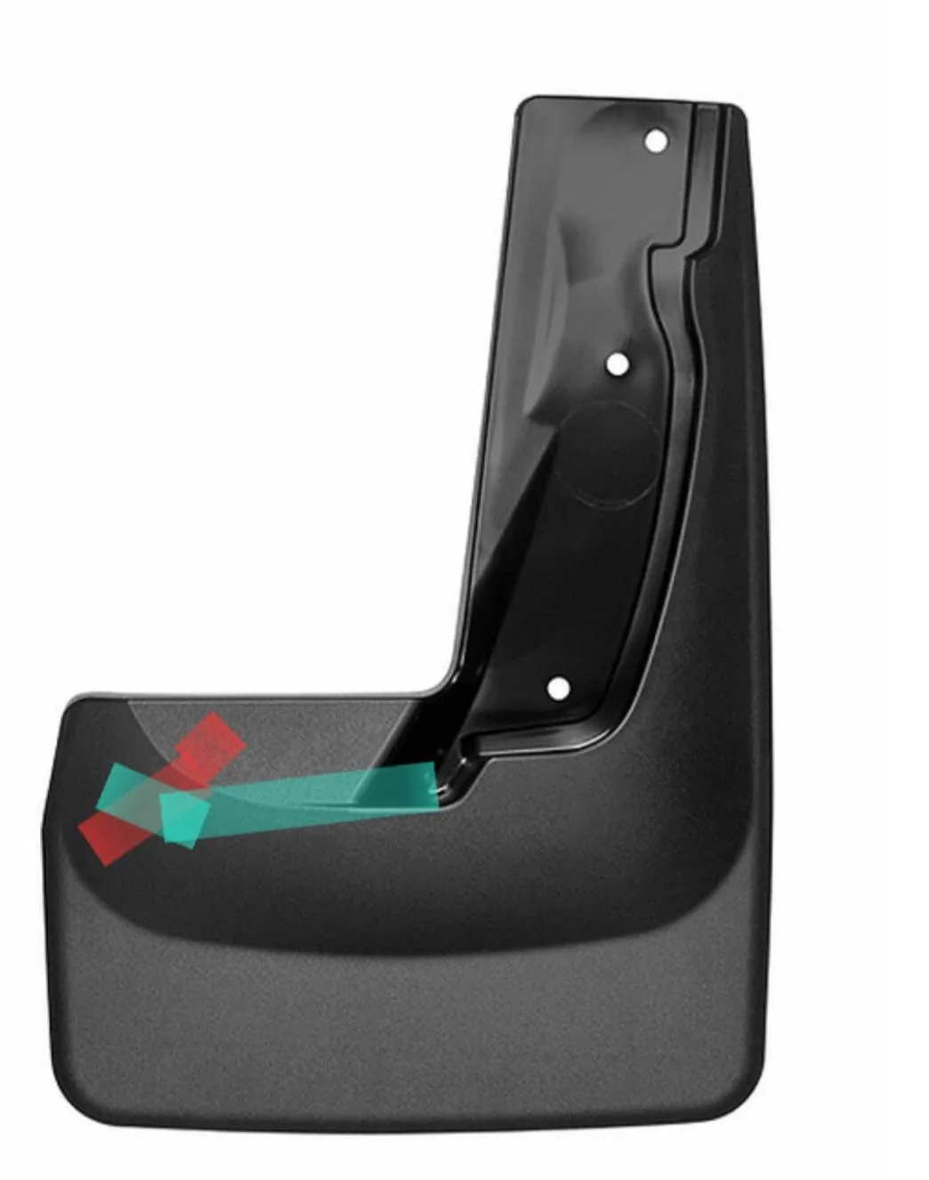

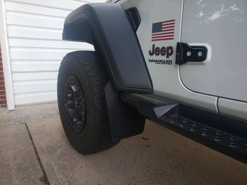

Hi,
None work out of the box, the Rubicon weathertech can be made to work but you have to cut a hole out for the wider rails.
Believe the Rokblokz flaps can be made to work as well but again have to cut them out for the larger rails.
I have the WeatherTech on my 22 JLUR and the wider performance sliders as well as installed the XR flares here is a few pictures or look for my previous post
Jeep Wrangler JL Weathertech Mudflaps on Xtreme Recon 20220313_190849
Jeep Wrangler JL Weathertech Mudflaps on Xtreme Recon 20220312_184335
Jeep Wrangler JL Weathertech Mudflaps on Xtreme Recon 20220312_175842
The more careful you cut them the less mud leaks through, but does help with road spray.

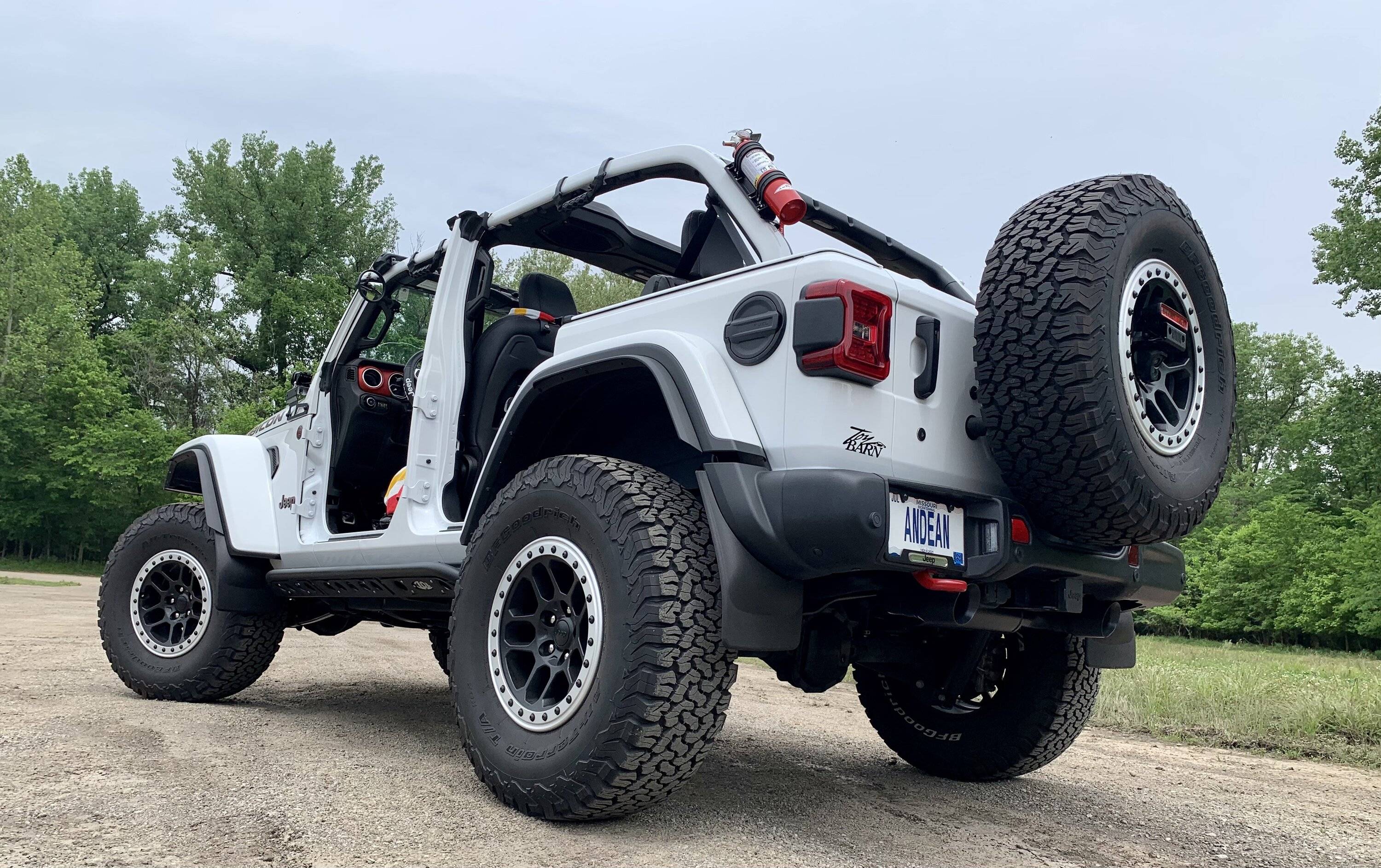

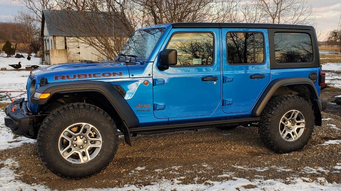

i'm very happy with the xl rokblokz on my JLUR. i prefer the harder angles of the rokblokz rather than the softer curves on the weathertechs. both would do the job very well, it's just a matter of how you like the appearance.

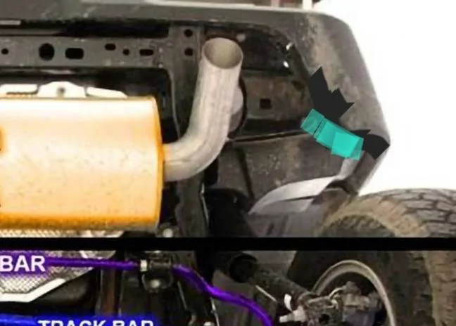

Hi,
Rears work with steel bumpers, but you might have to trim the bumper fillers on the underside of the Jeep as they contact the flap in the following areas
Jeep Wrangler JL Weathertech Mudflaps on Xtreme Recon Screenshot_20220317-103247_Gallery
Jeep Wrangler JL Weathertech Mudflaps on Xtreme Recon Screenshot_20220317-122652_Samsung Internet
Reference:
Jeep Wrangler JL Weathertech Mudflaps on Xtreme Recon Screenshot_20220317-122942_Samsung Internet

thank you. Just ordered the rear one as well

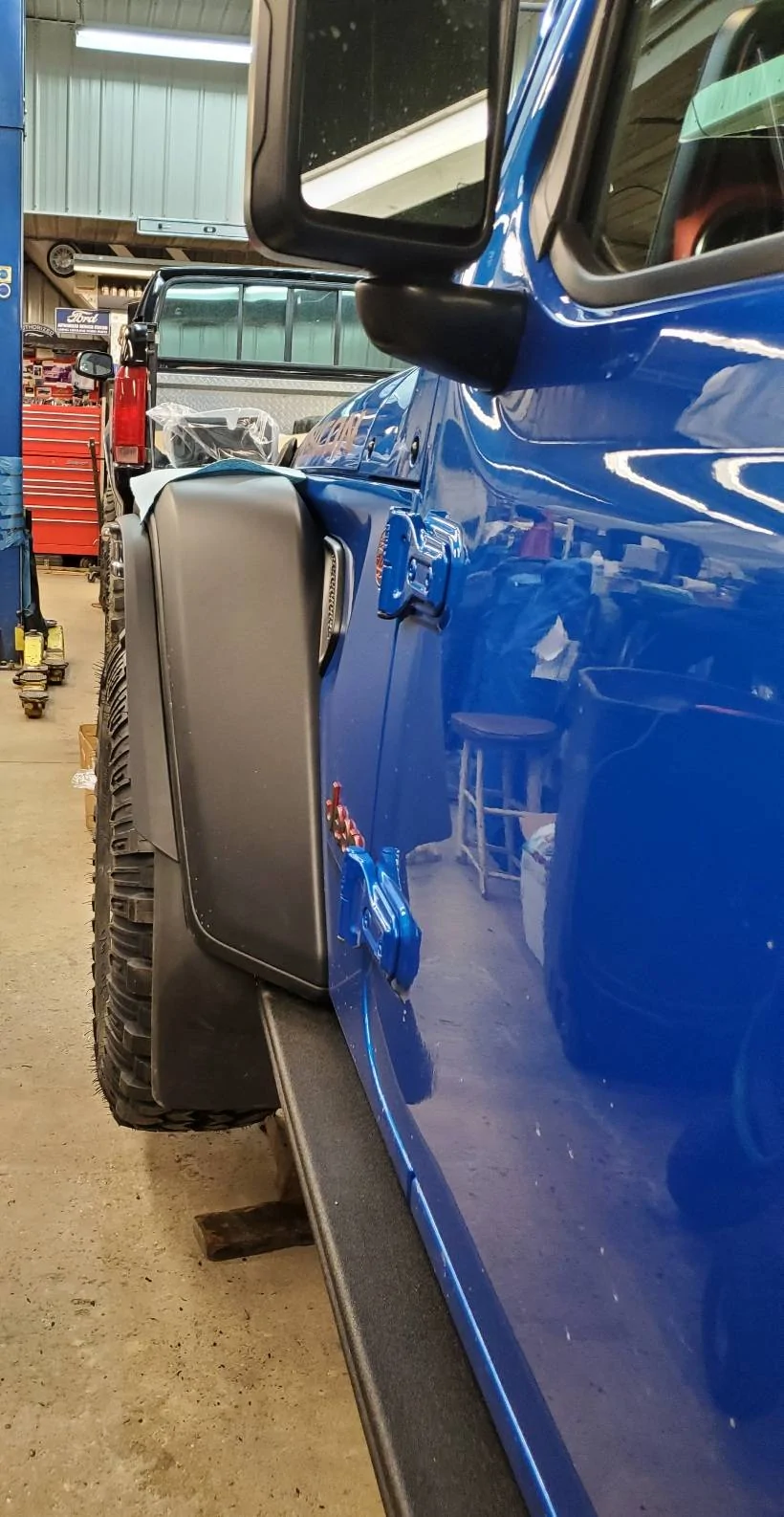

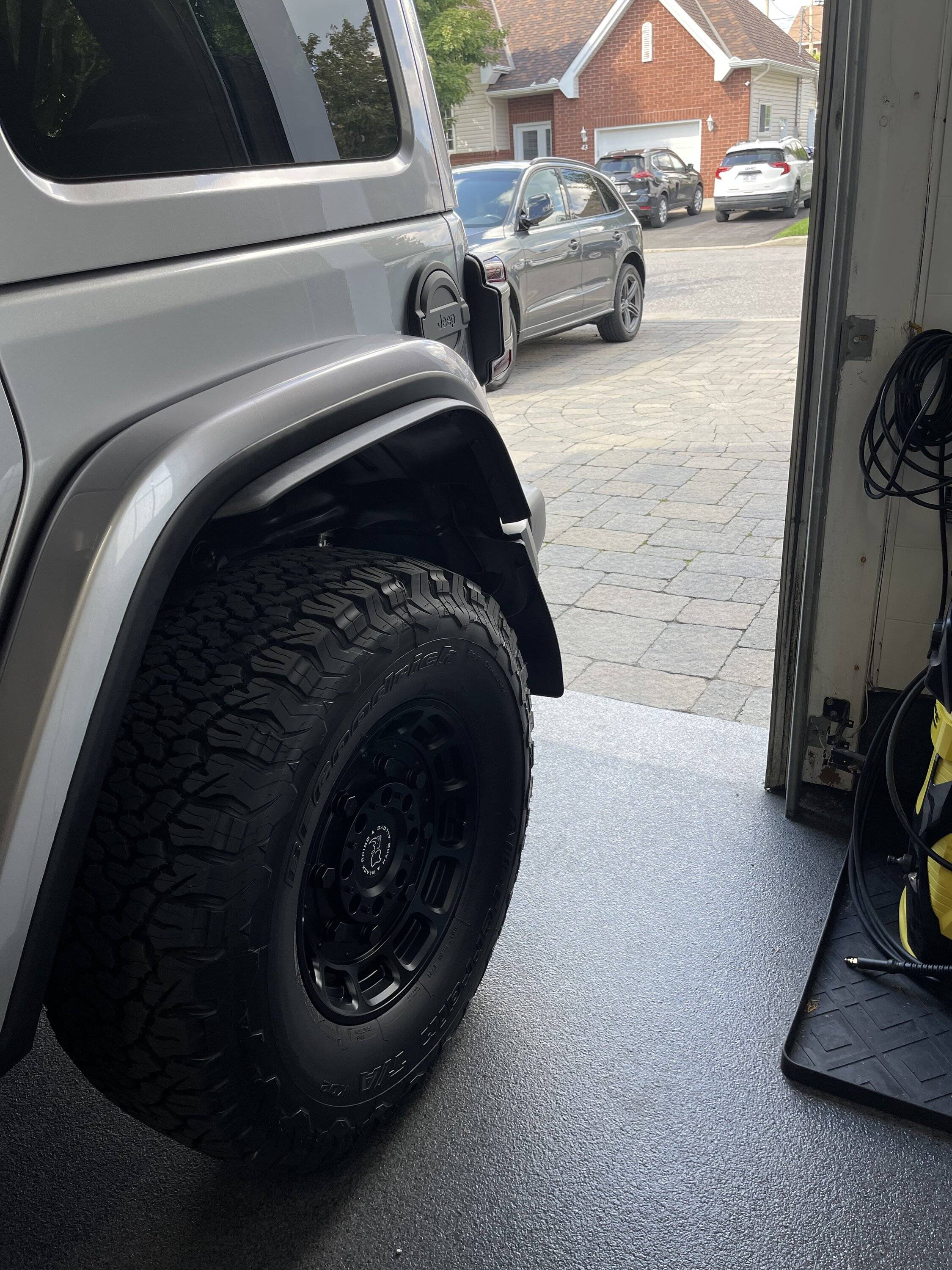

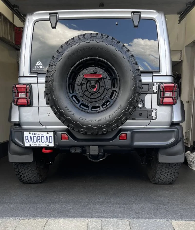

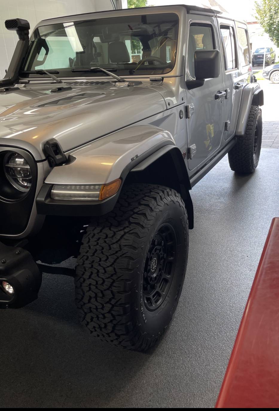

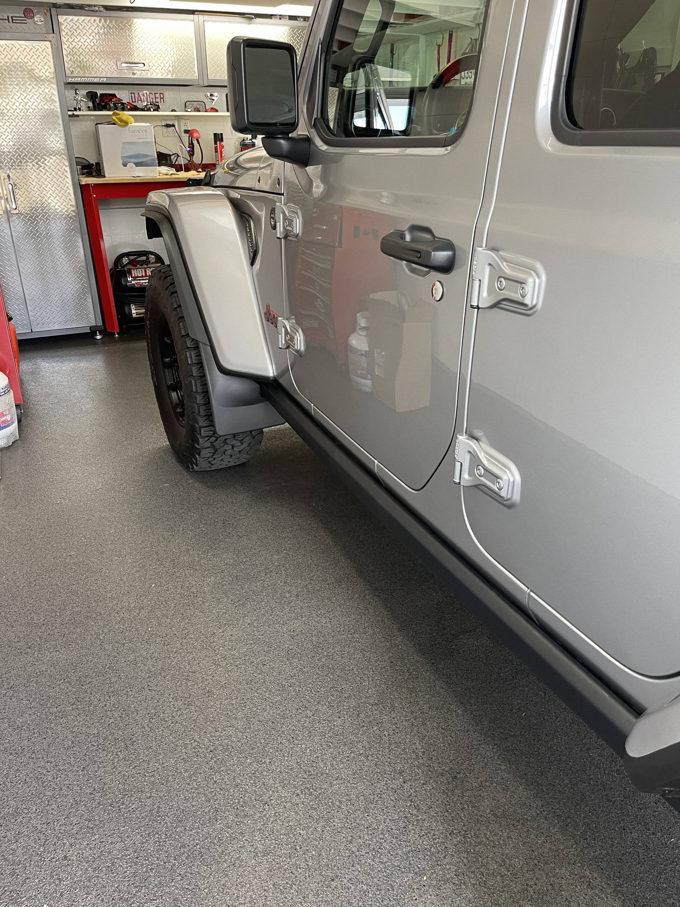

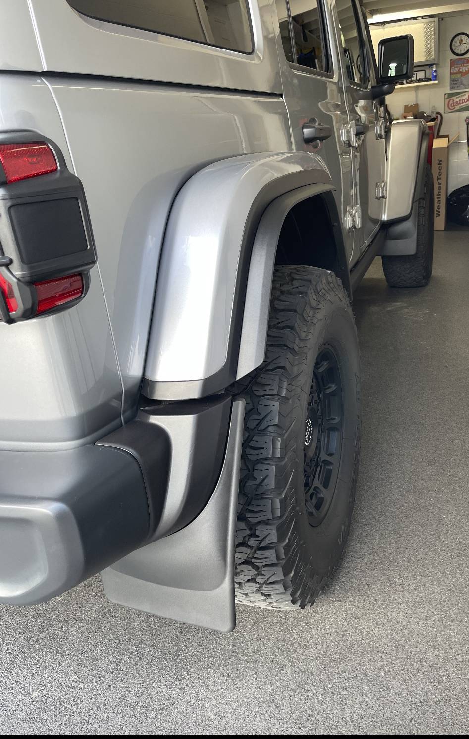

Thanks y’all for this thread, I installed the weathertechs today. They fit perfect and give a serious build look to the Jeep.
After wheeling in the country, I realized how much rocks the big K02s throw at the rear fenders. The PPF did its job but was damaged at 5-6 spots.
So I went back to my PPF guy who replaced the film with thicker one for free. So before it got damaged again, I was looking for a solution.
I reinstalled my Sahara steps, but they look in your face hideous when you are used to look at the Jeep with the rock sliders. I just couldn’t stand their sight. Being 6’1’’ with a grown family of tall people, The steps don’t get used and all they do is dirty our pant legs going in or out of the Jeep. The only time I find the steps useful is when clearing snow off the roof. But one step and I’m standing on the rear tire anyway?‍♂
With this said, I like the look of them. From 3/4 front or rear they are hardly noticeable and I’m sure people following me will appreciate

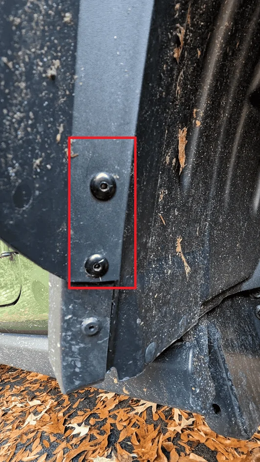

The bottom two from the liner should be pretty easy with the trim removal tool, the other rivet I used a small drill bit to the center of the rivet, then used the trim removal tool to pull it out. Stay patient, I hope that helps!
This tool is also helpful if you are willing to wait for delivery.
https://a.co/d/53ULkXf
The rivets you drilled out are steel and marked below right? thanks.
