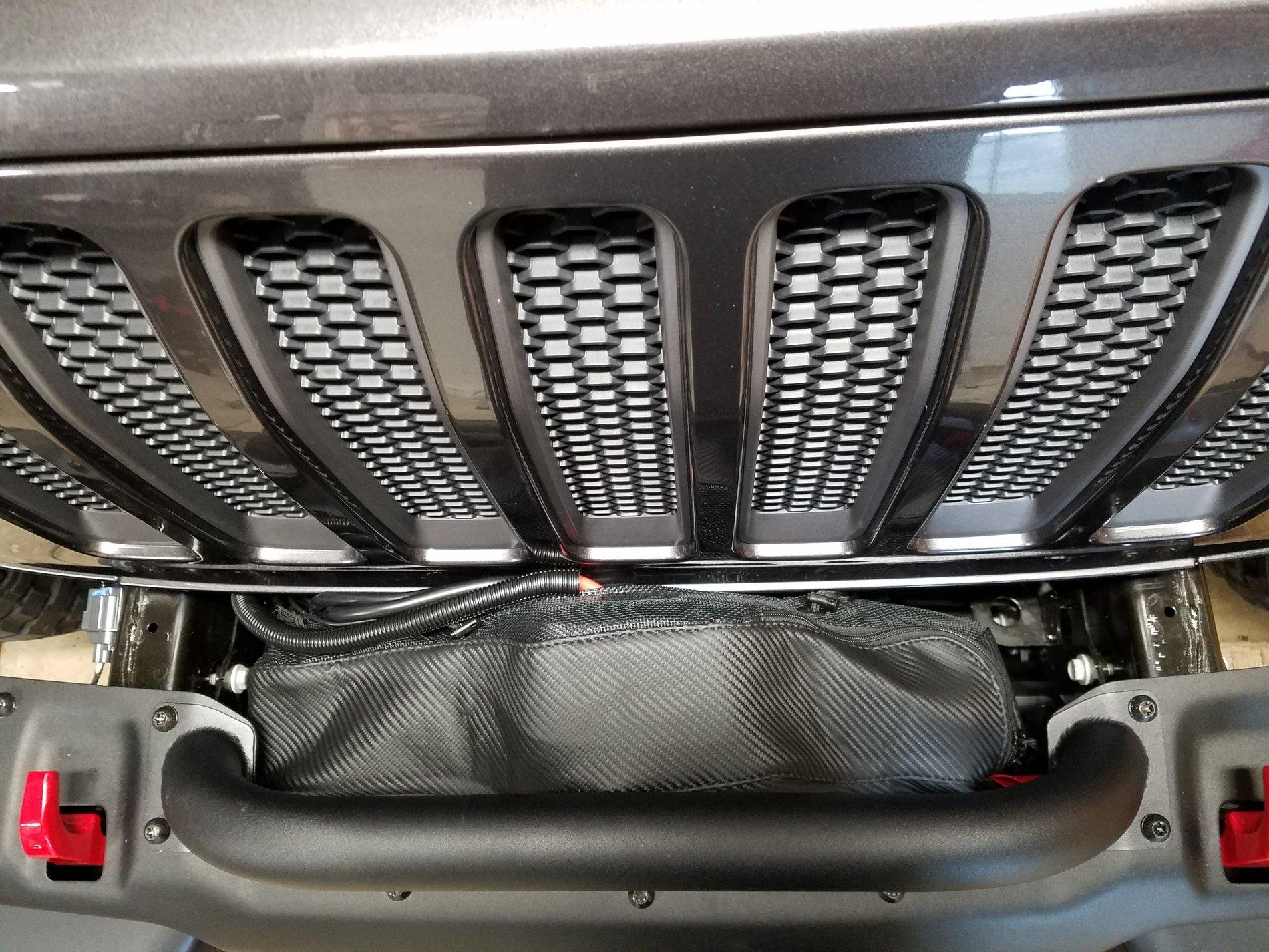

Thanks guys....Mine is the same way and was unsure about it, don't much care for it but it is what it is! I also put a cover on mine and what a PITA that is
Is this the Mopar Bull Bar/Grille Guard? If yes, any issue with space above winch controller?

It seems hard to view the line that is spooling onto the drum with this setup.
Has anybody had any difficulty observing the line spooling on the drum correctly?
