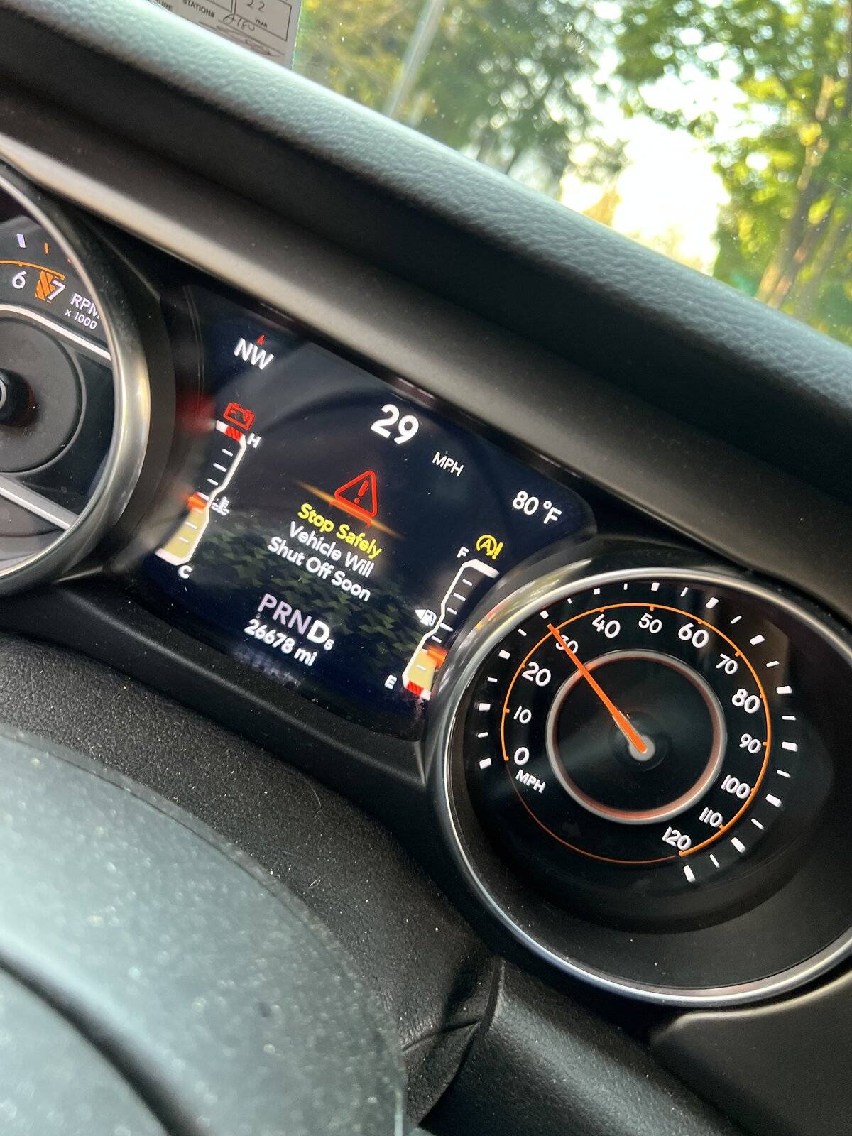

Vehicle will shut off soon????

This happened to my 20' JLR (3.6 DAMM ESS w/auto) just a couple days after taking delivery, dealer found a loose ground at the ESS relay and I have had zero issues since. (About 19 months ago)
With your mileage and it being a 19', you will likely get both batteries replaced plus a software update (if not already done) for pre-20' JL's relating to ESS.
The ESS systems on our JL's are a convoluted, poorly executed engineering fiasco that must have been designed by an engineering student...and not one on the Dean's list!
This is EXACTLY what happened to me recently, 2 weeks after I purchased my preowned 2018 Unlimited Rubicon. Jeep wouldn't start, got a jump and quickly got a new battery. Then it was dying at the complete stop. Had it flatbedded to the Jeep dealer, when I learned of the auxillery battery. The what?!!! Then I learned it had the auto/stop which wasn't even working when I got it. Needed a software update and to ensure the auto/stop is on at times to make sure the aux battery stays charged.

I didn't have my 2020 2DR Willys for a week and that message that the vehicle is shutting down soon came on. More than once. It never actually did, but it did take a Jeep dealer mechanic, who should have received a troubleshooter-of-the-month award, a few days to find the loose wire associated with the secondary battery system. He tightened it up and all has been well ever since. I commented to the service writer that maybe that part of the Jeep was installed on a Friday. He jokingly said it seems like a lot of them were made on a Friday. Had to chuckle and then cross my fingers. But I'm good until 85,000 miles, thanks to the Mopar Vehicle Protection extended warranty.

Its amusing how relevant these battery issues are and how many people are struggling with them. I currently have an appointment later next week (for my early 2018 JL) to have the dealer check both my main battery, aux battery, and the harness/relay/connection / whatever the hell it is that operates the ESS system. I have had the "Stop / Start Not Ready Battery Charging" message on my dash and an obsolete ESS system for about 6 months now. Originally thought it was just from me not driving enough but now in the past week the jeep has not been turning over as strong so unfortunately I think I have a shit aux battery that's now been draining my main batter for some months.
I've had the same issue here. The vehicle has zero reserve (even after 400 miles driven per day) and will die with the interior lights on for 20 minutes if the engine is off.
This really hit the fan on a recent road trip and dealers in Idaho, Oregon, California, and Nevada couldn't make any room. I had to make a 6 week out reservation with my local dealership. Ended up jumping the JL 15 times in a 2 week period.

So disappointed in my jerp :( waiting on a tow truck to pick up my 2019 jeep wranglsr sport. It said to pull over that it was going to shut down soon.
It also would not turn off the accessories. Fans kept running, windshield wipers started by themselves, radio stayed on, ect. Messages on the dash included blind spot disabled, power steering service, auto start/stop disabled, service transmission.
Ugh help!!!!this is the second time I'm having to have it towed for this issue!!!
My 2021 wrangler is having a similar problem, mine happens when I first start it, I get messages the say that several of the modules can not communicate with each other, all types of warning icons light up, and yes I can not get the engine to shot off. Other problems were also noted, but to numerous to mention.
I have had it in to the dealership it’s on its fourth time , three times they just could not imagine what could be wrong. I got really pissy, they say they have located the problem with two wiring harnesses. That took two weeks to troubleshoot, and the replacement parts may arrive in two months. Good luck, you have got to be Persistent, with the dealership, I think talking with the dealership general manager may have helped, at least he called me back with information.
