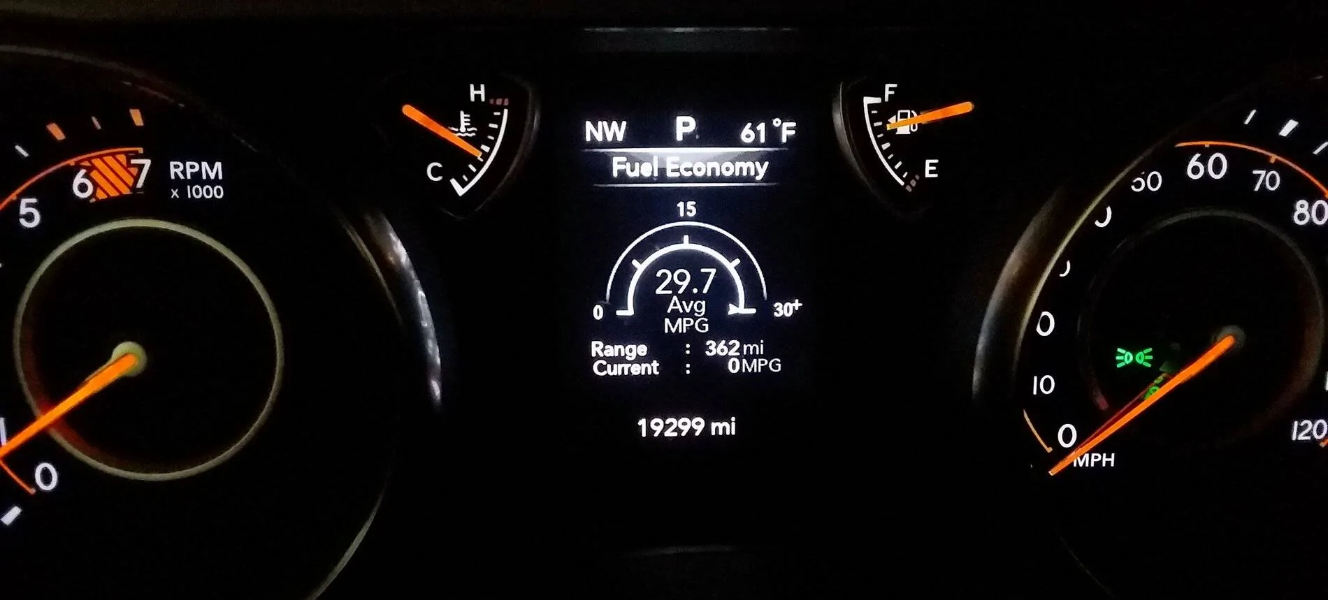

Sorry to read about the problems with your Jeep. As suggested, batteries that are close to failing can sometimes cause a raft of electronic issues to occur, possibly such as what you're experiencing now.
N.B.: The color TFT screen in your photo suggests you actually own an upmarket trim level.
The center display in the Wrangler Sport includes analog gauges and monochromatic text/graphics.
my 2021 Sport S looks just like the picture shown by Hollyblanks- minus all of the issues - I wouldn't call the 'S' an upmarket trim - but now I feel important
