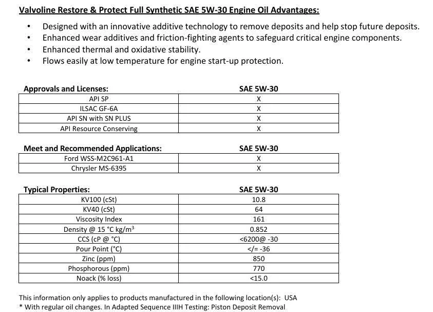

Is anyone using Valvoline's Retore and Protect motor oil as the everyday oil in their engines? I am VERY impressed with the data, evidence and reviews of this product on breaking down and eliminating engine deposits. I have a 2025 JLURX with the 2.0T on order and am seriously considering using Restore and Protect as the standard oil in my Jeep. One of my concerns with the GDI (gas direct injection) 2.0T is the buildup of carbon deposits on the valves and intake runners. This seems to be an issue on all GDI engines since there is no fuel in the runners and on top of the valves to wash the deposits clean. I am thinking that Restore and Protect might prevent these carbon deposits as well. My logic is that these deposits most likely are sourced from the small amounts of engine oil that are bypassed back into the intake tract via the PCV system and valve guides. If this oil works so well to clean internal engine deposits, I would assume that protection would also apply to the intake tract. I'm thinking that adding a good quality oil catch can and running Restore and Protect combined with regular oil/filter changes would be the best maintenance to protect this engine for many thousand miles. Any thoughts?

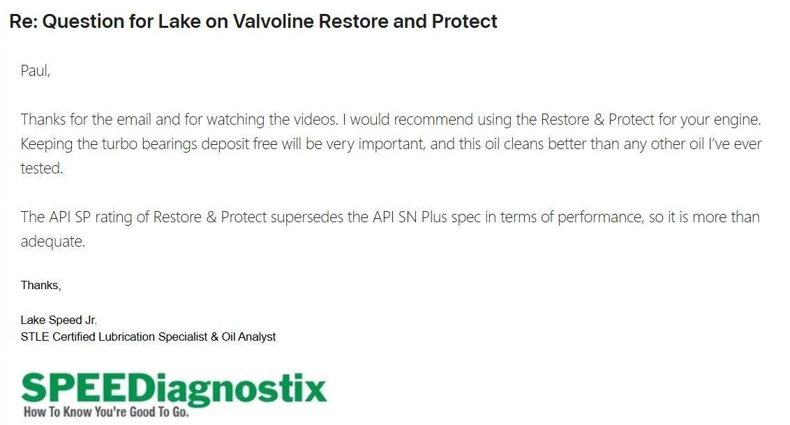

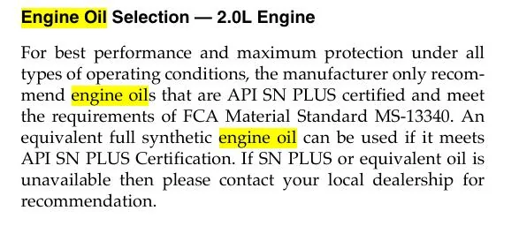

I sent an email to Lake Speed at Speedianostix and we'll see if he responds. I specifically asked him for his opinion on this product as an everyday use motor oil in a new engine. One of my biggest concerns is that I don't think the Restore and Protect has the FCA Material Standard MS-13340 certification that the 2.0T specifies. I don't know how important meeting that particular specification is. The product is Chrysler MS-6395 certified as well as API SN with SN PLUS certified.
