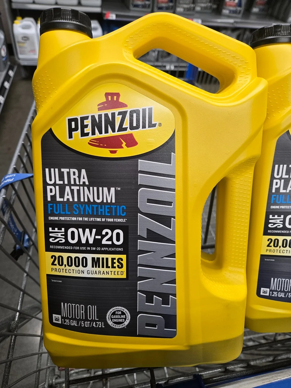

The jeep dealer in San Antonio uses pennzoil.
I’ve been using PUP in my 3.6L. Almost 50k miles and no problems so far.
Used valvoline in our Camry since new. Has 120k miles and runs great.
You do you.

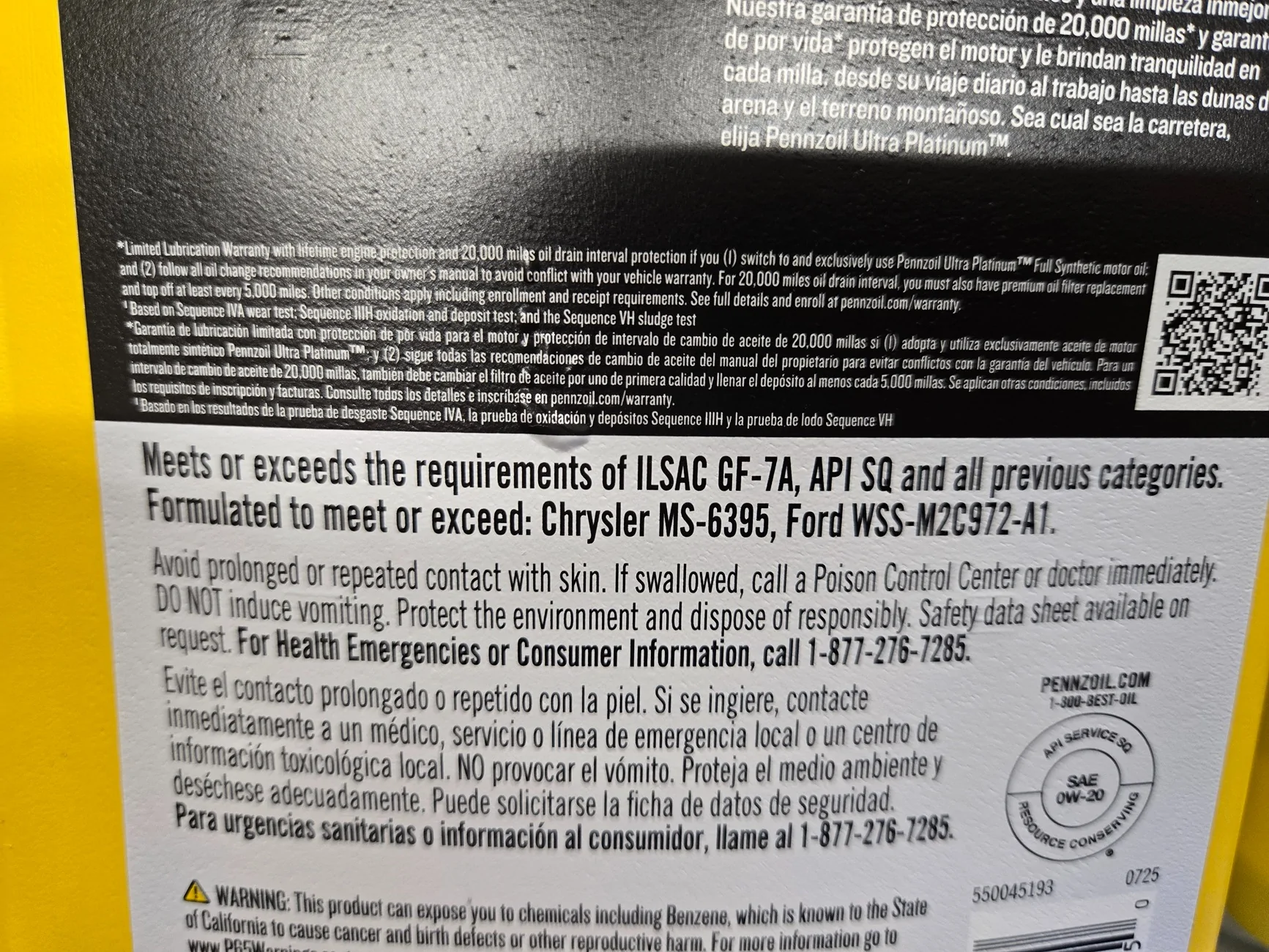

PUP is not the recommended oil for the 2.0, just regular Pennzoil platinum per ms-13340. Valvoline Restore & Protect calcium level is safe for the 2.0 to mitigate LSPI.
