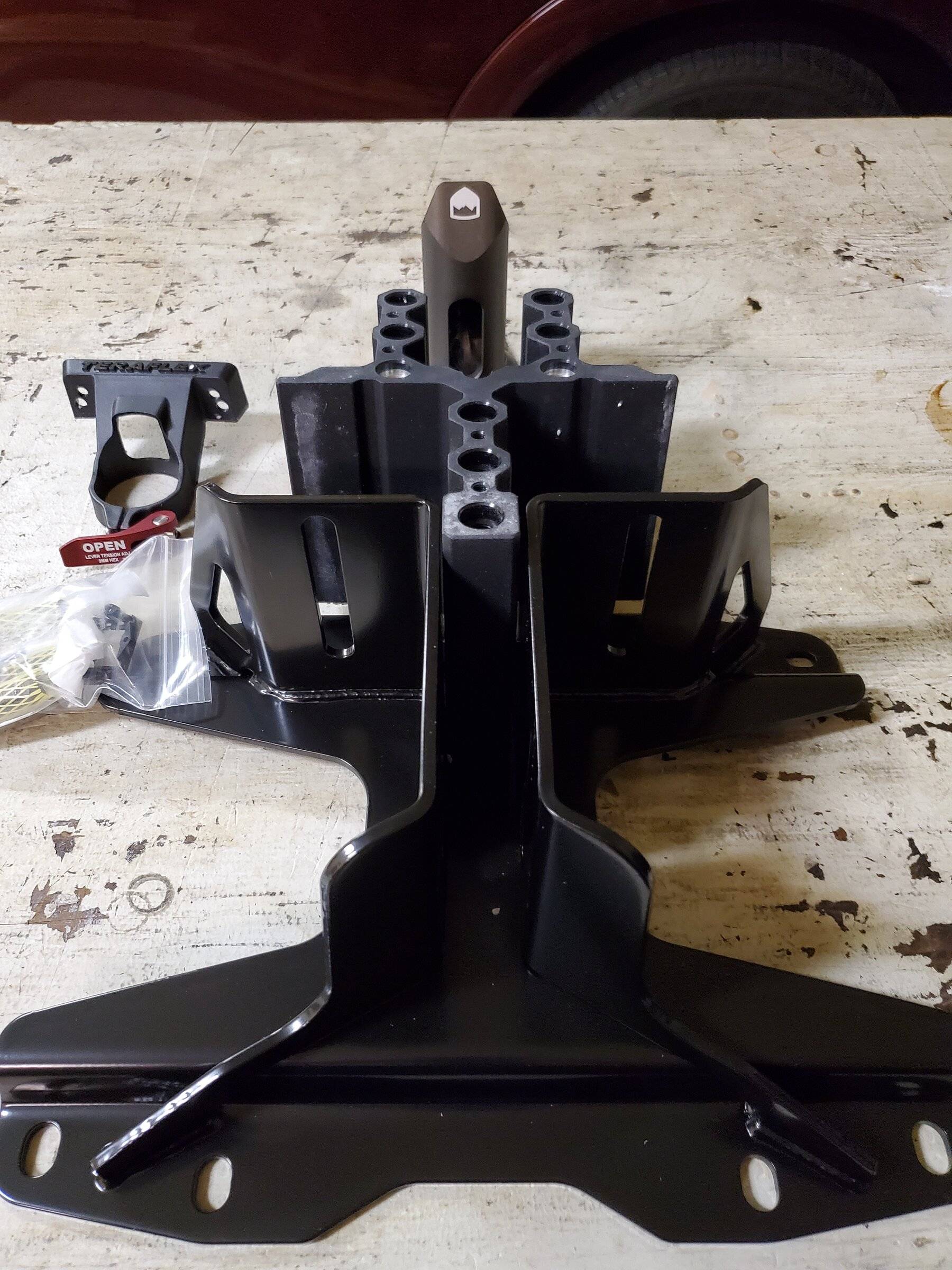

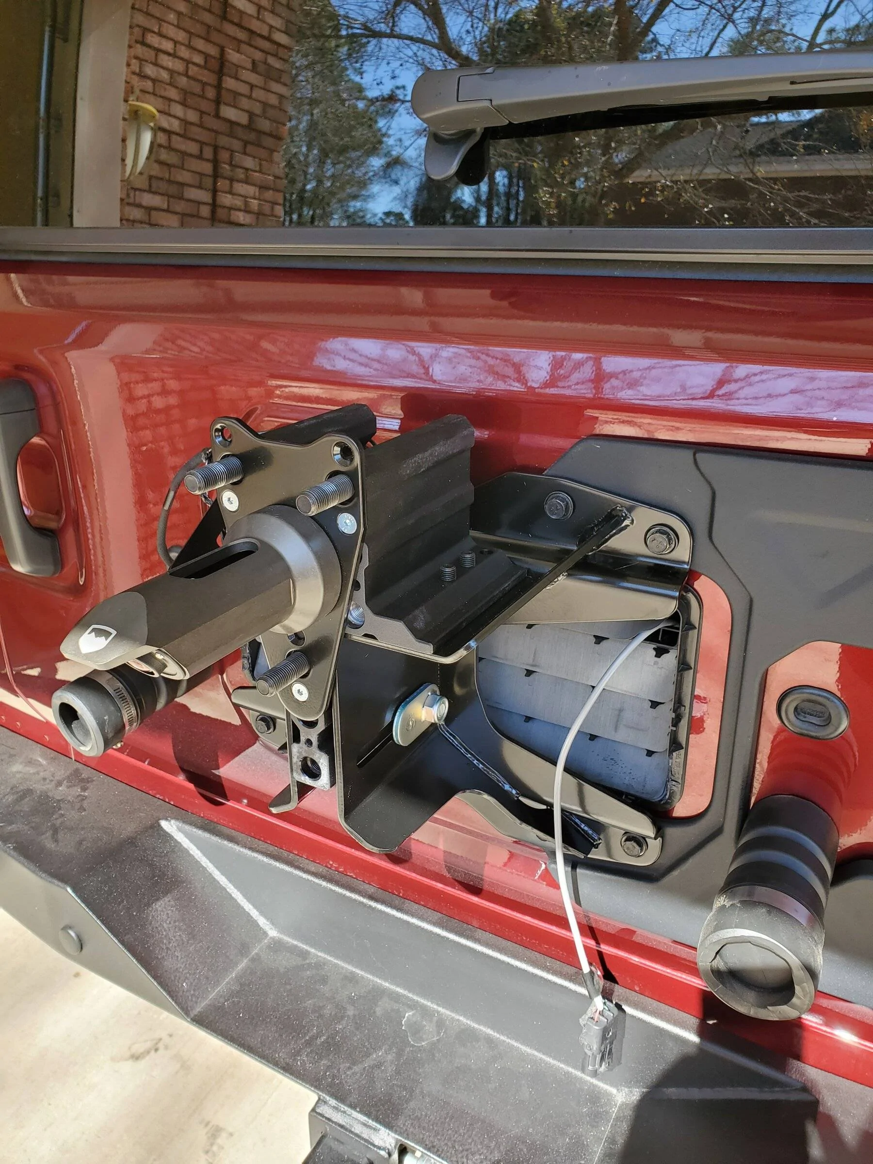

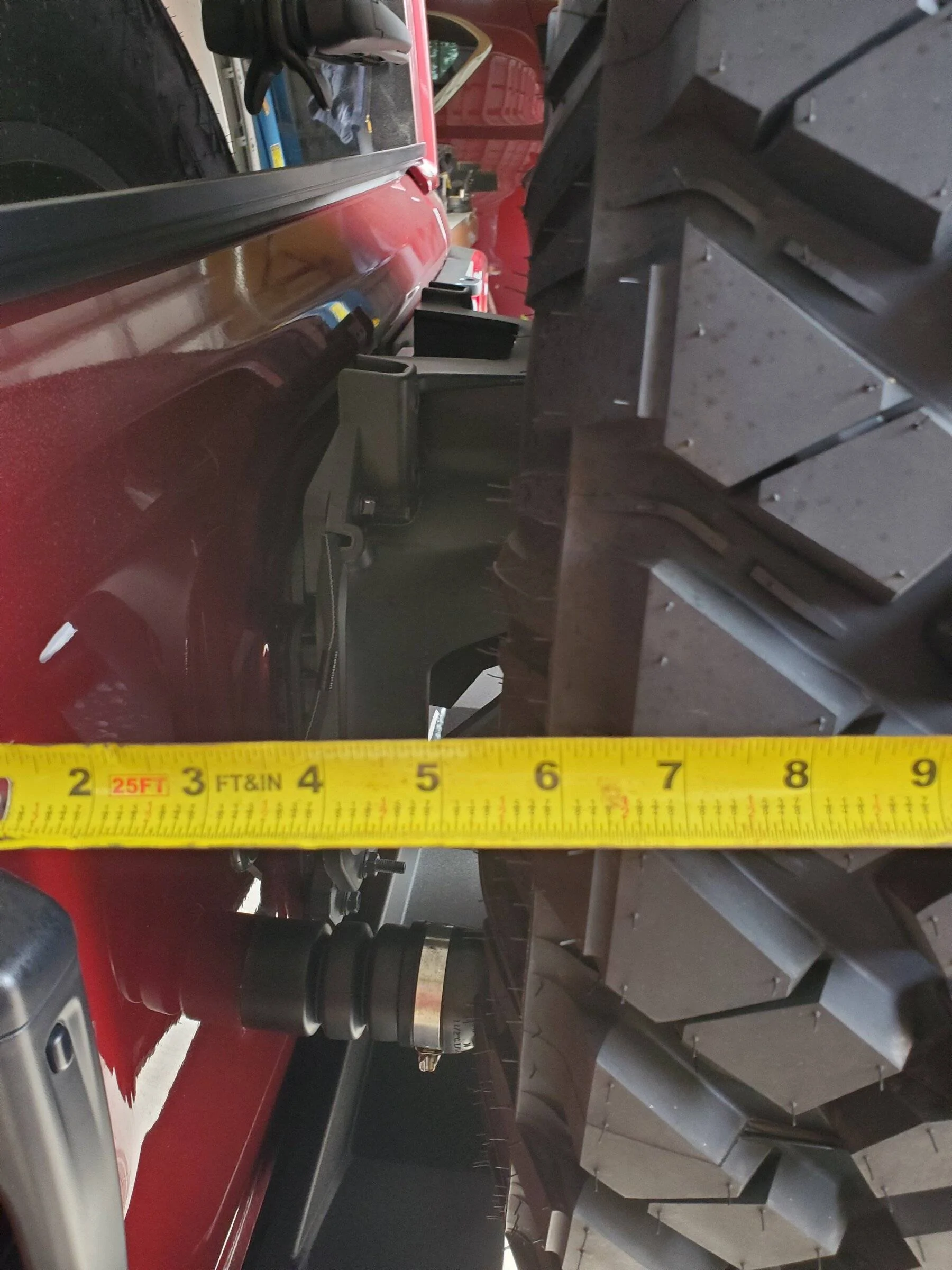

I got the TeraFlex alpha carrier installed and it turned out great. TeraFlex always has really thought out parts, maybe not first to market, but that is likely why. There was an eye popping, tailgate twisting 6+ gap between the tire carrier and tailgate with the mopar relocation bracket. Now with the alpha it is about 2 inches. I can hear my tailgate thanking me. My KMCs have a 3.5 bs, so i am really impressed with how tight this carrier pulled it in. Thanks @TeraFlex
Before
Jeep Wrangler JL Usethis 392 Project 20220212_090336
Jeep Wrangler JL Usethis 392 Project 20220212_090353
After
Jeep Wrangler JL Usethis 392 Project 20220212_122017
Jeep Wrangler JL Usethis 392 Project 20220212_122033

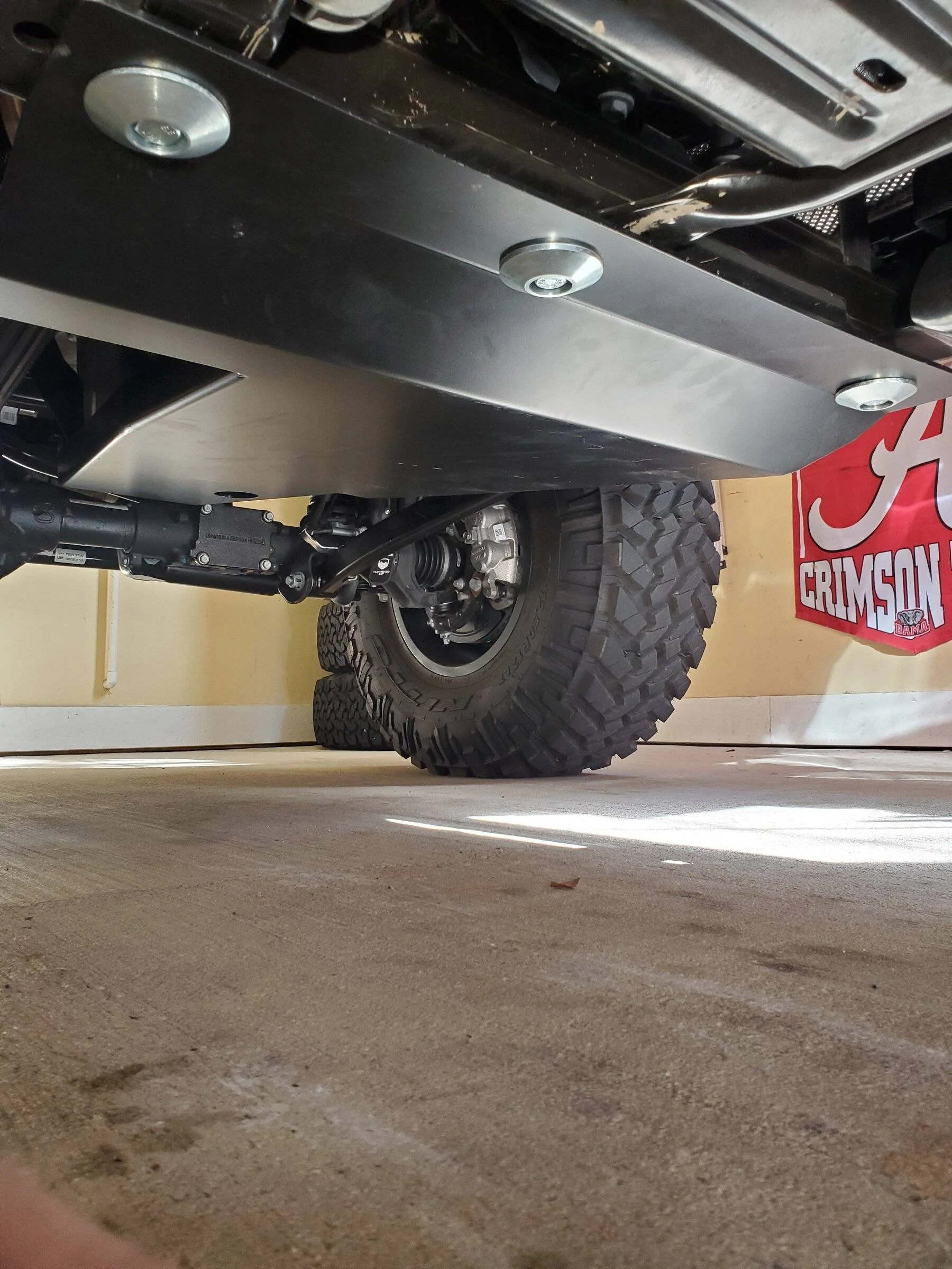

@Usethis83 do you by chance have more pics of the skid? I’m trying to figure out if I can modify the Quadratec one.
