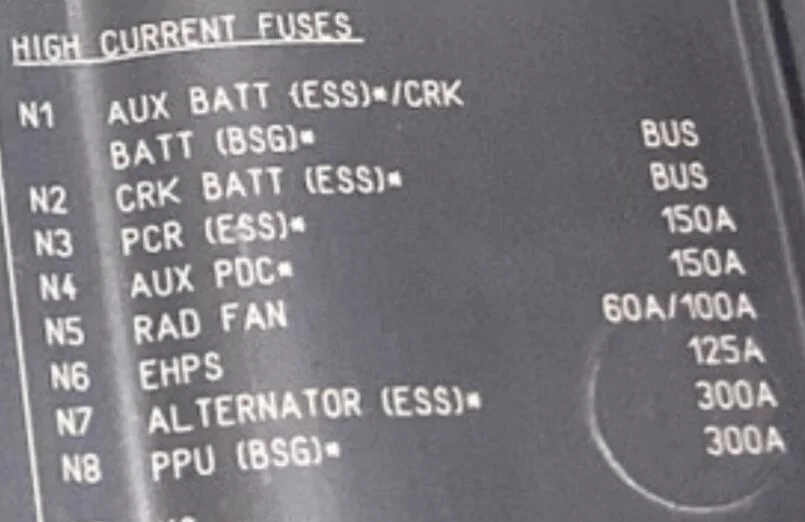

…even the high voltage fuses, that’s a strip along the outside of the fuse box? An easy one to miss.
Yes definitely missed those, hell didnt even know they existed. Given that it controlss the aux switches this may be the issue. Will have to order and hope i didnt waste money. Thanks will update

A key thing is that the JL has multiple batteries so battery cables are still hot even after they're disconnected from the battery. If they short they'll blow out the high amp fuse array.
I go so far as to immediately put the battery cable ends in plastic sandwich bags and secure it with a rubber band. It's just too easy to create a short with the loose battery cable.

Which blown high current fuse would kill only the USB/media hub?
It's not possible.
It's not possible.
but it does control some aux switches correct? and i have checked the mini fuses nothing is blown.
Not really. Most vehicle electronics - including the aux switches, but not including the radiator fan and power steering - are downstream of the N1 bus.
N1 uses a bus - not a fuse - so effectively it can't blow. However, in Jeeps with an N1 powered by the Aux/ESS battery, the N3 fuse can blow breaking the connection between the alternator/main battery and the Aux/ESS battery. The Aux/ESS battery is then drained by the (downstream of N1) vehicle electronics until they're all disabled and the vehicle won't operate/start.
You may be thinking of low 12V battery conditions causing the aux switches to be disabled?
oh my! so with that being said could it just be the actual hub hardware?
Seems possible. And if you're sure its fuse is intact, probable. That, or some connection issue caused by the aftermarket audio install.
