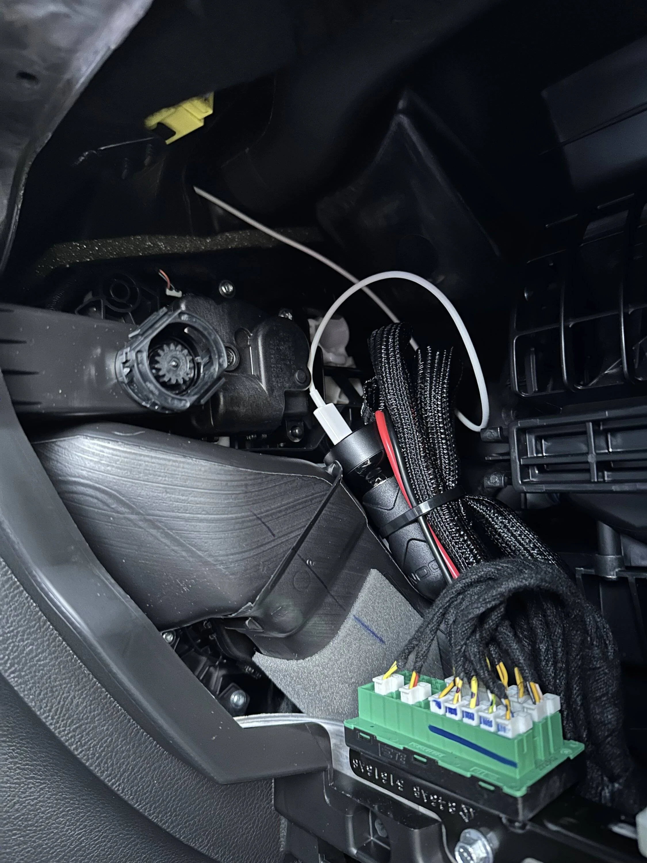

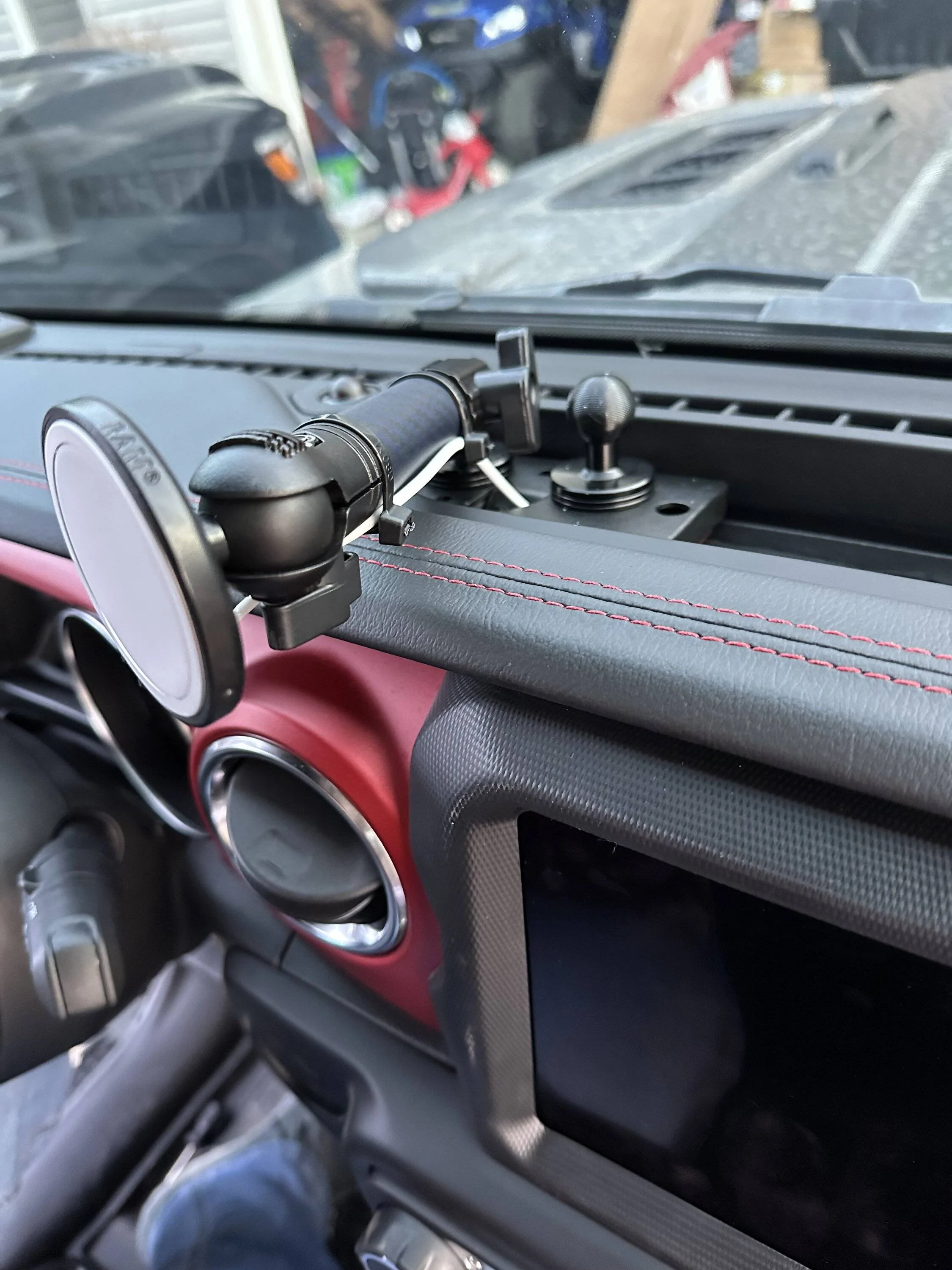

Do you have the factory aux harness? I wired in a 12V plug behind my glovebox and then added a USB-C charger then pulled a MagSafe puck up to a RAM mount mounted to my bulletpoint plate and have MagSafe charging for my iPhone with no visible wires(except the 4" I wrapped in black wire loom that goes from the puck into the dash). Fast, wireless charging with an extra USB-C port down behind the glovebox for anything extra I might add later
