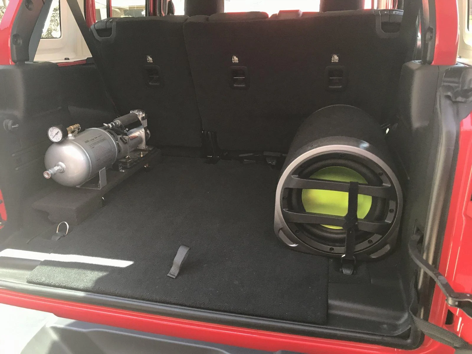

Here's a pic of the rear area. 10" powered Fusion sub and on board air system.
The onboard air is a Viair 400 compressor with a Viair 1 gallon tank. I have a manifold, relay and pressure switch so it will pressurize the tank to 105 psi before it shuts off automatically. It will fire back up if it drops below 85 psi.
