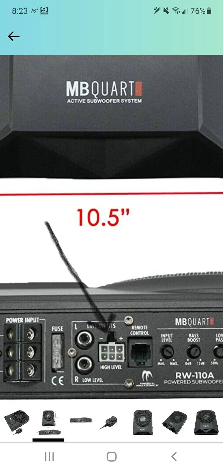

A couple weeks ago, I lost my Rockville Audio powered sub when my Jeep sat out in the rain topless.
Now, I'm looking to replace it, and the price for the same exact unit on Amazon has more than doubled!!!
The dimensions were perfect for under the front seat, with just a little bit sticking out behind the seat.
It was 11" deep and 12.5" wide. Now, I'm having a hard time finding a sub with similar dimensions.. Anybody have any suggestions?
Also, if I get a different brand sub, I see a lot of them with this outlet. What would I plug into this?

It's for tapping into the speaker wires for a signal if you don't have RCA style output on your head unit. It's been a while since I've done a custom audio install, but check Crutchfield.com for vehicle specific solutions. I know MTX makes some great vehicle specific solutions as well.

You’ll want a 6-pin speaker level connector. I was also going to suggest Crutchfield and they’ll help you out well!
