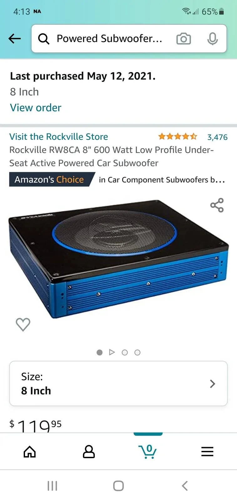

Ok, thanks to everyone for the input. I ended up going with this for ease of installation and cost. I'll be sure and update after it's in!

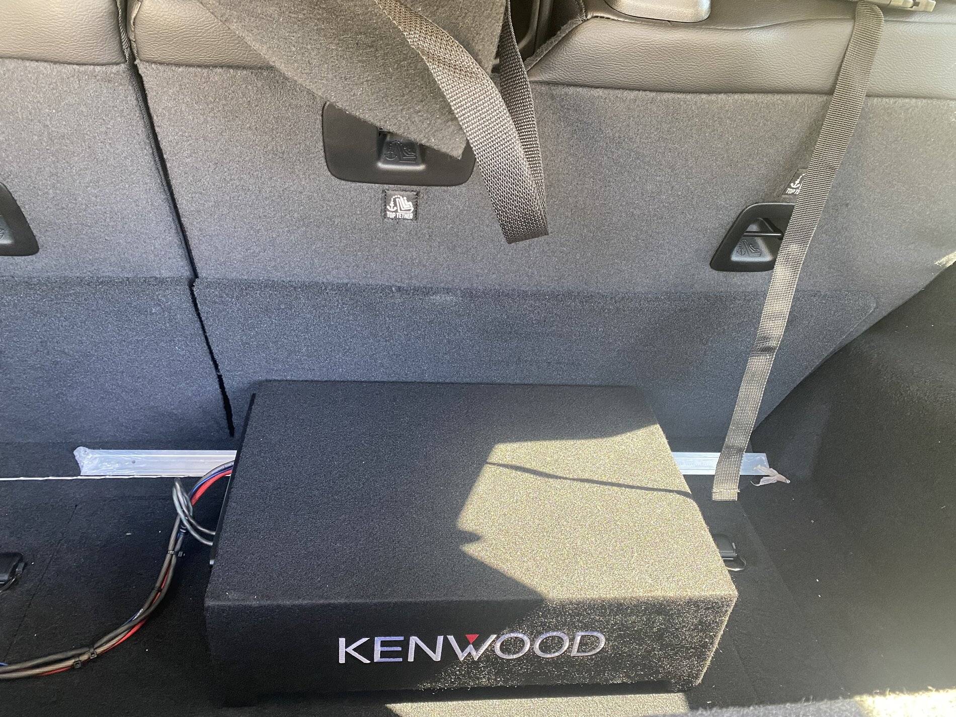

Here is my 8” inverted. Sounds awesome for a little kick. It has quick disconnects to remove if I need the space. I will soon be replacing though cause i want more but I would highly recommend this solution. Under the seat for even the powered sub is tough. Ps: I have the heigh10 head unit.
kenwood pa-w801B

See, that's kind of what I was thinking. Get a sub thas some sort of attachment system so it can be removed easily enough for me, but not people that see it.
Thanks for sharing this picture.

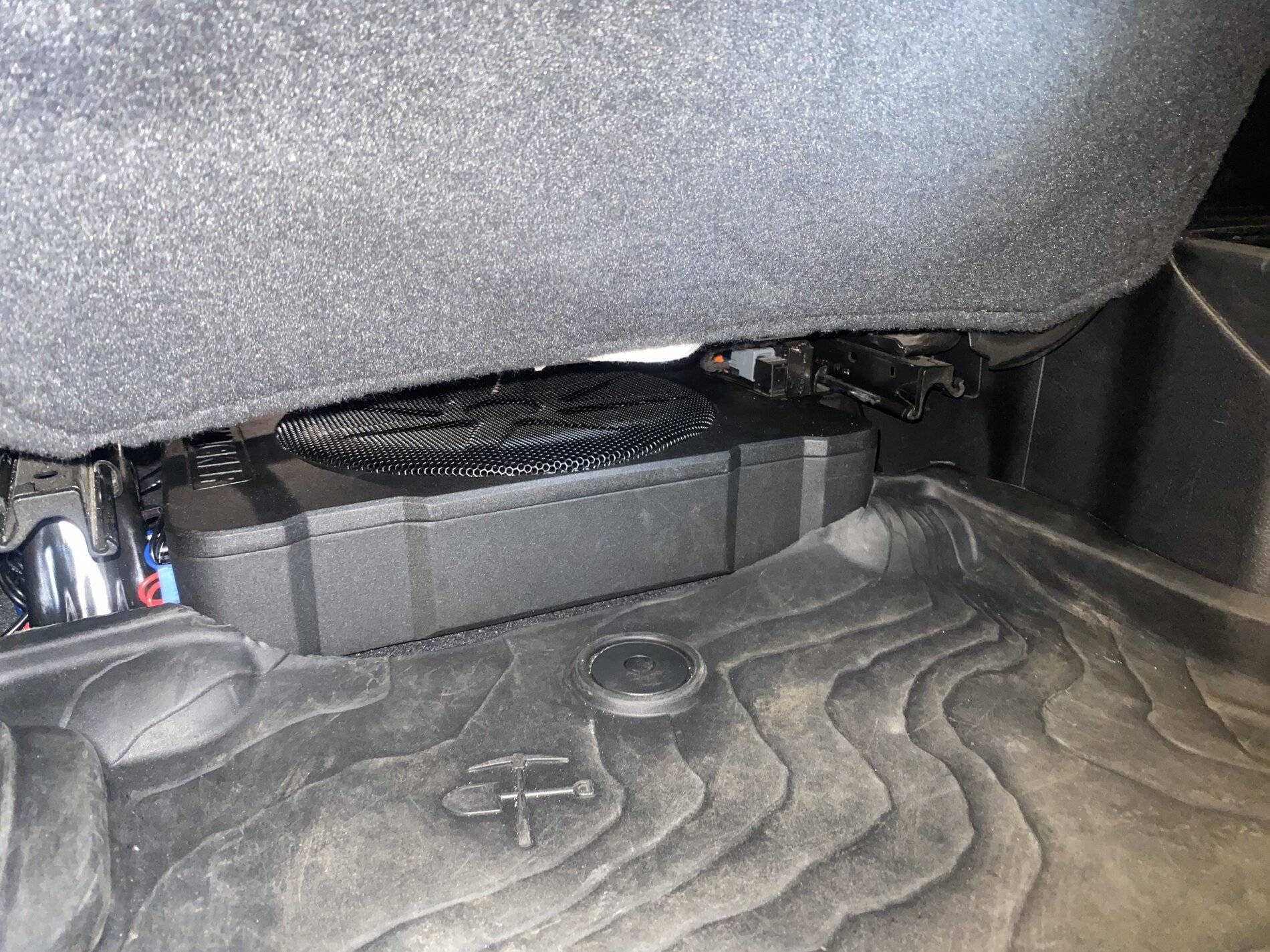

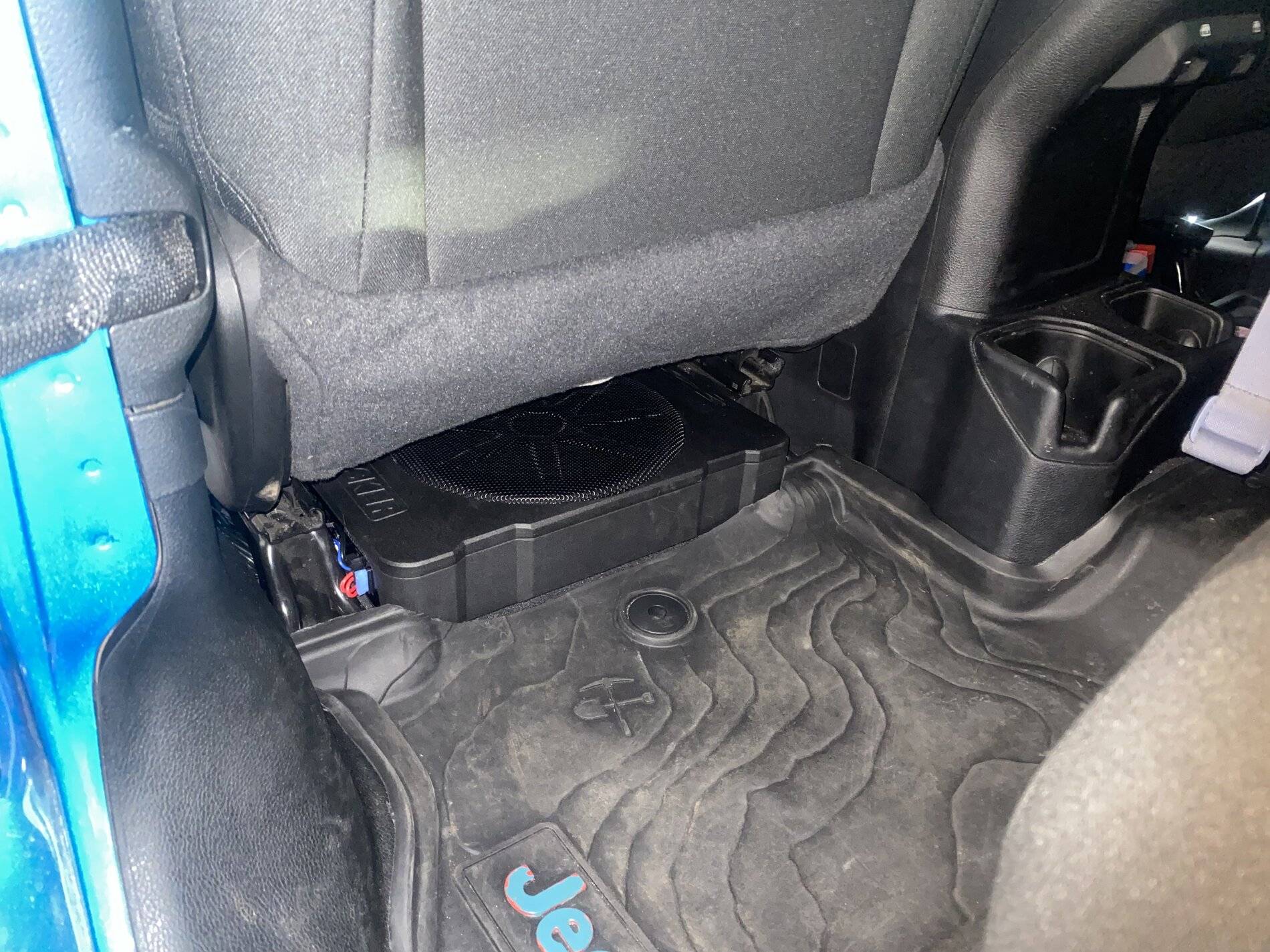

I install a kicker hideaway 10” today. It barely fit under the drivers seat but it works. We had to trim the floor mat a bit. It’s a great addition to the 6.5” components I put in the front and back. Filled in rest of the sound real nice.
If you are looking for a reasonably priced upgrade and don’t need to shake the car next to you, this is a really nice option.
Seat full aft
seat in driving position.

I'm surprised that fit, pretty cool. Just a suggestion, but if it were mine I would raise it up a bit, or build some stilts and flip it so it's down firing, and then glue a bit of carpet to the back. You can get a roll of black carpet and spray adhesive as autozone pretty cheap, and you wouldn't even be able to tell that anythings there.

I got mine in yesterday and will be installing it on Wednesday. Just curious. Why flip it? Does that offer better sound? I do like the idea of covering it with carpet, but will that prevent cooling?

Not necessarily better sound, but as is you'll still be able to see the speaker if you carpet, as you can't carpet over the speaker it's self. Flipping it would be easy, just need some short wood blocks to raise it up, and you could hide it entirely. Covering an enclosure in carpet shouldn't affect cooling, just ensure you don't cover any vents.

How did the install go? Do you have to splice any wires or were you able to plug and play? I really want to improve the sound but am not going to spend a war pension since I am half deaf anyway.

It was an easy job! Hiding/running the wires was the hardest part. I have an aftermarket head unit, so I just hooked into the rca jacks. I did splice into the blue amp wire on the back of the radio.
Definitely a huge difference in the bump in the music now!
