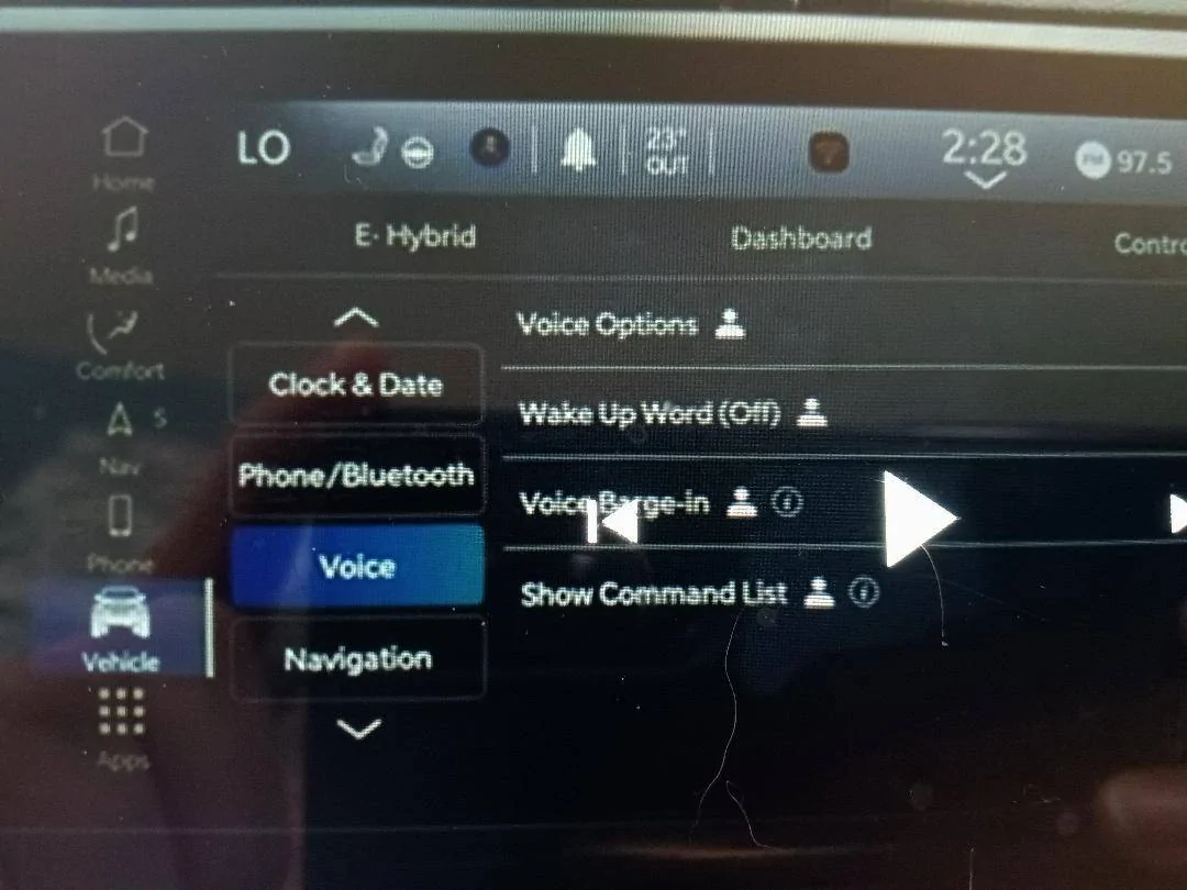

@Luna B does your Voice Control button on the steering wheel work for "Jeep" commands?
Does your settings have the Voice tab as pictured below?
